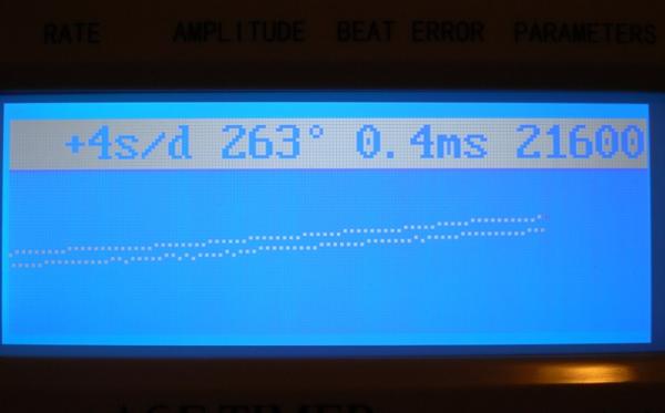

  1. The Priceless Watch Service My Uncle visited my parents today, and brought along a friend from his church. I got a call to come over as Mrs Young's Husband had passed away, and she brought over the watch he was given by TAA (Trans Australian Airlines) for 25yrs service with them. It hadn't run for many many years, and she asked me if I could clean it up, and give it a service. Watch brand is "Unicorn" and has 25Jewel AS 1903 Automatic Movement. I'm not doing a full write-up on this movement, as I only took reference photos, and was concentrating on doing a good job. This watch is priceless to Mrs Young, being a memory of her husband, and believe me, I felt the pressure of getting this one right! Here's the reference pics for your enjoyment :) Timegrapher once complete and adjusted
