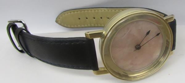

  2. Progress to date on homemade watch parts, The movement is an Avia I bought off ebay for a few pounds. I will buy the glass and strap in the future (hopefully if things get that far).The plan is the rest of the parts will be DIY Case fabricated in 3 parts Raw material for case ).
    1 point
  3. A bit more progress. Just the crown to make, put on some dial markings, and a clean up and tidy. Hands made out of a broken main spring. Hour wheel extended Fourth wheel ground down to remove sub seconds Crown will be made out of an old brass bolt and fitted to an extended stem Dial markings to be added Watch is keeping good time

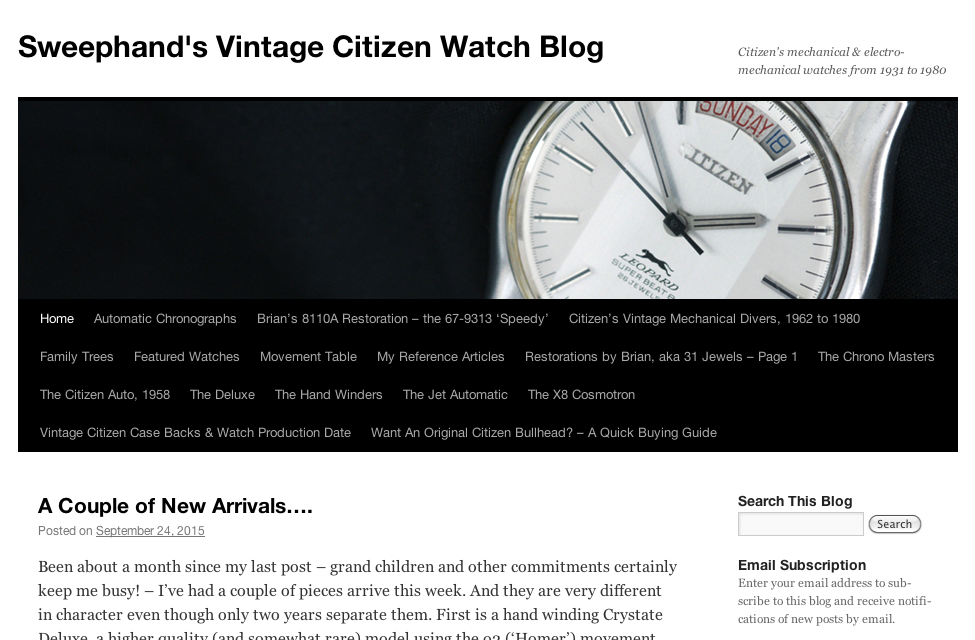

  6. I've been looking around....Ranfft puts the 5420 in the 54xx family [kinda] , and I was looking at Sweephands Citizen movement table from the 30's to the 70's... and saw 5400 movements from the 60's and early 70's listed and related . Also I saw these donors for sale on the Bay...5430 , 5440 , 5450 , and 5470... There were more donors listed but I only attached this example . Sweephand could probably tell you more about interchangeability on this movement family . I wanna see your watch running .
    1 point
  7. What a great post you've presented . It's like watching a soap opera...only better . I have serviced a few Homers and 8200 calibers , but this caliber is new to me . I can suggest that you talk to Sweephand [stephen} as he has the great Vintage Citizen blog . He's a really good guy and the guru of vintage Citizens . He's always my go-to guy for Citizen questions . http://sweep-hand.org/
