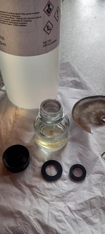

  1. Home made hairspring bottle. 1 small bottle of ink emptied, a cut to size and shaped mesh filter from an old cafetiere and a 3/4 rubber plumbing washer. I may swap out the washer and filter for a 3/4 filter washer if there is enough stretch in the mesh to accommodate a balance cock. And 1 litre of Perc. Total cost inc. the Perc 22 quid the bits were all scrap.
