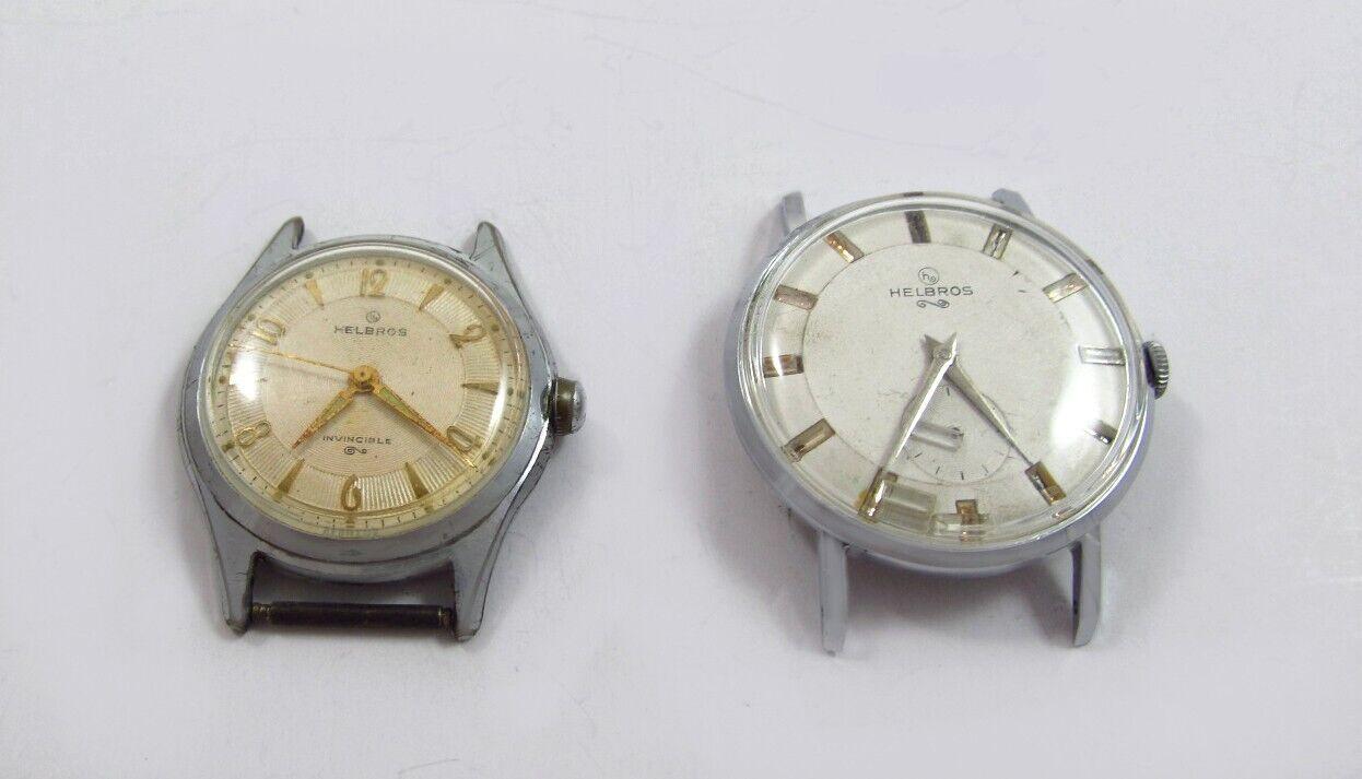

  17. Lots seem to be a mixed bag, I guess. I can get better at troubleshooting and fixing a variety of problems. It gives me some experience with brands that I haven't worked on before. There were rather more problems with these than I expected. There's probably a reason these lots have been sitting around some watchmaker's shop for ages. Not so sure that I can make good wearable watches out of all of them, but I'll give it my best.

  24. I've been slowly working through my queue of watches and was looking for some other watches to add. I won this lot for about $8 per watch. Two Wittnauers, two Benrus, two Helbros, an Elgin, and a Clinton. I was attracted to the lot by the Elgin. Love that case. Some have some obvious problems. I don't know what the movements looks like yet. Hopefully, these will be interesting projects. The last lot that I bought I was able to make some nice wearable watches out of them, so I have hope.
