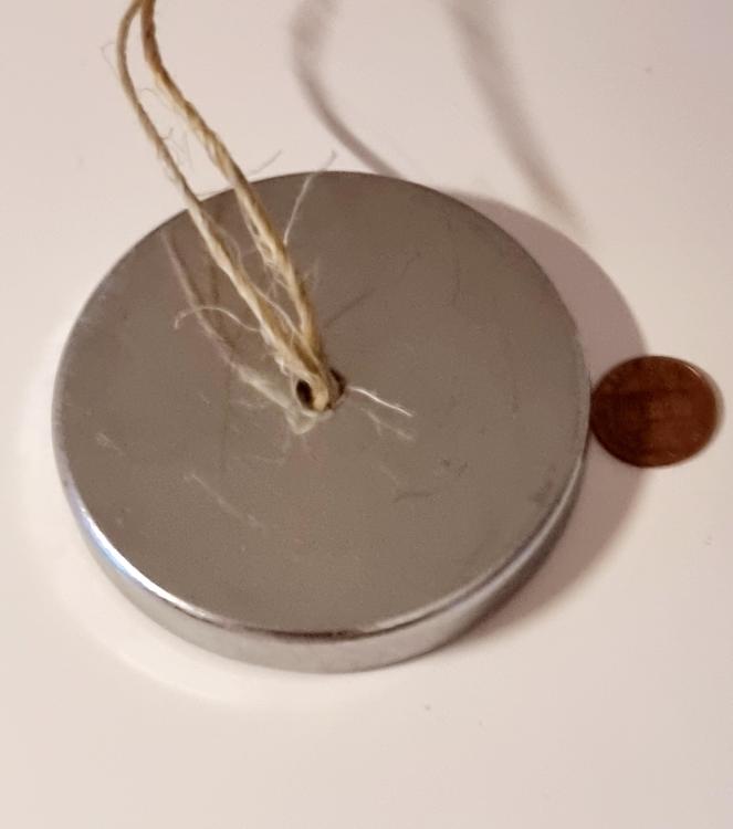

  13. Looks like someone else has covered this, I add a twist. I have my giant magnet on a 30" rope, and hover/swing it all over. Also, I run it over any piles I sweep up and if necessary, the contents of a vac bag. Bonus - it finds the car keys with ease. The have those, we are called females.
