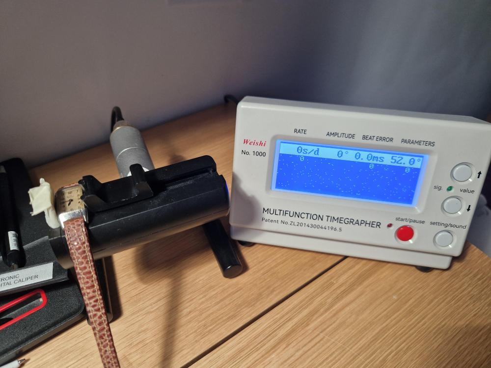

  8. I'm sorry to have kept you in agony for this long which must have given you many sleepless nights, but finally, to my great joy, I have identified and fixed the source of the low amplitude issue, resulting in excellent improvements. Upon close inspection (40X magnification) I found some very slight rust and oxidation on several of the train wheel pivots. Don't know how I missed that when I serviced the movement the first time around (really a bit embarrassing). Perhaps I simply wasn't looking close and/or long enough, and no, the rust didn't get there after the service as I wasn't wearing it due to its poor timekeeping. So, my beloved Steiner Jacot tool to the rescue and what do you know, amplitude in the horizontal positions is now slightly above 300 degrees and around 275 degrees in the vertical positions. I'll never get rid of my Jacot tool for as long as I'm able to breathe and am capable to use it! I haven't had the time to fully assemble the movement yet, but for anyone interested, I get back with the measured amplitude after 24 hours of fully wound.

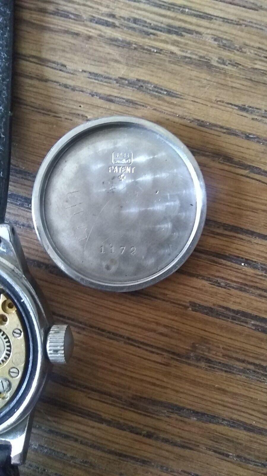

  13. Got yourself a real Frankenstein there, I think that perhaps the dial and the case-back are Seiko and the rest is from something else. It does remind me of an Orient movement (below) with the weird button to set the day, but as @JohnR725 points out the balance protection looks Swiss and not the triangular (ish) shape you tend to get in older Seikos and Orient. Also, I've never come across a click quite that shape/design before, its a mystery! Can always look at as you have a unique one-off watch I'm also curious about the rippling effect circled in red in the middle at the bottom - is this real or just a trick of the camera?

  18. yes that doesn't look quite right at all I circled a few things typically with Seiko they use their own balance protection system and that looks Swiss to me? Not that Seiko and the Japanese the Swiss don't work together for things but that's definitely not quite right + circled the things on the case those don't quite seem right either oh and looking at the picture my bad I forgot the circle something which I didn't notice until now notice your ratchet wheel missing teeth? But never mind it's not the right watch anyway here's a link to what the picture the watch should look like and this one is definitely not it. So looks like someone did a retrofit upgrade and the case isn't writes because as a button pushing something and yes definitely not the right watch it all https://17jewels.info/movements/s/seiko/seiko-6119a/?ref=mizeni

  32. Usually problems with the hairspring result in low amplitude and faster rates. You say that adjusting the regulator doesn't change anything, which leads me to suspect that the hairspring has slipped out of the regulator. Check if this is the reason. And John says, we relish photos.
