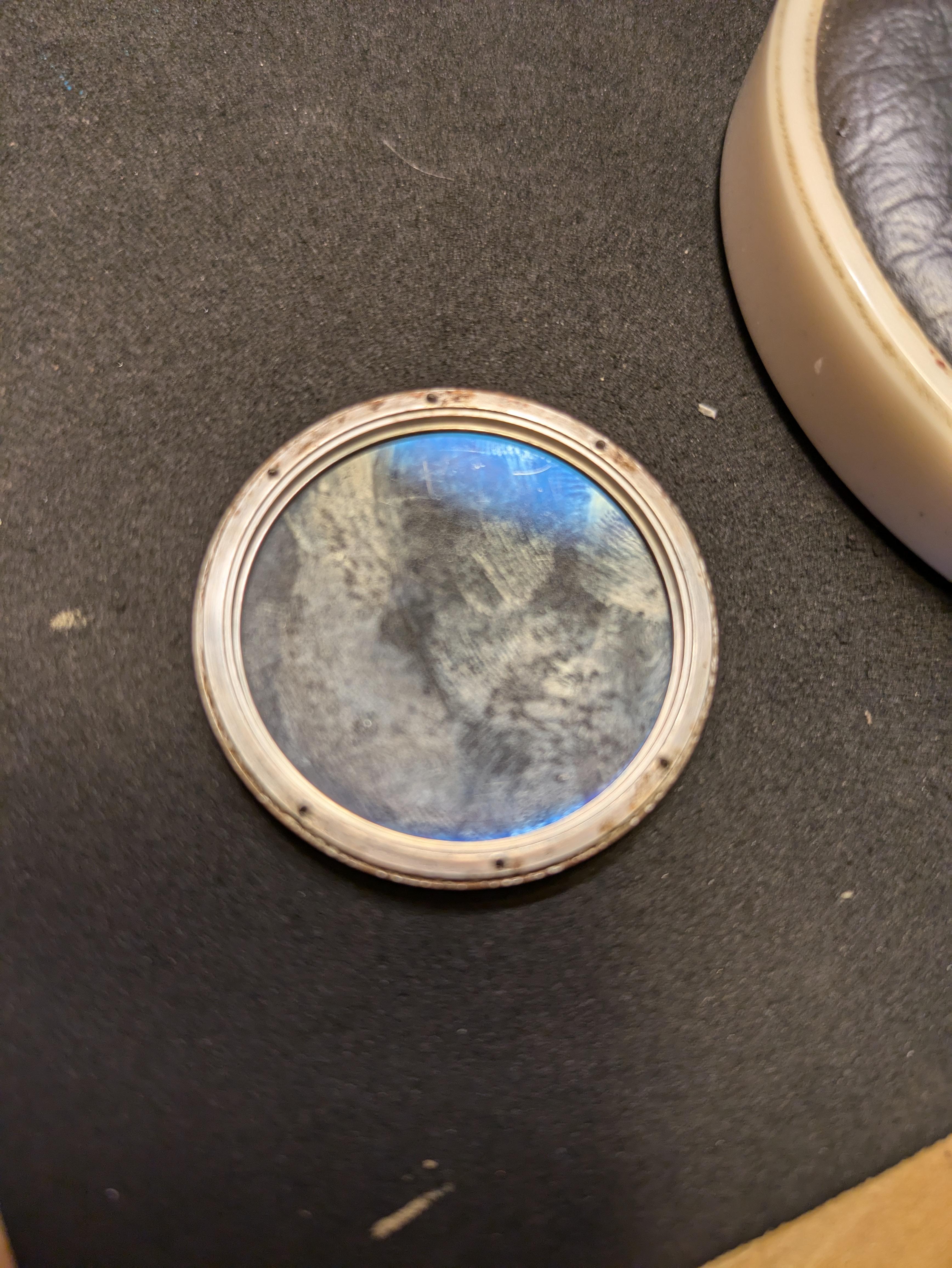

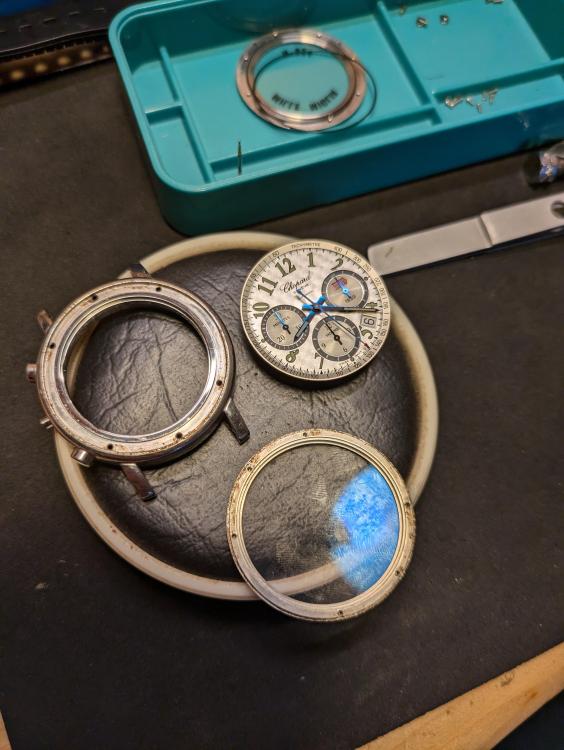

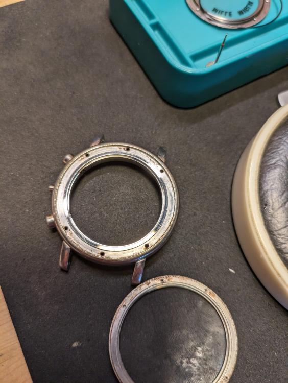

  4. Ok, I can now confirm for sure that the issue was the crystal. More precisely the width of the tension ring. The dial is 31.7mm wide and the internal diameter of the crystal/tension ring is 31.2mm. So dial, movement and movement ring didn't go in fully and the caseback couldn't close fully. I confirmed this by turning around the tension ring (which is triangular in profile). Normally, the flat side of the tension ring faces down and the pointy side upwards. By turning it around, I now have a slightly ugly flat side pointing up and the pointy side downwards so that there's a wider internal diameter for the dial to go in. While I don't intend leaving it like this, I can confirm that the case closes fully. I'll be hunting for other crystals with slightly larger internal diameter. Or, worst case, file away a bit of the tension ring...
    3 points
