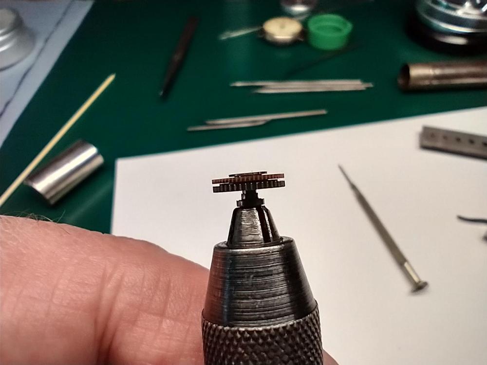

  7. I only do clocks and this is what I use although if it’s a midget torsion clock escape wheel then I use a pin vice after finding centre. Dell

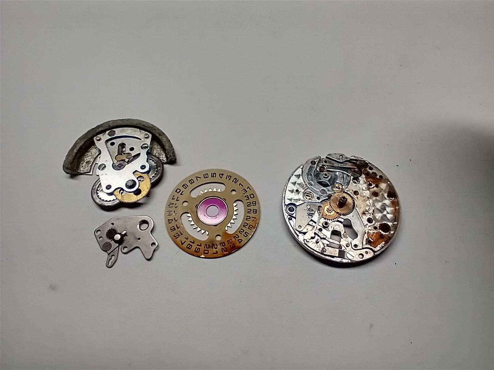

  8. I posted about this guy in the "Which watch have you got coming" thread, but here's the teardown. 27 is a lot of jewels! Cap jewels as far as the eye can see. I also figured out that the black screws are left-hand threaded. Looks like this last wheel is riveted to the plate, so I'm going to clean it in place.

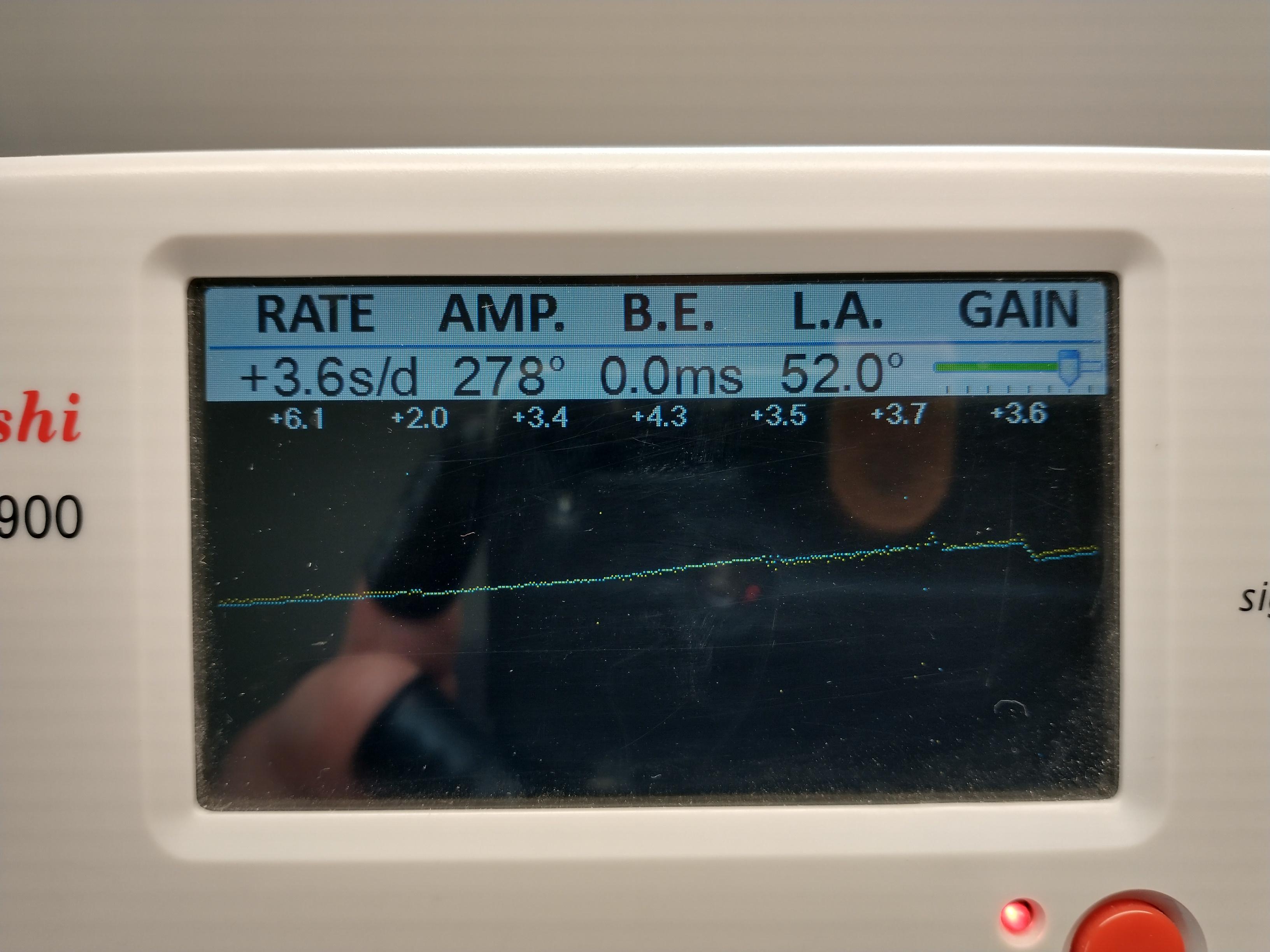

  23. yes exactly. Normally if as a mechanical watch would be looking at the amplitude dial-up and dial down to see if we did see a problem. On electric watch the only way he could do that would be if we were measuring the current consumption words is her additional friction or something. But typically people working on electric watches don't have proper test equipment. Is also a test for dampening of the balance wheel in other words you rotate it release it and it's supposed oscillate a certain amount of time and that should've been done I both dial down and dial up looking for a problem. It may be that the sound were hearing at the very end when it stops may actually be occurring at all the time but when it's moving really freely fast maybe it's not really being heard it's only when it finally slows down. So a classic would be look at the pivots and the jewels see how they look.
