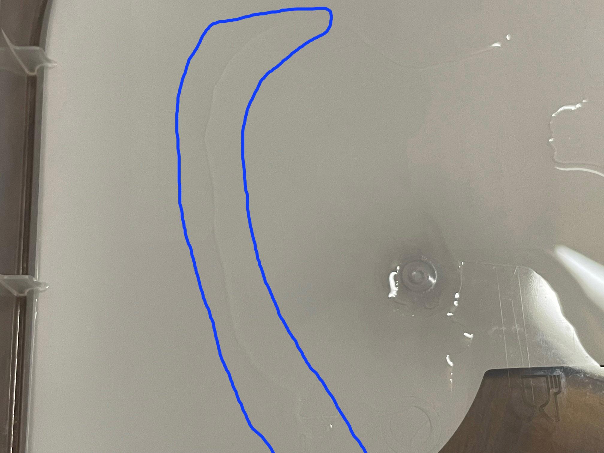

  3. Exact same materials and exact same problems! IPA is not a good degreaser or oil residue remover. Something like paraffin should work better for the initial wash. Also, as I discovered, IPA and lighter fluid are so different they do not even mix well! See the photo - a few drops of each in a flat plastic lid, and after a couple of minutes there is still a clear, sharp line where the two different liquids are in contact but staying separate! Lighter fluid on the left, IPA on the right - and the contact line between them in the marked area:

  16. I was using lighter fluid only, for the main washing part, then using IPA (the 99.7% grade) as a rinse. I believe what was happening was the IPA never really mixed with the lighter fluid that coated the parts, so the crud dissolved in that was left as residue after everything evaporated. And IPA mixes with dried oil & grease about as well as it mixes with lighter fluid. I also know I've not had a single "sluggish movement" problem since switching cleaning solutions.
