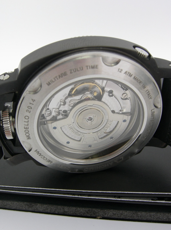

  2. Have got a Anonimo Zulu Time (Soprod C115) for repair. The movement spacer (which is also holding the movement down) is blocked by the 24hour pusher pin (just above 2 O'clock). Its a screw down and I need a tool to first take it out before I can remove the movement holder after which the movement can come out. Need a tool to take out the pusher unit from the case first. Please could I have tool recommendation? First picture (black case): The outer diameter pusher unit (with teeth) is 4.1mm and the space to go in has a diameter of 5.5mm. I do not have a suitable tool of hold the pusher unit to rotate it, so need help. Not sure if this would work https://www.cousinsuk.com/sku/details/pusher-pendant-tube/p1433?skuId=47515 Pictures here are from the web as I closed the case before taking pictures, but can provide own pictures if needed.

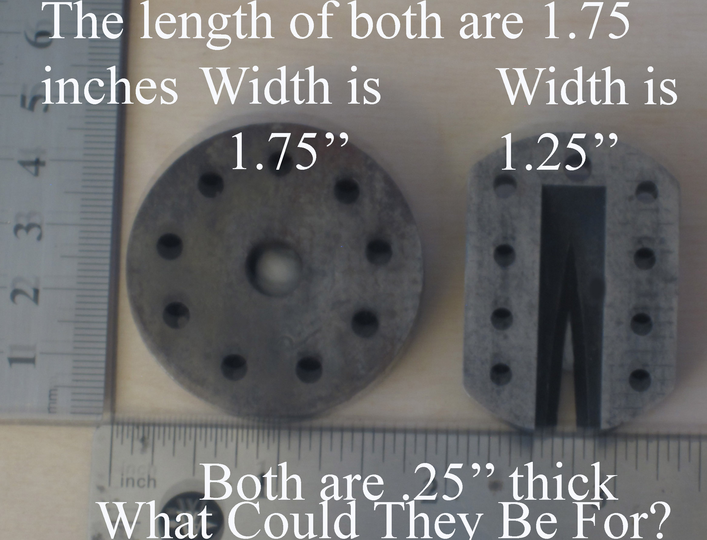

  7. Hello and greetings to all!, I have 2 "tools" perhaps. I don't see a spot for it on my staking tool. Let me back up as well. I have introduced myself on Watch Repair Talk. I said I am a fledgling watch repairer.However, I am more like still in the egg. I have fixed quite a few watches and destroyed even more. Its ok though, I get a box of watches and practice. One time I even got a great deal on a box of watches price wise and it contained 2 working Suunto watches and even a couple of watches that were solid gold. You have to admire and love young adults that sell granddads watches on eBay for pocket money without a clue what they are selling. If people spend a few bucks to have it appraised it would knock their socks off at what the watch is really worth. Sorry I am babbling . If anyone kind enough that knows what these "Tools?" are I would be grateful and possible name my next child after you. The one thing you can not see from the picture is some or most of the hole are tapered. Thank-You Matt H. Clearwater, Florida
