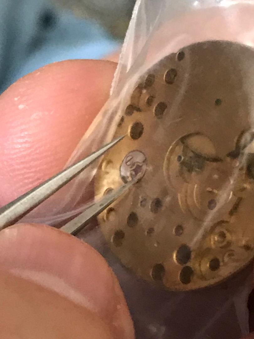

The following aproach to safe cab jewel removal, if not entirely eliminate loss of cab jewels, will greatly reduce such incidents.Suitable for pre-cleaning.
The first picture is just to show angle of attack to unlock ETA cab springs , the actual removal is done inside a bag.
The second picture shows angle to lock the spring.
Third shows you actually put the movement inside a transparent bag.
Stick sharp point into the bag to reach inside.
Remove the cab. The cab is contained in the bag, No where to fly out of the bag, you can then dump the cab in your cleaning solution container.
Looking forward to no longer read someone lost a cab.
I used this technique in replacing the upper balance jewels on a vintage Gruen. While the shock spring was of a different style, called Trishock, doing it under a poly bag is a good suggestion. I didn't place the movement in the bag, but sliced a plastic bag up the sides to make it single layered, and placed it over the top. It worked fine. Thanks for posting your technique. Cheers.
