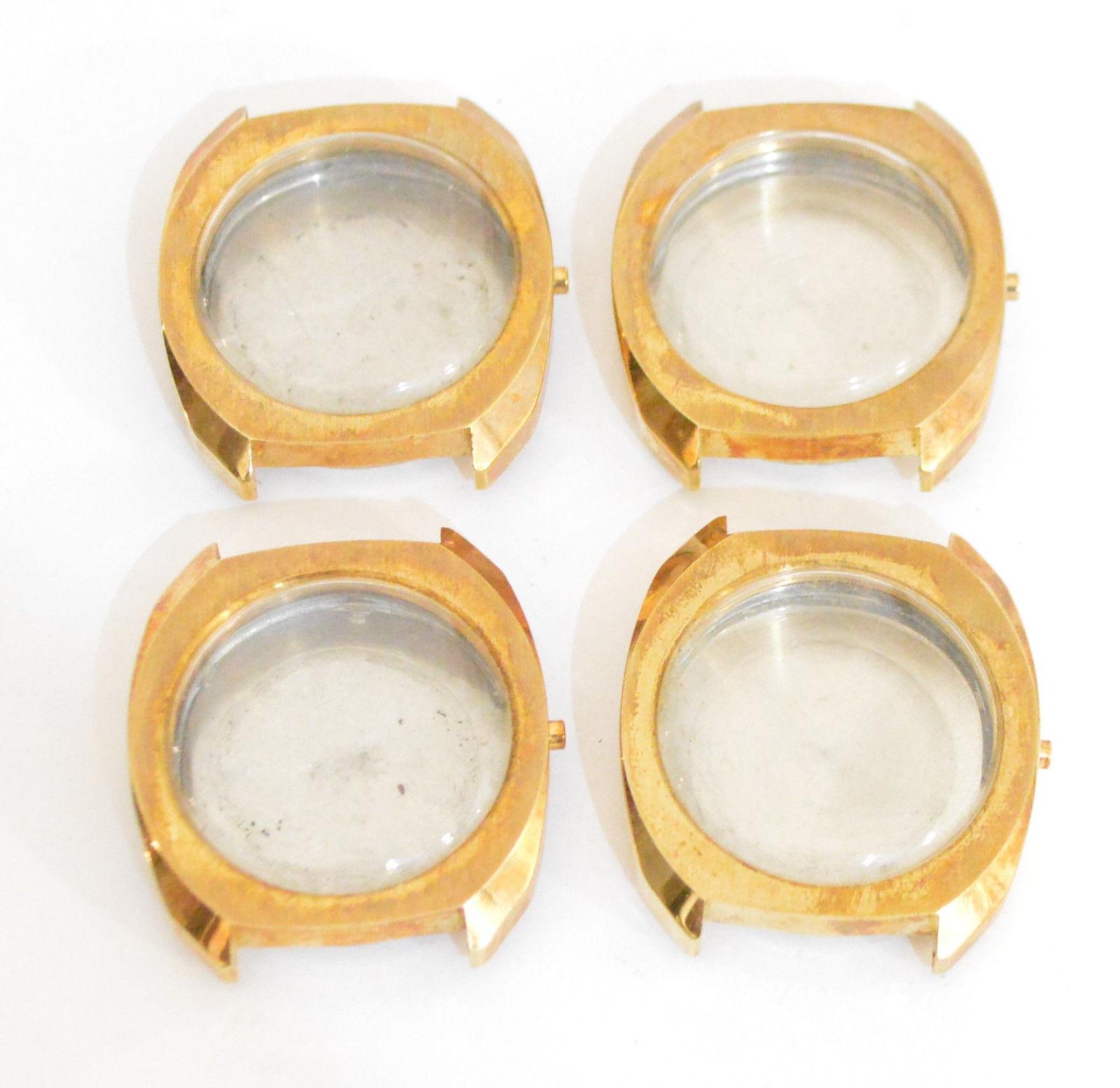

NOS (new old stock) -  4 off 18k Gold plated 10 micron - £2.37 ea. (+P&P) -  Now all I need to do is figure out what I'm going to do with them.
I have lot of ideas, and even a bunch of NOS dials, and a random assortment of hands,  but I'm open to suggestions for movement, dial, hands strap etc.
Maybe I should run a separate dial design thread to see what the combined talents of WRT come up with. However that will be in a few weeks when I get back from my holidays, and hopefully they have been delivered from their random corner of the money sink that is ebay.
I'm also going to do some dial printing experiments, using a technology that is somewhat alien, yet oddly familiar, but I'll leave that idea dangling to see what wild speculation it stimulates.
