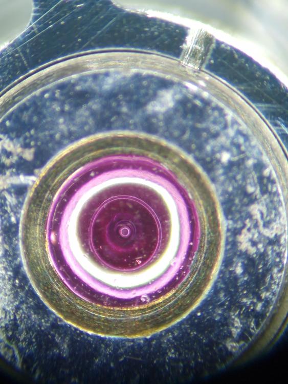

Hi folks , I’m working on the Omega t17 that have a really strange problem, if i wind it to full power it seems to run like crazy with mad reading , but if i wind it ..say 5-7 time it keep the rate better , also the amplitude is almost the same on 5-7 turn and full turn at 290-320
i attaches the photo of the read
I also noted that the beat rate is expanding and close on the reading too, Balance swings is not even ?
thanks for the read and answer!
Broken/worn pivot or jewel on the balance fork?
Broken or worn pivot or missing/poor spring on balance, or damaged balance jewels?
Is it worse in some orientations than others?
I had something similar on a watch recently, and the pivot on the top of the balance staff was worn to a small nub. The moment you moved the watch, it was all over the place, but if you kept it still, dial down, it ran perfectly. I replaced the balance, simply because I already had a donor movement, and it ran perfectly.
Looks like it could be re-banking. Does it sound like a galloping horse when it runs really fast like this?

Checked everything and it looks good and in good shape, could it be the wrong mainspring  size ? I believe t17 can hold up to 3 days power
also if is the pivot , might be super hard to find parts
Sound normal and no knocking sound too !
Well, the rate of oscillation is drastically increased, so if it's not knocking then I would inspect the hairspring for touching anything as it breathes open and closed.
Is it very sudden when the rate increases? If re-banking then it usually suddenly happens at a given maximum angle of rotation which will be in the region of 330 degrees. Is your lift angle set correctly too?
I think you’re right, is a rebanking .
i lubricant the escape wheel and pallet jewel with d5 to slow in down , and with full wind the beat got control, (not that good) but ware able
thanks a million !
That looks pretty good. You escape wheel may be a bit eccentric, or worn, but if it keeps good time, then it keeps good time!
