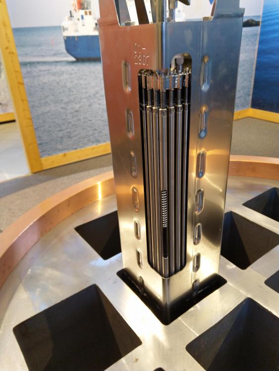

P.S If you see something like in the picture below in your watch then you should be a little more cautious.

All of that shiny stainless would make a fine mantle clock.:D
It actually would... if you got the right height to the ceiling the height of the fuel assembly is 4 m. ;D
