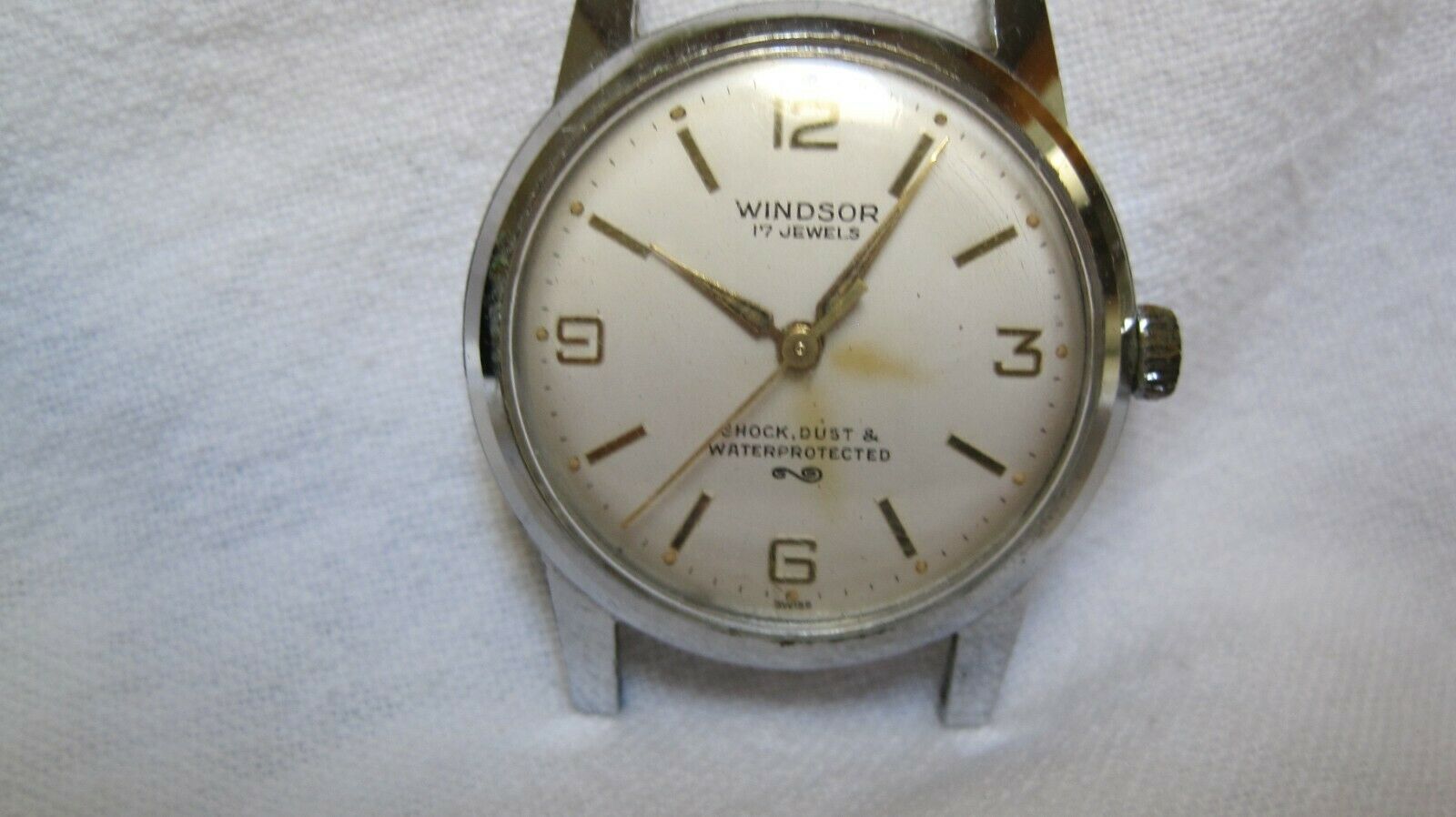

This isn't a question, but a warning.
I recently ordered a broken watch off ebay with the intention of fixing it. The dial was discolored under where the hands had been sitting in a fixed position for a while. I decided this was suspicious and ordered a Geiger counter.  The thing is giving off over 10 microsieverts an hour, which means that someone wearing it would receive a full day's dose of background radiation in only a few minutes.
But the real issue is ingesting or inhaling dust from the lume on the hands should you mess with them.
For everyone messing with vintage watches that have lumed hands or dials, invest in a cheap Geiger counter so you know whether the watch you are going to work on is "hot."
I bought mine from walmart.com for $85 including shipping.

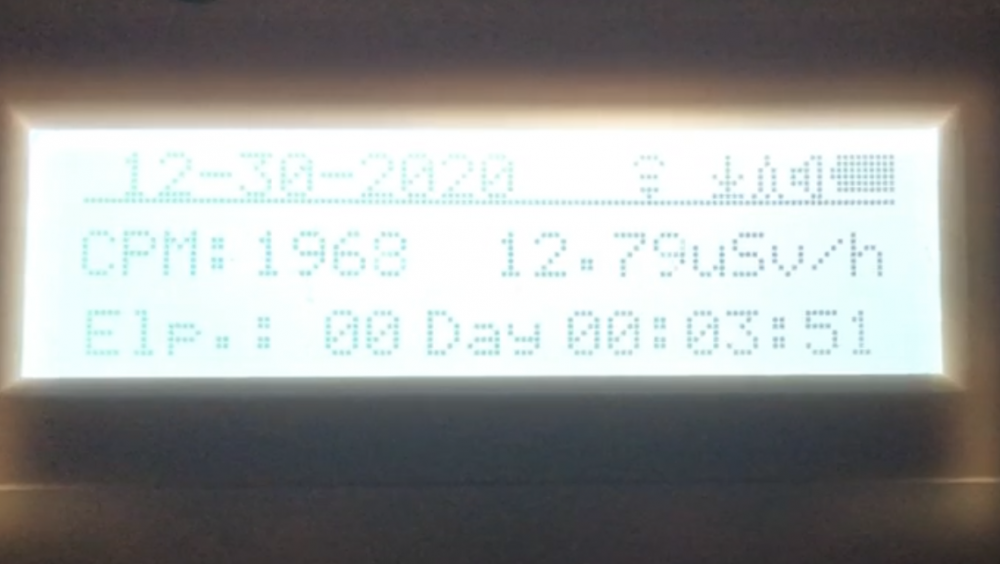

12.79 microsieverts per hour is more than what I was seeing on my watch.  I was only getting around 10.
I hate the fact that so many older watches with lume are radium based, and the people selling them on Ebay have no idea.
I was able to remove virtually all of the radium from the hands on mine, very carefully, by keeping the hands submerged in alcohol and using peg wood to scrape off the lume.  Then I ran the hands through several ultrasonic cleaner cycles.
My watch now reads 0.30 microsieverts an hour, which is roughly double the background radiation in my house
Does your watch have radium in the dial, or just the hands?
If it is just in the hands then you may be able to do the same.
The hands and all the dial markers
I've got two other watches that are like that, a "Louis" and a "Den-Ro"
I was able to remove the radium from the hands, but not the dials.
One now gives readings of ~ 1.5 microsieverts per hour.
The other now gives ~ 0.9 per hour.
I don't remember how "hot" these were before I removed the radium from the hands.
