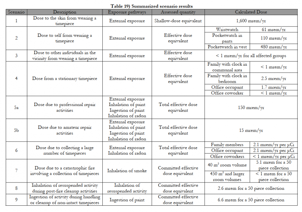

I was pondering this topic again this morning.  Here is another Radiation dose chart that looks like similar data as above but formatted differently.  I am also posting a document produced by the NRC.  A screen capture of the most interesting page that relates to watches and watchmakers is also posted here.
My Dad worked on watches six days a week, 51 weeks a year from 1947 to 1980 (he continued working after 1980 but only a few days per week).  There was radium lume for re-luming hands and dials in his watchbench for that entire time until last year when I removed it.  He lived 92 years.  Cause of death was a combination of blood loss and heart failure. Until the last year, he lived a full and active life.  He was prone to use those nasty chemicals to kill bugs in the yard...that were later banned.
I don't think, anecdotally, that radium had any observable effect on him.
Radium exposure.pdf
