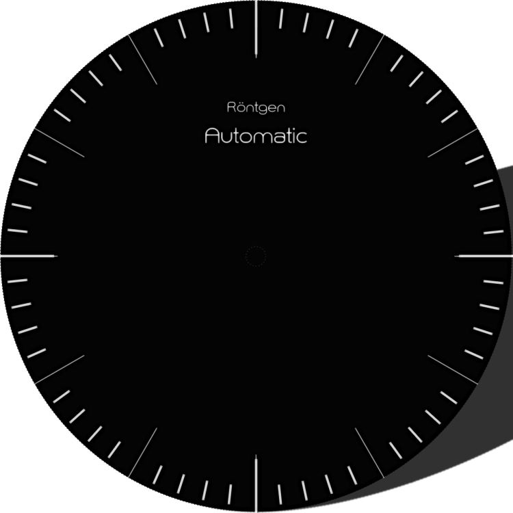

Ive just spent an amusing couple of hours replaying that Inkscape youtube video, and playing with the various options. I've just about got the hang of distributing cloned elements around the center of the object to create various effects.
I must admit it was great fun, and a nice way to while away a little time while a monstrous thunderstorm blew through.
Here is the latest bizarre creation. Maybe I'll have a crack at a Max Bill clone next, or maybe a dial with dials as numerals.
Bauhaus-esque sterile dial version 0.1 The dial objects are currently scaled to a 26mm outside diameter dial (which theoretically would fit a Seagull 2130 and a bunch of others).
You are obviously free to do what you like with them.
Scale them. Shade or colour them. Add your own text and/or logo. Let your imagination run wild.
The top image is a jpg, so probably the worst in terms of scale-ability and resolution.
The third is the .svg from which the others are derived. This last one is a vector format, so in theory, infinitely scalable.
You should also be able to edit the .svc in Inkscape, to un-group and modify the objects, add text objects and so forth, then convert to whatever format is suitable for further processing and printing.
This document is set with the dial center, centered on an A6 page size (to make finding the center of rotation easier when distributing objects around the dial), so you may need to cut and paste from there to a more suitable page size if printing multiple copies, or working with US paper sizes.
Enjoy.

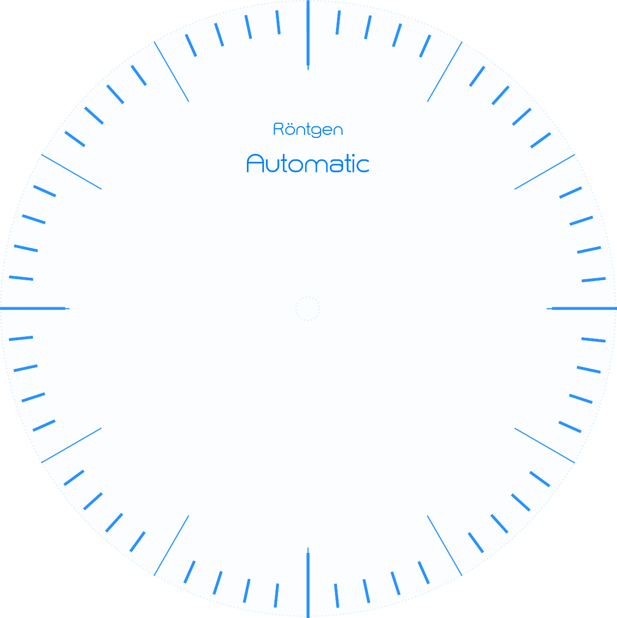

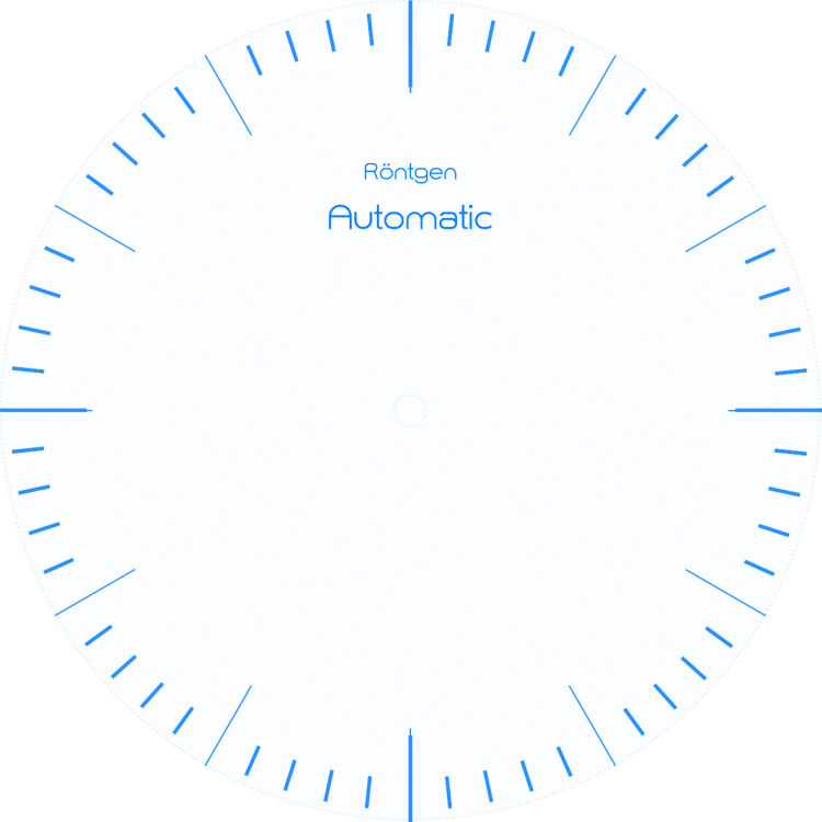

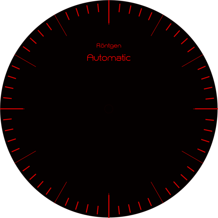

... and a few attempts to emulate CRT phosphor colours with a Röntgen x-ray/Germanic vibe.
26mmDialV2.1-BauhausV0.4-Rontgen_svg.bluegreen4.thumb.png.96cbb5fb0cf49fcc5914dc3c0a13dc6c.png
26mmDialV2.1-BauhausV0.4-Rontgen_svg.whiteblue.thumb.png.89006d4522e56f1a93e3e6c2147c092b.png
26mmDialV2.1-BauhausV0.4-Rontgen_svg.bluered.thumb.png.3ee3585746fc557daa679722bc96fa1b.png26mmDialV2.1-BauhausV0.4-Rontgen_svg.blueOrange.thumb.png.b8a276252f833170d1f86c653599fe69.png
Want your newly invented watch brand to sound German? If in doubt, add an umlaut.:D

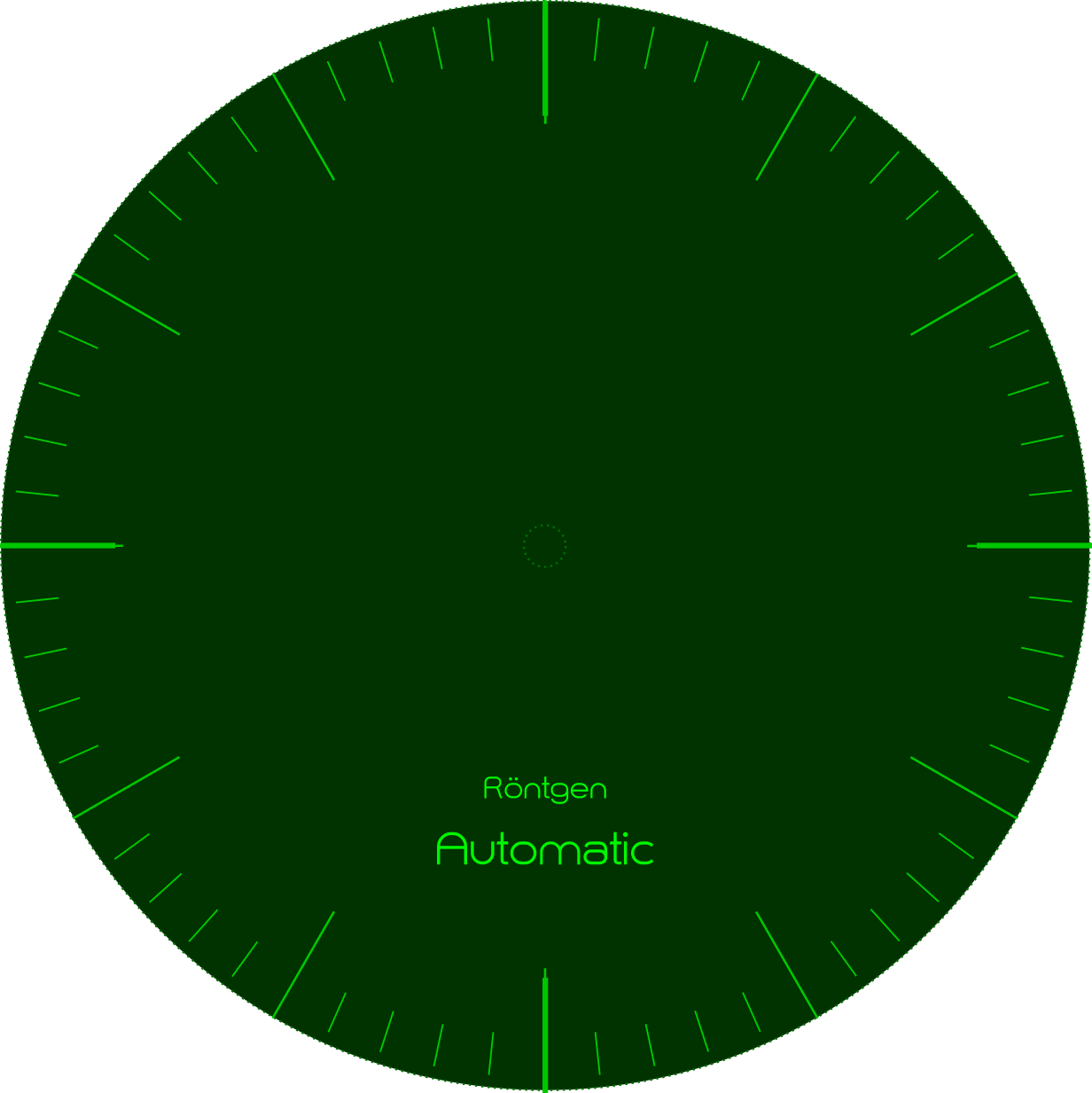

26mmDialV2.1-BauhausV0.5-RontgenLowerTextCRTGreenEnhancedInverted.thumb.png.2f74450d177e17cd2ba24d284c3ad5c8.png
A "blacklight" version.
Not sure what you would do for hands for this. Also I think this and the CRT themed ones would have to be printed with inkjet printer fluorescent inks (yes those are a "thing") for the full glowing/UV effect.

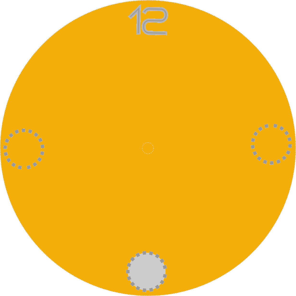

I think I'll move on to something a bit more "classical" next.
Perhaps continuing the Bauhaus theme, or maybe something a bit more 19th Century Pocket Watch.
