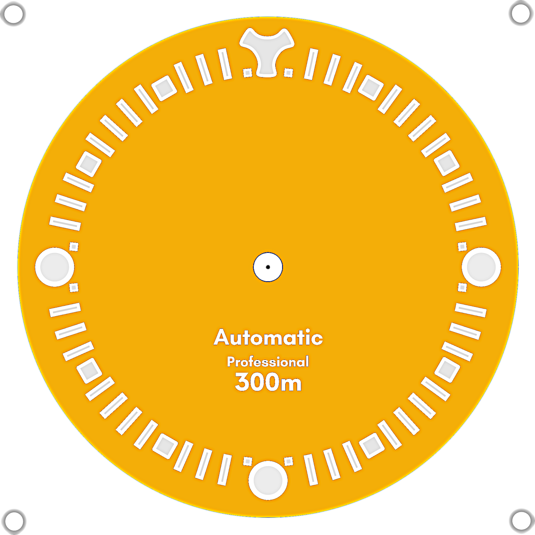

A couple of designs rattled up in Inkscape while I was lazing around in the back garden.
161520346_DiveWatch30.100Centre1.79Round20TangerineLizards_svg.thumb.png.27029655766f540069758e5342a829c3.png
The first is simply a variation on the orange "Dive" watch, but using the Escher lizards to give a little texture

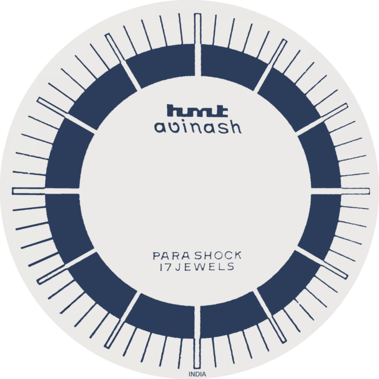

They are welcome to use this 1979 period correct HMT Avinash, which I have just updated to an SVG.
I'm not saying it is the most exciting HMT dial ever produced, but at least it is about 99% authentic, doesn't indulge in the technicolor yawn of colours favored by the boys from the backstreets of Mumbai, (and doesn't claim to be a Fortis :P).
1510170039_HMTAvinash1979-30.100Centre1.79Round20_svg.thumb.png.694aa5a944513644a0f64f93e8a1bbcd.png
The original copyright holder HMT Watch company,  is (sadly) defunct, and since this is a derivative work, I think I can risk licensing it with a CC license.
Attribution-ShareAlike
CC BY-SA
On the plus side, the original design is almost certainly out of copyright anyway and fair use would permit the use of derivative works.
HMTAvinash1979-30.100Centre1.79Round20%.svg
