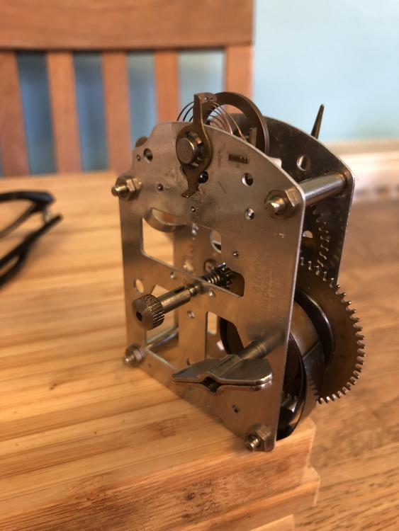

Finally I found something that didn’t work. A cheap Metamec little mantle clock. From the 60/70’s Time only, no alarm and no worries if I mess it up as all three only cost me a tenner.
So a strip down first and as expected it is cheap. Thin metal both on the case and the frame of the mech. Still a lovely little thing when opened but dirty.
Close inspection showed little wear to the pinions but very gummed up.

Full strip down and ultrasonic clean to start with. Then a careful thorough clean and inspection. The pivot connected to the hair spring wasn’t bad at all. The cups that it sits in was gunked up so carefully dug the gunk out cleaned and the pivot ends polished. I haven’t yet got a lathe so hand polishing with emery paper. Nice and bright silver. Fairly snug in the pivot holes but enough space to allow a little movement.
The hair spring gave a little bit of a problem but soon resolved it.
The mainspring was fun. Not as powerful as the Westminster Smith but still enough to give a nasty nip. My spring winder tool wouldn’t fit so I had to get inventive and take things slowly with a pair of pliers. Did it after a while. I’d decided I’d use the spring holder rings which went well.
Same fun and games putting it back together
Arrrggghhhh it’s been running all afternoon so I put it back into the clock. Once back in it’s a sealed unit so you can’t get to the mech to start it moving but a little tip and away it goes.....
for about 5 seconds then it stops grrrr.

Looking at the two photos, you have the main spring on the other side? Also the balance spring needs to be as flat as you can get it, it looks cupped to me, take the taper pin out, the spring should then go back to flat, gently hold the spring and put the taper pin back in, do not allow the spring to be dragged down with the taper pin, when it is flat and the taper pin is in just a gentile tap the pin to hold it in place is enough tension.

Well spotted but would that make a difference once in the clock? The frame is designed to have a second spring and beforehand it ran for hours.
I’ll revisit the balance spring.

Maybe the movement is being flexed when you attach it to the case lossen off the screws 1/4 of a turn and see what happens.
I’ll give it a try. I’m loving the challenge but heck is it frustrating especially when I have to involve normal everyday life :)
