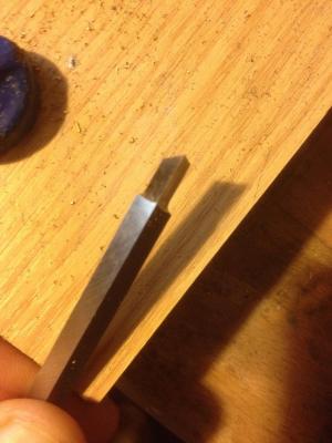

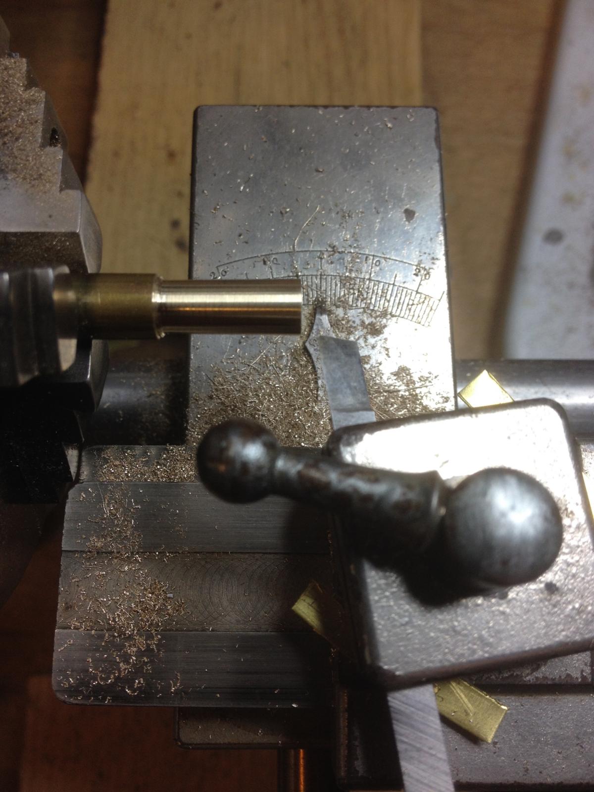

The one thing that has hooked me onto Horology is that it is never ending learning curve whether a collector or repairer. I purchased Star lathe a couple of years ago and after many trials and tribulations have become quite competent at turning & polishing. It also came with a cross slide but I could never get it to cut as it should and also the post does not have an easy adjustable height so catching centre is a matter of packing the cutting tool. As consequence I always use the tip over rest and a graver. But when cutting down stock the slide rest is the way to go so after watching the vid below I decided to make a cutting tool.
When I did the first couple of cuts with the new tool I was really pleased but then I started to get a really poor cut. On inspection with a loupe found that the tip of the tool had broken. I then reground and the same happened again. Then after some research many engineers recommend that never quench HSS steel when grinding as it can create macro fractures. So on the third attempt I re-ground without the quenching and low & behold the tool has stayed sharp and cuts with a really nice finish. Attached some pics hopefully shows this and one of my set up.

Great tip :)
I use a diamond wheel for my graver sharpening which tends not to heat up the end of the graver and gives good results.
