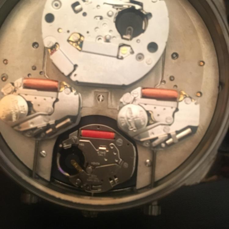

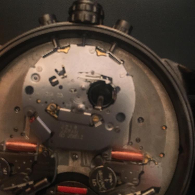

The title is self explanatory. DZ7314 runs on 4x 377 batteries. I'm trying to replace them. Two were easy but I am having difficulty with the other two.

how about a photo of the battery area.
Thanks for your response. The empty battery holders are those I’m having difficulty to install the batteries.

A big thanks for the video. It looks very much the same as mine. However I cannot get the result he's getting. :)
The battery for the chronometer watch(closer to the front of my hand once I wear it), he manages to fit it in by pushing/sliding the battery in. In my case, the batter sticks out from the holder from the side closer to the centre of the watch. There is a little bar passing over the edge closer to the side of the watch, once I slide in the battery underneath of that bar, the edge closer to the centre of the edge, has no holder or fit which keeps it in place.
For the other batter (for the watch closer to my elbow), there is a screw he's loosening then tightens once battery is in place. In my case, the battery doesn't seem to be fully fit in place. So tightening of that screw doesn't help.

Hi Texas Don     what make and calibre are the four modules  , make and number, The two that look alike look like miyota 2030/35 modules  the bottom one a ronda ? anfd the larger top one I cant decipher. It mayb that not all the batteries are the same in all modules causing the problem..the miyota ones are i think 377s but the others untill we know the make and calibre are unknown .  Miyota tech sheets attached      Battery SR626SW   cheers
