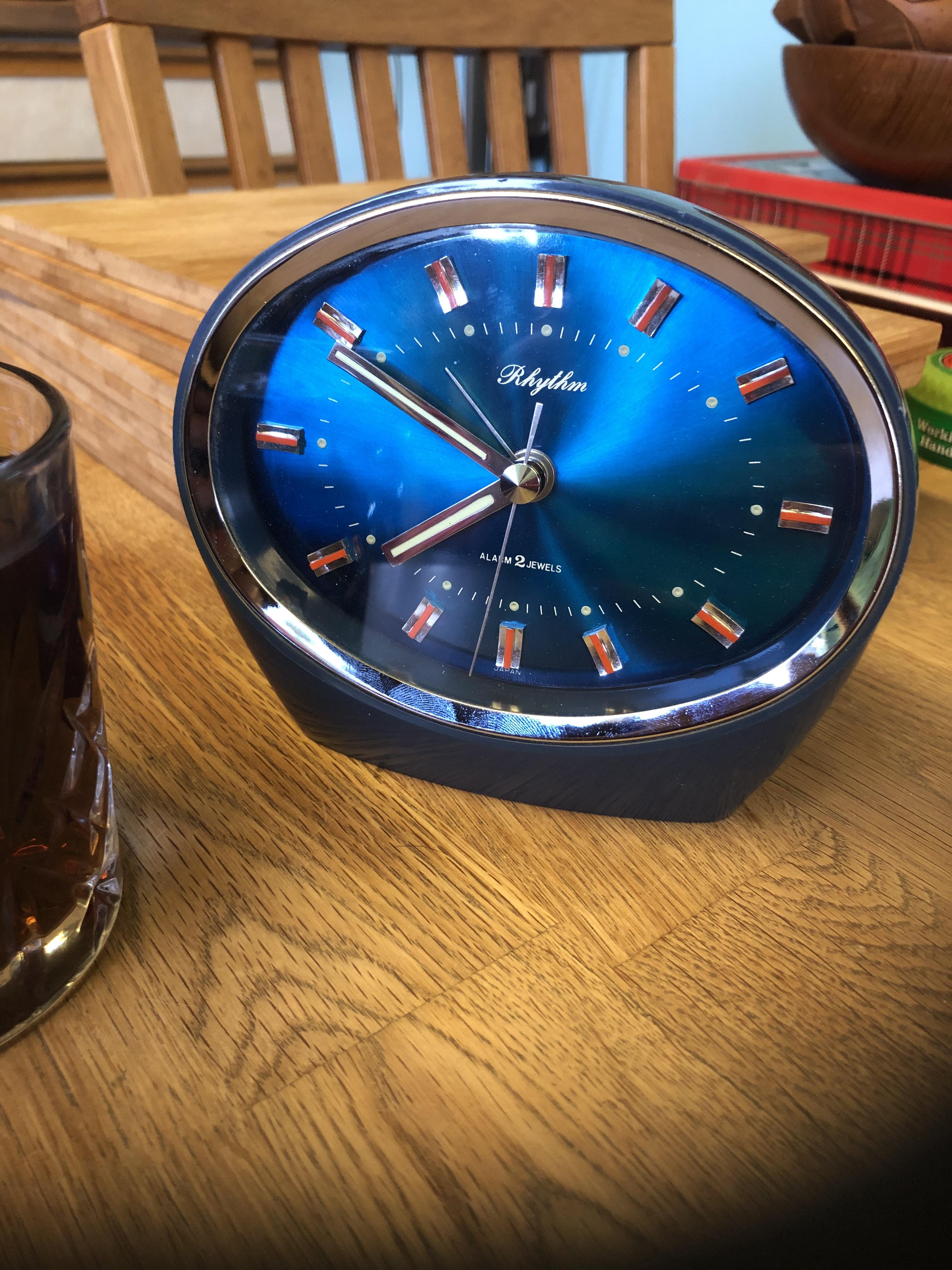

I’m on my local sellers group and always keep an eye on things that come up cheap. This weekend I collected from a house clearance three non-working clocks. Two are mechanical one a quartz.
i started on this one first and after taking the case apart giving that a good clean, resetting the hands which were loose and cleaning up the battery contacts it’s like a good-un
The other two are 8 day Schatz. Both have problems and missing parts. Hands and domes need ordering and both need a good clean.one is a 59 movement with a dodgy hairspring the other is a pendulum based movement. Both are lovely looking pieces. All for £25 so not bad
The Steiger is a heavy lump made out of solid brass plates. Keeping good time and silent so keeps the wife happy.
