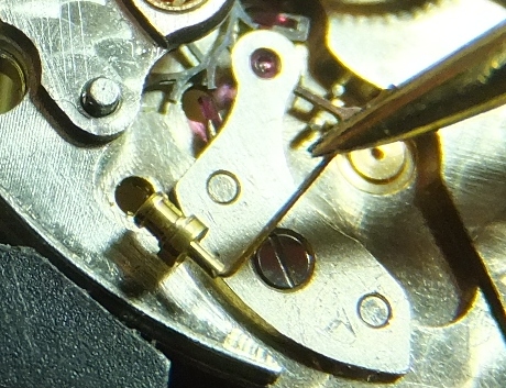

All stripped down and a couple of points that need addressing...................
  1. The mainspring looks as though it has received a full oil change of castrol GTX. The spring looks in good condition, so is this OK to re-use? Dom says to replace, but in Marks video on the 3135, he re-uses the spring.
  2. The hairspring guard appeared to be fouling right through the mainspring. I think it may be a good assumption this is thr cause of the 20 mins/hr gain.
  3. I have read that on these calibres, the guard is sometimes removed completely. Any ideas on this anyone?

The guard looks ok in the pic, but where it goes under the regulator it was through the centre of the spring.

Hairspring guards are designed to prevent the coils of the hairspring from jumping over another coil in the hairspring.  When this happens the movement will start to run at a much faster rate often gaining several hours per day.
Pics as promised..................
You can see on the above photo the hairspring guard is fouling the hairspring.
The photo below shows the hairspring removed and the coils returning (thankfully), to their original state.
Excellent photos Legarm. Having found the issue with the guard, it looks like all you need to do is give it a good service and a polish and it will be a cracking watch.
Have you any idea what would have caused the guard problem, has the watch been dropped or mechanically abused by someone with little knowledge?
Thanks Geo,
I do think the latter is the main reason.
  • It looks like someone serviced in the past with a claw hammer….. also some of the plates inside have scratch marks where the screwdriver has slipped.
