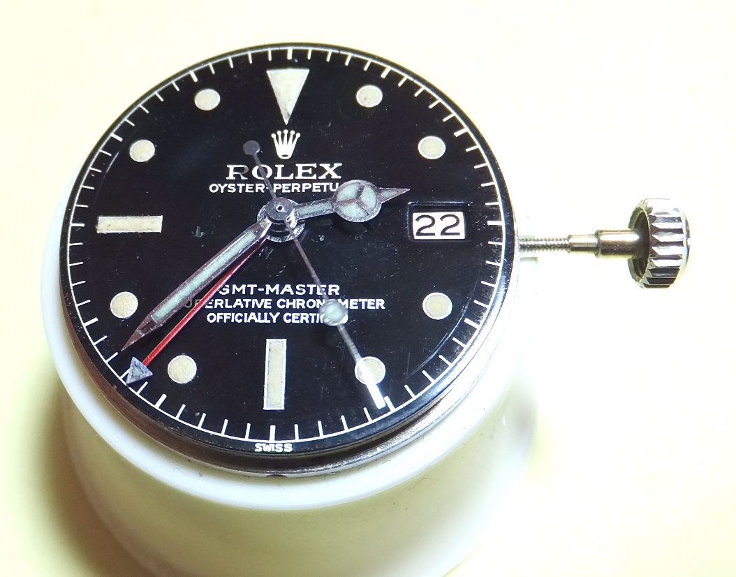

Update. All put back together bar the case.
On test at moment and has not lost a second in the hour since putting hands back on.
A few pics as I went along to see the balance guard in place and not now fouling the hairspring. If you ever work on one of these the Balance guard has a screwdriver slot to swing it away from the hairspring. I had to remove it to release the hairspring.
This seems to have been the culprit for the massive gain in time.
I shall hopefully re-case the movement tomorrow.
It' a bit of a shame that whoever serviced this previously did not take more care of the face and hands as they carry quite a few knocks & dings.

Nice job, Keith (Legarm). Looking good and amazingly clean!...and the hands are not too bad.  If you are not happy with them you can always refinish/relume 'em. I don't think it should disrupt the over all looks of the watch by doing it. I usually, if painting is also needed, use Testors paint. The lume I get from ofrei which is, according to other people, the best so far. All that said, I don't know if I want to do that to this nice Rolex though. Love to see the cased movement!

Hope to re-case it tomorrow. Have got a bit of work to do on the bracelet as it has had the wrong diameter spring bars fitted in the past and the end pieces have become distorted.

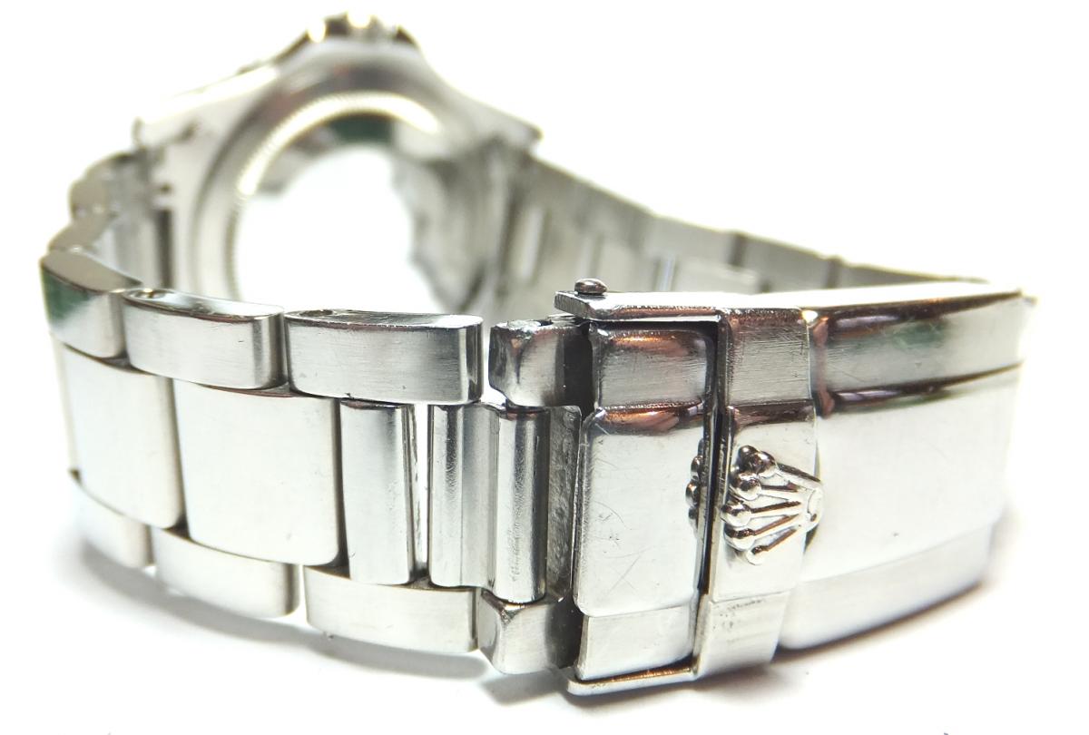

Well, here it is, finished. Bracelet fixed and no longer flapping about at the lugs.
I don't know if any one knows a fix for the Bezel as it is nigh on impossible to turn. I have installed it with the plate that was on there originally as it looked new. Take the plate away and it's too loose.
Anyway pics as promised.
From gaining 8 hrs a day , I'v got it to 10secs which will do for me. Mind you this is nearly 50 years old so it's not too bad.

Problem is the bracelet is wrong for this model, should be on a rivet or jubilee. None the less, a cracking watch and a cracking job you've done on it.
