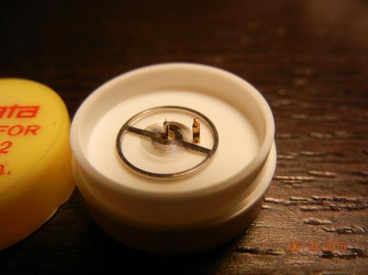

Hello tallsaul,
The complete balance/ hairprings I have in hand I did get them from CousinUK The order number should be BFG 1582793. I have two in my personal inventory. They should look like this.
The reason for the longer stud as you may already know is for the clearance. Check Cousins again and if you have no luck, PM me.
JC
Hi,
With the help of your photos the picture is absolutely clear now.
I guess we went through the same path.  The movement I am working on shows: 158 31/7 and based on that I ordered the wrong balance.
With your photos I am now confident to order the 1582793.

My pleasure TallSaul. Yes the actual movement is indeed stamped 158 31/7, but there are also some stamped simply  with "158"....the difference (I think) is mostly in the 17 jeweled version vs. the one jewel basic movement. The one you have is obviously the 17 jewel version which Sicura used for their day/date Cordura divers watch, so these hairsprings will work. If you need any help or info, let me know and I'll be glad to help you out. Looking forward to see the pictures!
