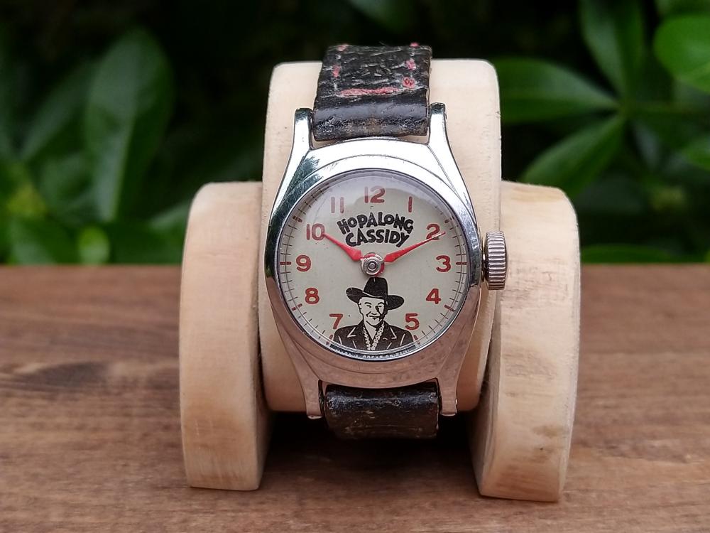

I have recently restored a few of these Hopalong Cassidy watches. This one came from someone who bought it as a boy at the end of the 50s for Christmas. I am jealous! 🙂
Edited by luiazazrambo
I cant say I had no difficulties. I was ready with the one you can see on the pics once then i was checking its performance on the timing machine it looked brilliant so i tried to regulate it while i was working from home. Just a light touch with my tweezers reaching it over my computer.... my tweezers slipped and i literally destroyed the HS. I was so sick I could not revisit it for about two days. I sourced another HS and as far as I remember I also ruined the pin pallet while I tried to clean it so I had to source that too. (the pins were stuck in rodico and the rodico pulled one of them out when I tried to lift the fork up, i put the pin back but it was not tight enough anymore) You can buy ladies watches with M21 on eBay for about £2-£4 as a donor movement. I have serviced another M21 since this one and another two M22s are on my desk. Just like with anything else everything gets easier/quicker to handle if you practice it. Originally I could not even imagine how to put the main plate back and now I don't even consider it as a difficult task, it usually goes back all right for the first try.

If you need advice or parts let me know I am going to try to help you the best I can. Take care.
