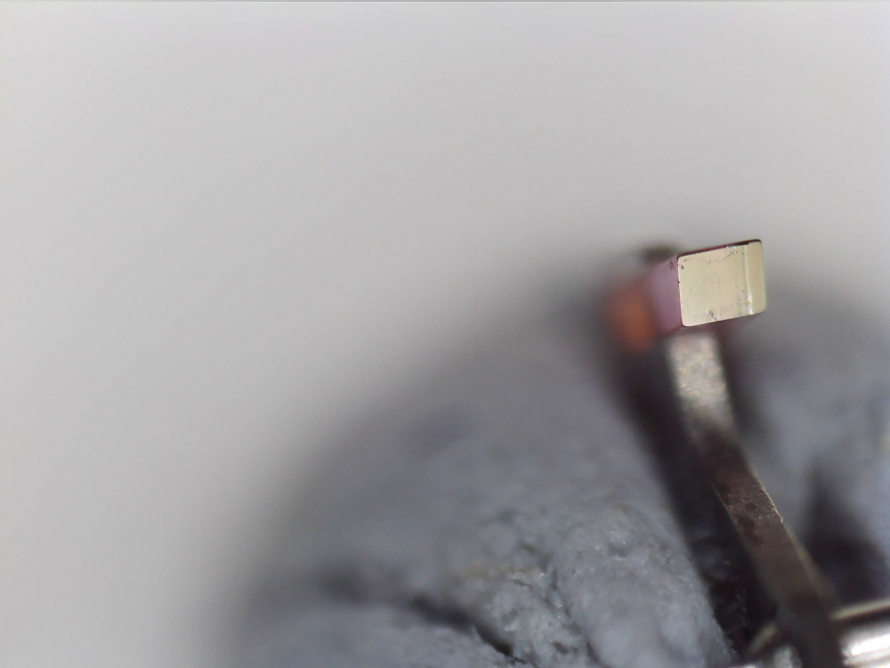

Hi folks. Ive got an Omega that's showing occasional beat errors in certain positions and only on one side. It's very intermittent and I can't work out what's causing it. Because it's just on one half of the reading (lower) it made me think one of the pallet stones could be damaged or dirty. I just put them both under the microscope to see how they're looking. Is this a normal amount of wear for a 50 year old watch?

the visible wear is more than normal (should be zero).
But much more likely is a very weak release noise on one side,  that is missed by your timing machine: it triggers on the next, higher impulse.
Frank
Thanks Praezis. Do you think I should replace the fork?
Can you tell me more about the weak release noise? I've not come across this before. Does this mean I need to increase the sensitivity of the machine?
Those are great photos, thanks for posting them as I would of also wondered if that wear is acceptable or not
The photos show some wear but after 50 yrs, fair do's. Polishing the wear out is fraught with danger the only safe way is to replace the fork then re check on the timegrapgher and compare the before and after. all the best
Thanks. I think I might just replace the pallets. I think this is the result of decades without a service and no lubrication on the stones!

     it looks like wear,  can you measure it?

Hi,
you can replace the fork, but it is no must imho. There is a good chance then that you have to adjust the pallets, too.
What I wanted to say, you probably have a measuring issue, no mechanical issue - my experience with developing timing machine software.
In short: a tic noise consists of 3-4 single noises, the first being the weakest, but used for timing. More on tic noise you will find in the software TM threads on this forum.
Frank
If the pallet stones are worn then the escape wheel is probably worn as well, changing one without the other doesn't make much sense.
Have you fitted a new mainspring? If not that is what I would replace first.

Yes, yes yes, The cause in faulty escapewhell teeth, no oil will remedy.
When it comes to the pallets, the only part that should be oiled are the pallet stone faces. Never oil the pivots of the pallets as it will cause drag and the movement will fail to keep time. You must use the correct oil for the escapement, if you are not sure which; look for one that specifically says for watch escapements. Some watchmakers prefer to oil the teeth of the escape wheel and let the combined action of pallets and escape wheel to distribute the oil. Pallet stones should be smooth on their face, any marks, chips and they should be re-placed. The stone is harder than the escape wheel so it is most likely it also is worn.

Yes, this occurred to me. The stone is much harder than the escape wheel so it would make sense that it is even more worm. I've ordered both. Yes, the mainspring has been changed as well :)
