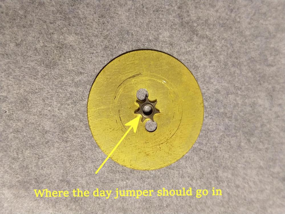

I am now working on a SU movement, Slava 2427. It is a manual-wind movement with day-date complication
I am trying to assemble the watch back together after service but I am stuck on the day disc.
The day disc is fitted OK in my view, teeth underneath the disc interacts with the click and the disc advances naturally as other motion works move clockwise.
However, the problem is that the days written on the disc are not in the right position and do not fit inside the day window of the dial.
What could I have done wrong??
Thank you!
If the right disc, check if the gear attached to the back of the disc has loosened/ got out of position.
Turn the disc manually, observe if it stops in the right position. If so the fault is with the jumper.

Hi I have put a video on YouTube for the 2428 movement have a look at that to see if it helps just search Kaz smiths or Slava 2428 my profile pic is a chronograph movement,it’s a bit long but it is fully disassembled and assembled hope it helps.
There is not that many things that could go wrong .
I happen to have a movement lying in the scrap bin I could guide you through the process in a few simple steps.
The first thing is to see the date ring is aligned so it will not push upwards.
Next inspect the day ring so ii's flat and nice.. as you can see the day click wheel is riveted on and needs to be firmly in place too.
When it is put in place gently rotate it clockwise with a slight push, I use two finger for this but in the picture you just see one.
Sometimes you just can push the day jumper into place with a needle throught the inspection holes.
Finaly check the day lever is in place and thats it...
The design is making it impossible to get into wrong position if everything is ok.

Well thank you all for advice!!
I managed to turn the gear to put it back to correct position and
the disc now shows the day correctly. Thank you for your help!
