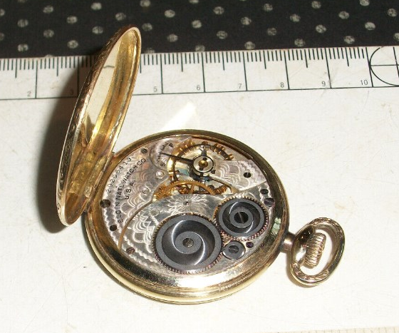

In my case, I wanted to give the components an attractive look, considering that was how they started out when the watch was not "rusty".  Here's a photo of a similar watch with a Winding Work in better shape - probably very close to what it looked like when it left the factory:
This type of patterning on the Winding Work wheels is typically accomplished using a combination of industrial techniques and various approaches to and types of abrasives, which I am exploring elsewhere:
