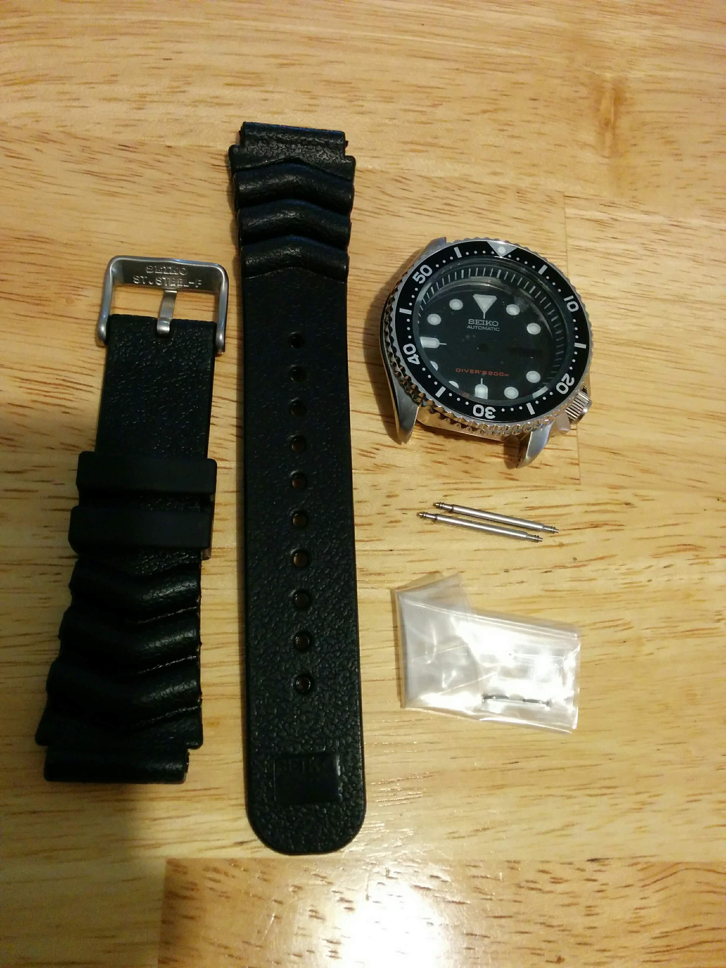

I'm a big fan of Seiko dive watches, I have a SSC017 and recently bought this case off ebay. I've checked out a few vids on youtube about modding this watch and being a newb, wanted some input on the movement type to put into it. I've heard some people say NH35/36 and wanted to know if I bought this mvmt new if it would have the mvmt spacer and come complete with day/date rings or for that matter if any other mvmts would fit.  Thanks for any and all info.
The original movement is the 7s26 which can be found some places online, but is not that easily available. NH36, which is day-date (NH35 is date only), is available from CousinsUK or for a similar price on Ebay/AliExpress. You have to switch out the day wheel to one that is for a 4 o'clock movement, as 99% of the NH36 movements you find online come with a 3 o'clock day wheel. The supplied grey spacer ring which is already mounted on the movement does fit in most cases, but there's a tiny chance that it'll be a bit too snug as it's a bit bigger in diameter than the black spacer, which is found on the 7s26.
So, NH36 is a day/date movement that you can use, but you have to get some 4 o'clock day wheels.

good info, thanks for the correction! I just saw the technical guide that I found on NH25 VS 35 and saw a .1mm difference in casing diameter while the height was identical. Do you know how much the difference in height is, between the diver/non-diver?
And yes, I forgot the crown and stem... The SARB059 crown is commonly used, but usually more expensive and harder to find than aftermarket options. That one works without any modifications on the SKX. Crystaltimes, DLW Watches, Watch&Style, SeikoCrown and probably some more supply aftermarket crowns which will fit the stem that is supplied with the NH36 movement. It's possible to use the stem that's threaded on the plastic crown without trimming it, as that one already has the right length that is required for the SKX. I've personally chosen the pre-cut stem/crown combo from Crystaltimes, when I've swapped to the NH36.
