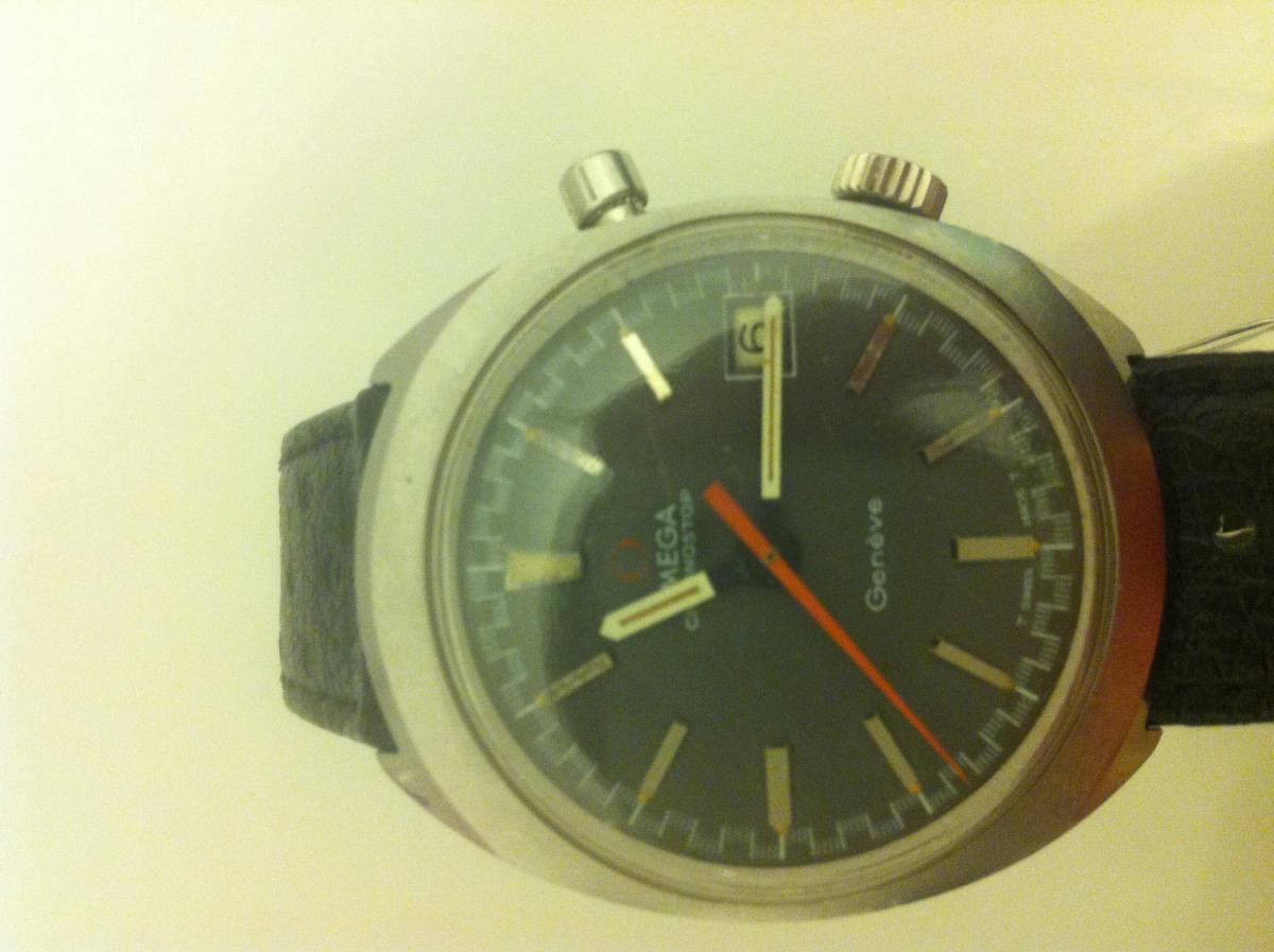

Geo's advice is good. A cotton wool bud - dampened with spit or a mild washing-up liquid solution - is a good tool for general dial cleaning. But it's very easy to dislodge markers when cleaning so I would be very tentative at first. Once again, a pic of the face would be of help in getting advice from forum folks. :)

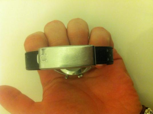

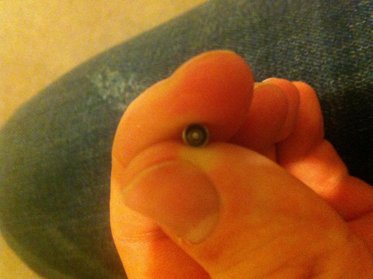

theres the pictures of the watch for you guys to cast your eye over. dont believe it just after i took the photo's the pushers came off :( reveiling the splined shaft (still attatched to the watch) and now i'm sitting with a small spring and the head of the pusher!! is there a way it goes back on or is it a case of a new pusher? not sure if there readily avalable? if so how will i fit it? feel like its one thing after the other.
- Ben
Nice watch Ben.
Don't panic about the pusher. Open the back of the watch carefully and you will find the small screw that holds it in place, it will probably still be in the pusher tube. You will definitely have to remove the movement to screw it back into the pusher.
thanks! buy the looks of it think the screws shered off looks like theres some of it stuck in the pusher :( .. will take some pictures when i get back home had to quickly pop out. if that is the case will i be able to sorce a new screw? regards ben

thanks geo..  you certainly know your stuff!! will the rest of the pusher survive that process as they both use crowns in that thread? I really hope so.. yeah hopefully they can will any old screw do that's same length? how will I actually find out the screw length? Really glad I stumbled across you guys on here so much help.
Regards Ben
Regarding your last question, the pusher is made of stainless steel and the alum will discolour it but will not dissolve it. If the screw is stainless steel this process will not work.
