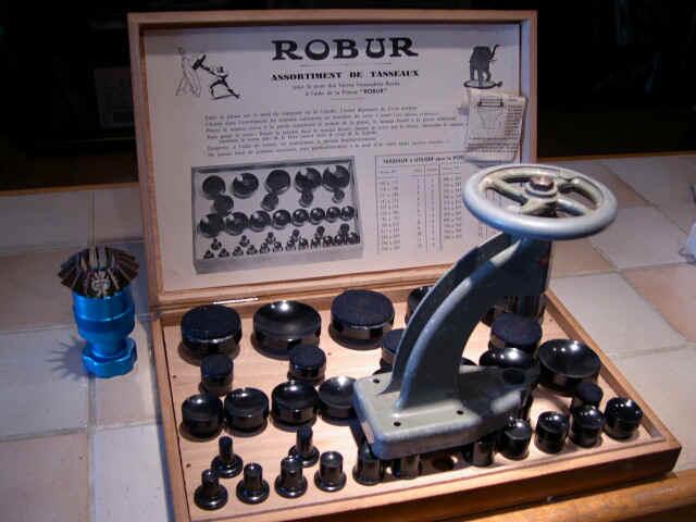

My experience with the handheld cheap Chinese glass presses on eBay is truly poor, and I've come to learn that I'm not alone. Yesterday I was struggling with it for over 30 minutes to fit an armoured glass in a Vostok Amphibian before giving up. At that point, while still holding it in my hand looking at it with disdain, I thought: "What a piece of utter rubbish!".
Anyway, what I'd really want would be a Robus press, but gosh, that would be over £500 with the die set (tax included, excluding shipping)! So, I found this tool "Professional spindle press for housings and glasses with twenty-four inserts" on eBay for £72. It sure sounds promising, but it would be great with a review, or if none can be had your opinion.

Have a Sternkreuz press i use for most glasses. Love it. I bought a second one on tradera some month ago for spares.  Also have an other which looks like a Robur but not 100% sure it's a Robur. Was thinking i could make an adapter  so i could use some other dies as the Robur ones cost a lot of money. Maybe i can part with that as i have to many presses anyway.
You really cannot skimp on a watch fitting glass tool. You need to have one that you can trust and get the repair done without worrying about is it going to work. The cheap tools will not do a good job, they do not fit properly, and they break, not lined up and will not last long. Buy the best and it will last a lifetime. I had many including the Robur. It is necessary have tool.

If money wasn't an issue, I'd go for a high-quality press. As oldhippy says: "Buy the best and it will last a lifetime". Not only that, over time high-quality tools are the most inexpensive as you never have to replace them. Being a hobbyist though I have no idea how many crystals I'll be needing to replace. It is a predicament, and as per usual I really don't want to wait until that perfect used tool becomes available for auction, and then I might still lose the bidding.
Haven't really made up my mind, but I'm leaning towards giving the press I linked to a chance. The seller has a 100 % reputation and the description says: "Heavy and precise spindle press for safe pressing in of glasses, for careful positioning of steady rests and for safe closing of pressed housing bottoms. Extremely precise work due to finest spindle actuation.The seller also claims: "Proven Ernst Westphal Premium Quality - we only supply with products which meet our high standards as a traditional German wholesale specialist for fine watchmaking and jewelry supply for more than one hundred and twenty years." Plus covered by the "eBay Money Back Guarantee".

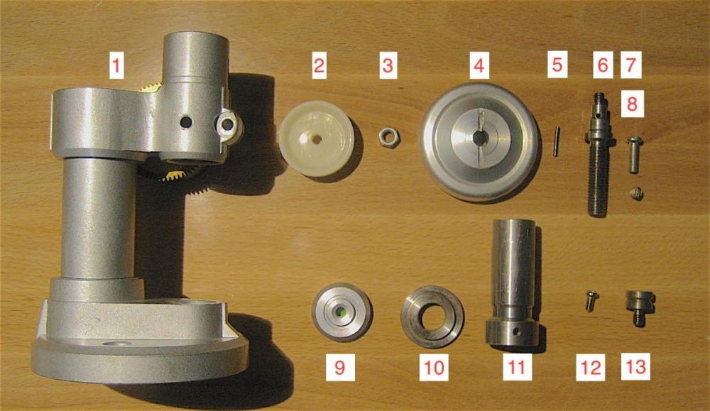

I have this one and it is very nice!
If I'm not wrong it has no lever neither screw, which means some tight crystal, caseback or rotating bezel  will not go in place with the limited direct force. The dies are few and have a threaded hole, so one would have to make new ones to be use correct size or hollow ones.
As common with Chinese products it can be found cheaper elsewhere https://www.aliexpress.com/item/E25-Watch-Case-Press-Tool-High-Quality-Desk-Set-Watch-Pressing-Machine-for-watchmakers/32850805250.html
even a better price on ali
Actually it is a screw type press. Rotating the round knob (or wheel - it is about 6cm in diameter) the working piece descends, without rotating.
The tool provides a lot of control.
You need M6-hole dies, which I suppose are standard.
Somewhere on this forum, a kind colleague of ours, posted pictures with the tool disassembled. I can't find the thread but I saved the pictures. Here is on of them:

With the tool I'm considering buying, do you know if the die is rotating with the screw/wheel when rotated, as I've tried to illustrate in image B, or if it stands still as I've tried to illustrate in image A?
Of course it doesn't, otherwise I could not have said that it works.
However I recommend that you consider the other one posted above, which is more sophisticated and not so unnecessarily heavy. That original MKS is after all a something dating back to the 60's easily.
