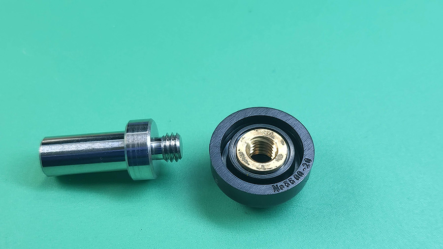

Thanks! The aluminium dies look really nice and I guess could be of good quality (the threads in the dies that I have can only be described as a joke), but what if I'd want to use them in the lower part of the press?
When Mark Lovick fits an armoured glass using his Robur press in one of his bonus videos at watchrepairlessons.com, he uses the die (second picture) in the lower part of the press and it seems like the perfect die for the job. I guess I would be limited to the supplied dies for the lower part of the press? Or, could I get some sort of adapter? Dimensions, where, etc. Again, questions arise... :huh:
No! there are dies in the set that fit the lower hole. I use an M6 screw to put a plastic die over an aluminium one (they will be held together by the screw)

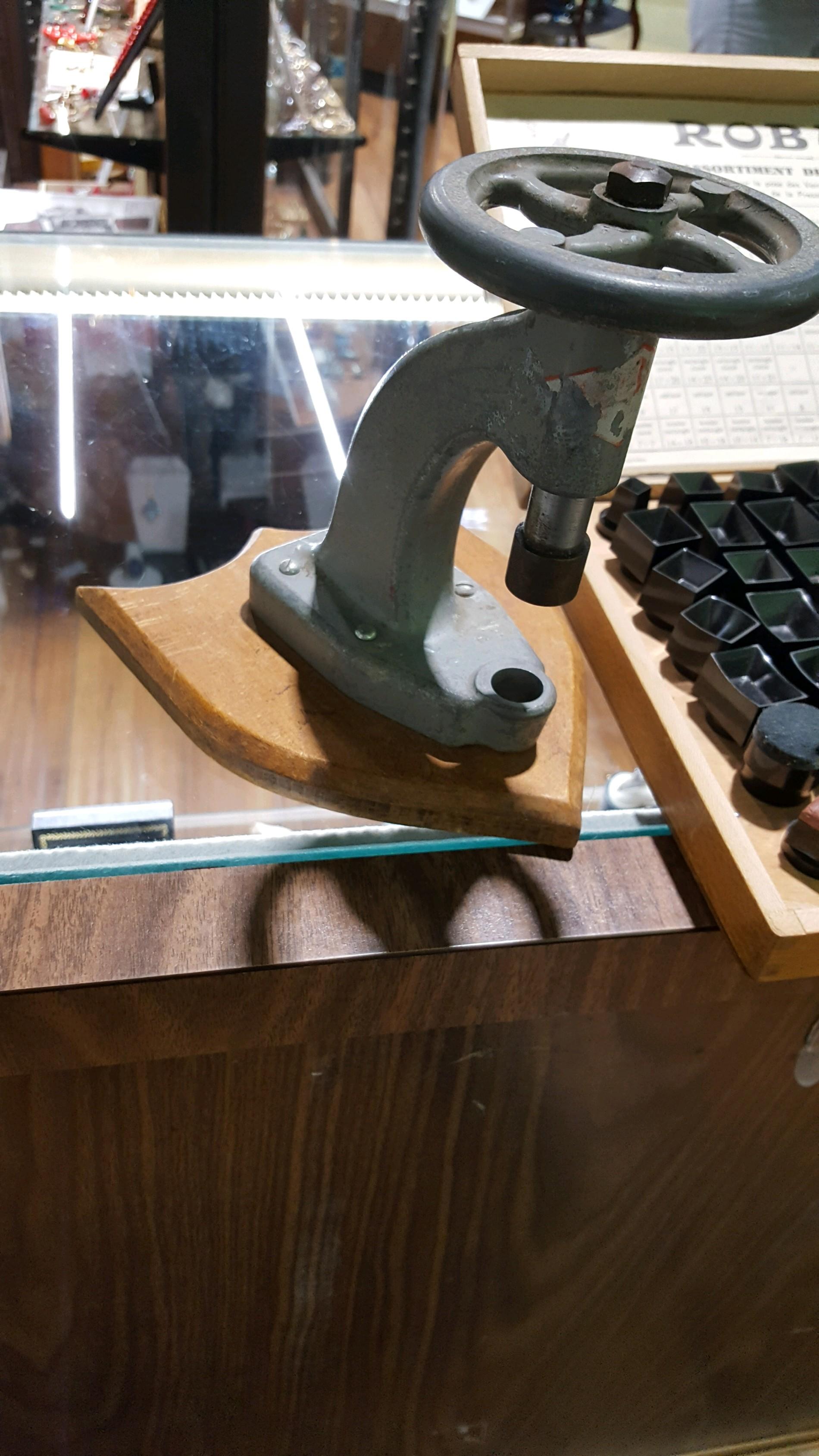

These are or the ones I have used for a while. Picked them up from a retiring watchmaker closing his shop. They work great, he did say that he modified the press some to center it.
