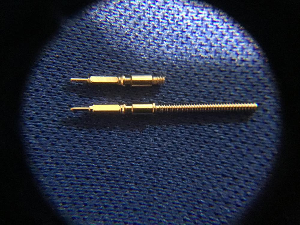

Thanks, but the problem is more that I can’t even get the stem in properly to the movement after I have removed it in preparation to put in the case. So it won’t go into the movement either when it is inserted through the case or even if I try to reinsert into the movement outside of the case. I was careful when I removed the stem and have actually tried removing from both winding position but mostly in the hand set position. But when I reinsert it is not working as it should. I read descriptions of which way is best but I think the consensus was mostly the hand winding. My last attempt on the ST 2130 I was tried in the winding position but that failed also. I can get it back in but it doesn’t function properly. It seems to be stuck in date position and won’t really go to other positions. So I can’t set time or wind. It will turn the day for a few times but then it stops doing that too. I. Any get to where I might need to trim the size of the stem.

 I had gotten replacement stems for 2824 from CasKer and it looked the same but I think it may be part of the problem.
If you trying to fit 2824 stems on a 2824-2 clone is no surprise that they won't work, as they are different.

Stems in pics are for 2824-2, the ones for 2824 have an heliced square section and are rare by now.
Some sellers don't know or make a distinction.
With Asian mov'ts you can't ever know which original parts fits, and vice-versa.

Btw, the broken one in the picture is one of the ones that was shipped with the movement.
Easy to see that there are differences, if you measure them you would find even more I think. But there should be just enough threads for an extender.

Thanks again for the info. I am assuming that the stem, ( the square portion) should fit through both the crown wheel and castle wheel. My new one does not.  But I don't think I have a stone that you refer to and certainly don't have the skill, being a novice.  So I guess my best bet at this point is to wait for my extenders to arrive and see if I can get lucky with that.
I didn't notice any markings on either of the two types of clones I got a hold of. One was the ST 2130 2824-2 ( link below)

I see you still are struggeling, from the stem pics you sent one can see you snapped the stem just like predicted when the movement is missaligned in the case.
I have limited (none) experiance with the clone movements but from the pic of the stems one can see that they seem to have different tolerances in manufacturing the parts, the lower stem would probably be a good fit for an ETA2824-2.
