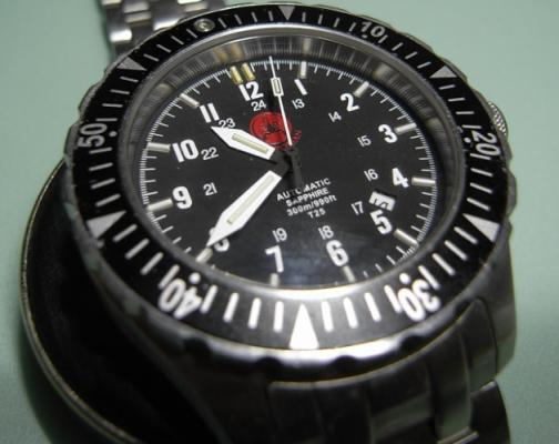

This is a budget driver's watch from a fashion brand called Scorpion, and I had no idea what I'd find when I removed the caseback  :huh:  Whatever!  I just wanna work on watch movements, increase my knowledge, and the repertoire of movements I've had experience with.  It's also a blessing to post these to help people with reference photos and walkthrough of various movements.

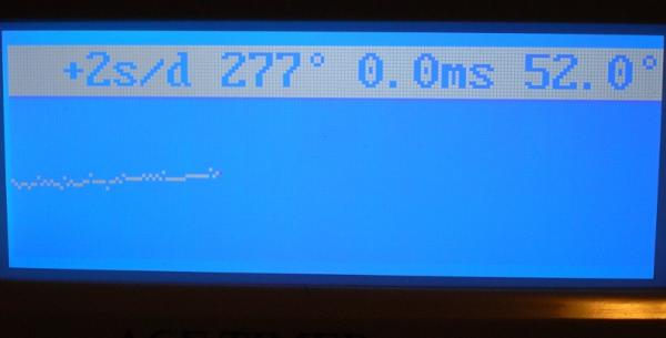

When put on the timegrapher, it was quickly obvious that this movement was not running well at all.
Extremely low amplitude, high beat error, and a graph that looks like the pepper in your mash potatoes :P

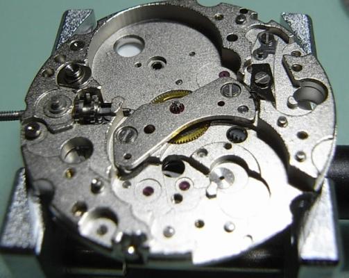

So as the title says ... Three Screws to Rule Them All .... Bam!  The whole movement has to be located into ONE plate, that's only held by three screws ... this is not Rolex quality gentlemen ^_^
After tipping the movement up-side-down and telling the complete movement fall onto the desk (just kidding), you are left with only the Centre Wheel.

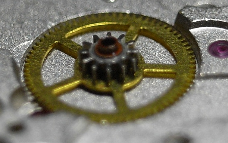

Once the Centre Wheel Bridge was removed, the fault with the movement running so badly came to light ... RUST on the lower piviot!
Rust also on the Pinion

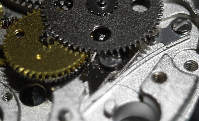

Over to the Calendar and Keyless Work ... looking way over complicated for a simple Date Wheel, as all the springs are there for a day complications as well; minus just the Day Wheel :( ... Gotta love cheap movements.
Reference photos of the Keyless Work.
One last thing to note with this movement.  The setting lever is riveted into the Main Plate, so it's not able to be removed.

The rust that was on the Centre Wheel and Pinion cleaned up real nice,
So the first step was putting all the Gear Train, Mainspring, Winding Gears, and the Automatic Work onto the Main Plate, and then locate all those pivots once the Bridge was placed on top ... this movement is a good test of your patience and skill :)

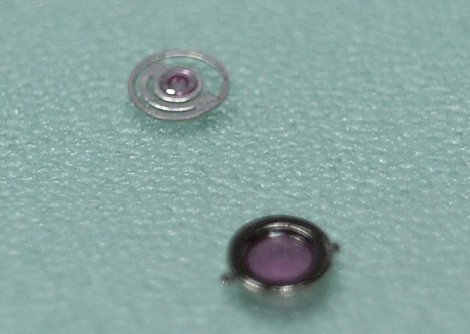

While I was on this side I also removed the shock system and oiled it.
It's a very interesting system, and extremely easy to clean and re-oil ... perhaps the easiest I've come across.
Flipped the movement and installed the Pallet Fork and Balance ... then cleaned and oiled the shock system on the Balance Cock.

Next was the rest of the Motion Work and Calendar Work
Date Ring and Cover Plate back in place
Lastly the Dial and Hands replaced.
Again this movement used H3 tubes on the Dial and Hands, so very little clearance when fitting the hands.
Back on the Timegrapher ... and she's purring like a kitten :)

Sorry to dig up an old thread...but this write-up, Lawson, really has helped me. The reference photo of the gear train layout was just the ticket.  I'm lousy at reading part schematics so a photo to confirm saved the day.  I will say, the keyless works on the Miyota just seem, to me, more robust than on an eta 2824 I just had apart.
Now to figure out how to remove the Balance shock springs to service.  What tool did you use to move the ring?  I'm thinking of using a needle to drop in and turn it.  What did you do??

The Balance's shock system are very easy, indeed, to service.
When done, the movement was producing +5 s/d, 265amp and .1 beat error. Lift angle of 49.  Which is the correct Lift Angle for the 8215.

No way I could have the calendar works back together without these pics.
