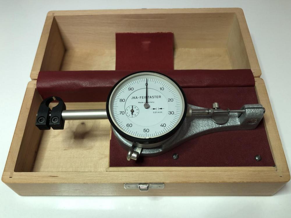

However, now, two and a half years later, a JKA-Feintaster in absolutely pristine condition surfaced on Tradera.com, and not being able to resist bidding on it I got it for just £99/€119/$134. Handling and using this JKA-Feintaster is a true joy and to me it adds even more prestige to "Made in Germany".
So, which one do I prefer? Well, the JKA is a bit more versatile (I guess) and the readability of the dial (super German design!) is just amazing, but unlike the Bergeon mic you can't really control how hard the spindles should press against the object (jewel) being measured as it is spring loaded. Not a problem, at all, as it's very gentle, but a very different feeling from the Bergeon. I'll be keeping and using both and and from my limited experience of the JKA so far I can recommend both.
