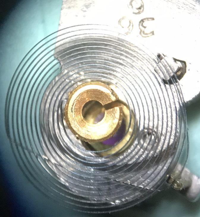

I am correcting a deformed hairspring and need to set the curve for the regulator pins.  De Carle mentions using curve-forming tweezers, which I cannot yet find.  What are the alternate practices for forming this curved portion of the over curve?

I don’t know that you will find tweezers labeled “curve forming” thought they may exist.  I’ve found in reshaping hairsprings, any comfortable fine tip tweezer will do.  The important point is BE GENTLE!!  They don’t call them “hair” springs for nothing.
Mark has some excellent videos on you tube on this very practice.  On point I did not SEE in the videos is to be careful of the angle at which you grip the spring before massaging it.  The end result should be the curve you seek while the coil of the spring remains in-line, that is to say, in the same plane.   Like a galaxy needing one of its arms adjusted.

The first picture is where I started, the second is the present state.  I need to form the regulator curve and then put it on the cock for final adjustment.  I'm just have difficulty in imagining how for for the curve without a bunch of "kinks" where I do the adjustments.

Hello, rduckwor.
the first coil off the collet is a bit askew and appears in the picture to be touching the second coil.  I would address that before addressing the final coil, as it will change the position of the final coil.
Move the regulator arm to the farthest point in the FAST/ADVANCE position.  Then mount the spring only, off of the balance wheel, to the cock.   Place the spring outer coil in the regulator pins.  At rest, the outer coil should be between the pins, not touching either.   Ever-so-gently, move the regulator.  The final curve should be parallel to the arc of the movement of the regulator pins and remain centered between them.  You will install and remove the spring and balance many times as you go through this process.  The goal is to have the collet rest perfectly centered around the pivot jewel with the final curve remaining centered between the regulator pins the entire journey of its movement.

Addendum:  the hairspring should be in the same plane, EXCEPT if there is an over coil.  The last 1/3 or so of the final coil being out of the plane.  Sorry about the confusion.
You need to sort this out, it is too far away from the collet, try to remove the kinks.

O.K.  Thanks for all the responses.  And yes, O.H. I know I need to correct the HS at the collet, just wanted to see if I could build the over curve before I did the easier part.  Here's he current state.  I won't lie and tell you it was easy.  HS work is something I have to take in small bites.  Clearly there is still work to be done, but I am getting closer to where I need to be.  Thanks to all of you for your advice and counsel.
