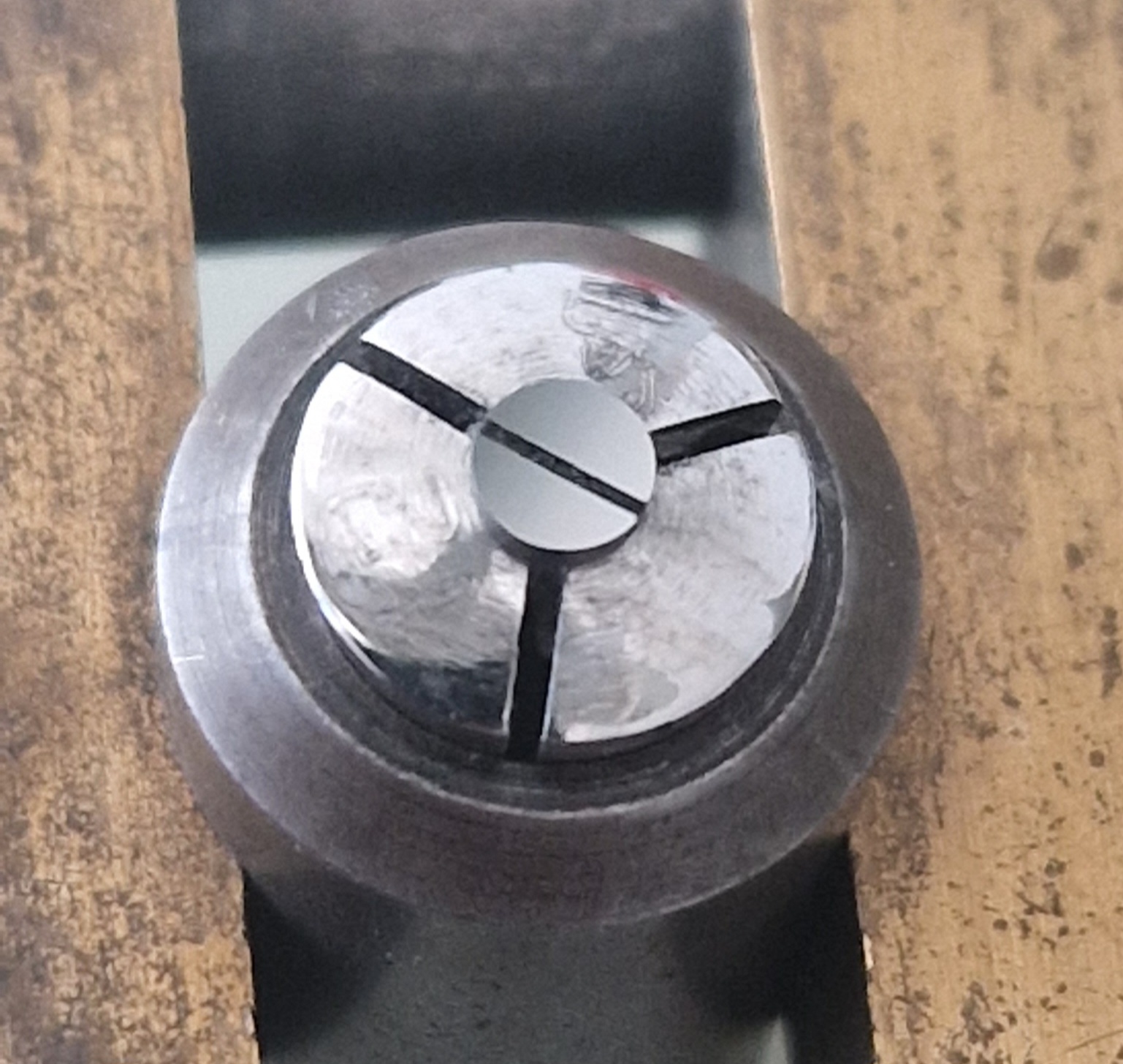

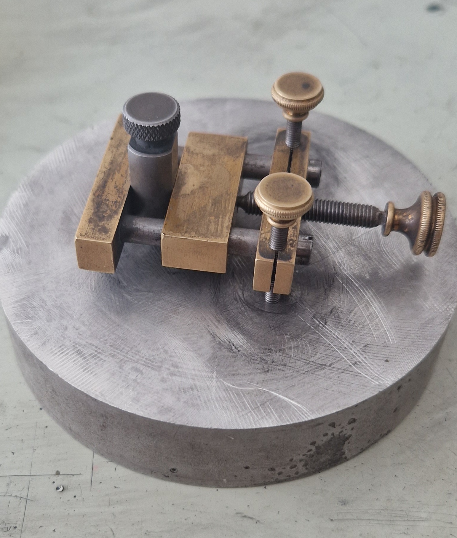

For those interested- some pics of a tripod tool and its use. There are numerous versions of these, best aren't too big, and can take a square head pin vise to hold screws. I have a bunch of little Schaublin P4.5 collets so made the holder in the tool.
Start on 12 micron paper, initial adjustment of the feet by eye, fine adjustment after a stroke on the paper, until there's full contact. Screw will be matte grained (but a little shiny) from the paper. Clean well, then to the tin with 1 micron diamond paste. The whole process including snapping pics was about 3 minutes for this screw.
Some folks go all the way to polish with different papers, but it'll never be as flat as polishing on tin or zinc or thick plexiglass, as the paper always has a bit of "give".
Hard to photograph, but it's called "black polish" because just a tiny tilt of view and the surface will go from brilliant to black when properly flat.

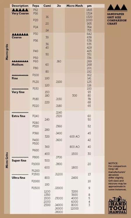

For sandpaper I'm used to "grit" (1000 grit etc), so 12 micron didn't say me a lot. Here a "conversion"-chart for people like me 🙂
According to the chart; 12 micron is somewhere in the range of P1500 - P2000.
Edited by Endeavor
Yes, it seems they tend to use micron when the abrasive has been graded particularly accurately. Cousins carries both the "colored" 3M micron graded paper, which goes to very fine grits, and 3M Imperial lapping film, which tends to be larger grits. Both are self adhesive (check for "AB" on the colored ones), and fantastic. Around the shop the most used for finishing are 20, 12, 9, 3, and 1 micron. The finer grits don't get used for flat polishing, but are very useful applied to sticks for beveling and such. 30 and 40 micron do get used too on thick glass backers for flattening large pieces.
Do you need to return the tin / zinc / plexiglass surface to flat once in a while, and how do you do it? I can imagine the surface becoming concave in time, or does that not happen because of the embedded abrasive?
It does get scarred or deformed or just contaminated with time. I skim the surface in the lathe, but it can simply be filed too, but way way faster in the lathe.. It does need a bit of a textured surface; I use a thin section coarse file to scratch it up after turning in hte lathe (thin so that it lays flat on the suface).
