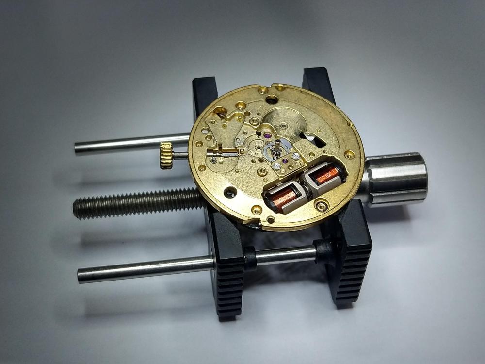

Bulova Accutron 2181 - had an open coil I managed to bring it back into life.

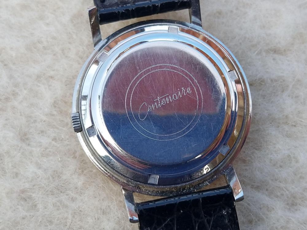

Eterna-Matic Centenaire "61" - 1438U - not serviced just pics.

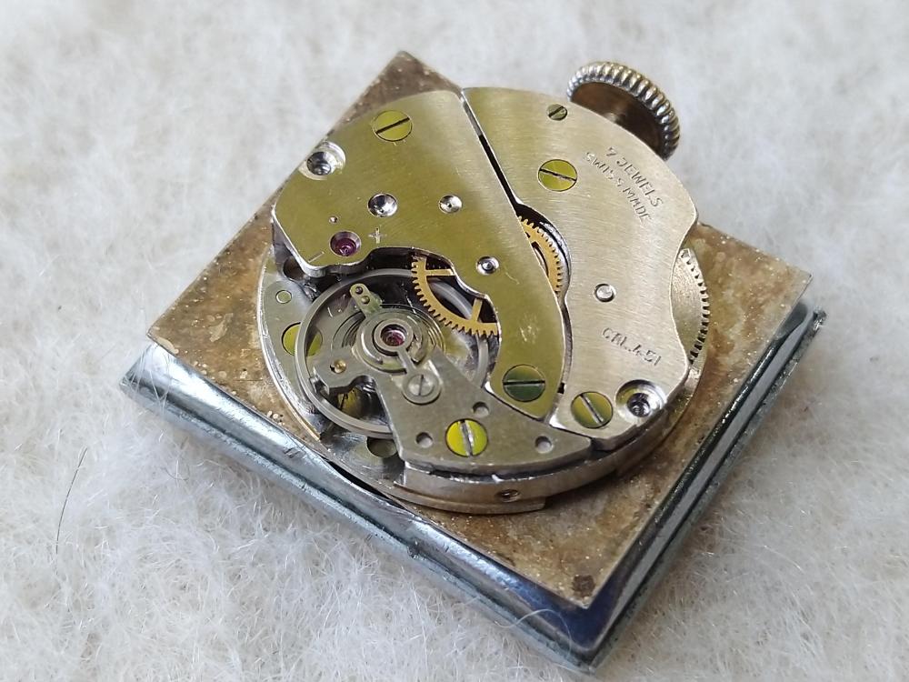

Longines Cal 431 - not serviced just pics

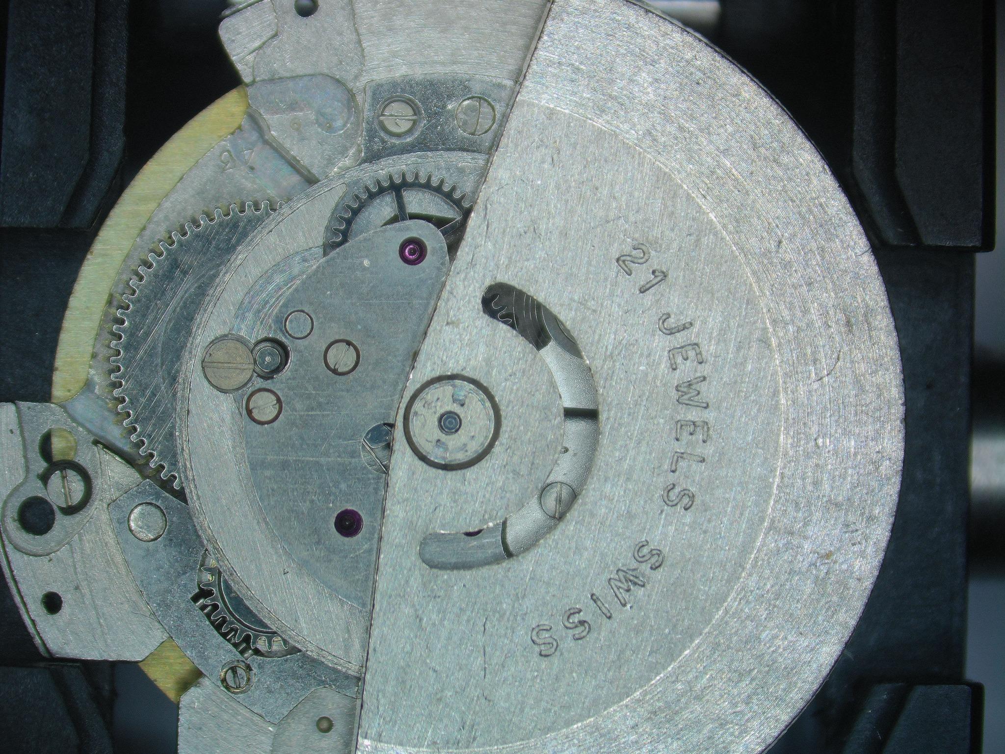

HWGIKE#3 Felsa 4007N
21 jewels, swiss lever, automatic. Crown is not original as far as I can tell, and its a bit difficult to turn it, as it is a bit too tight on the tube.

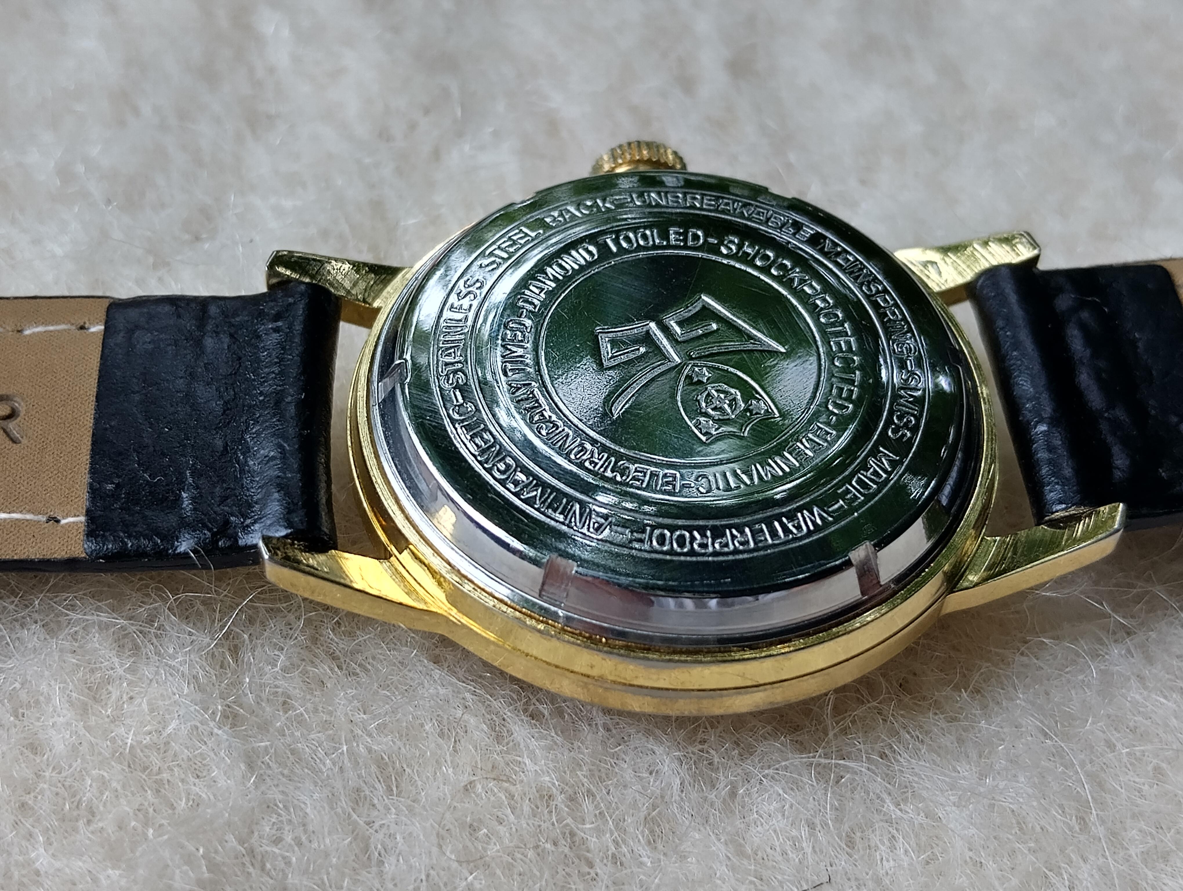

HWGIKE#4 EB8127
Full service. Roskopf, 21 jewels, automatic. Don't forget to put the click back into place because it is in the middle of the sandwich, cannot be easily accessed. My first ever Rolex... oh wait .. Raflex! 🙂

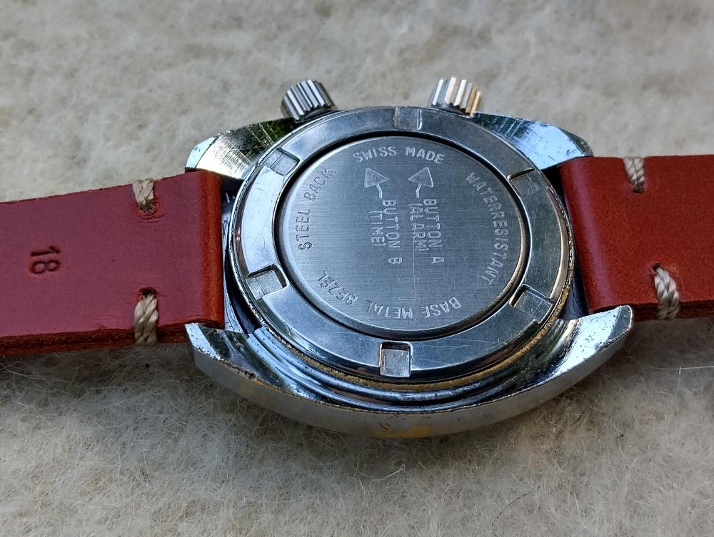

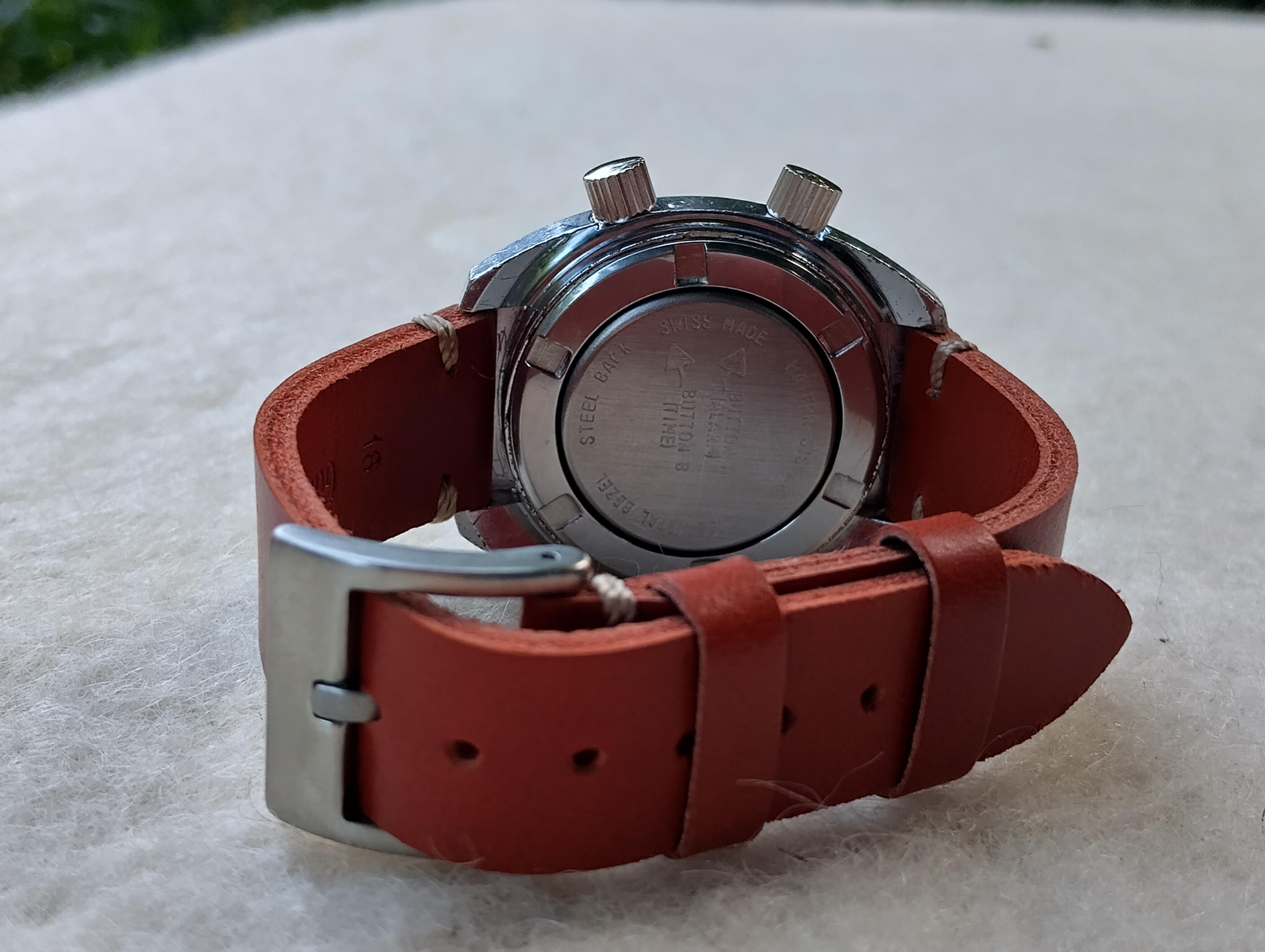

HWGIKE#10 AS 1931
Full service, two worn parts are replaced. Swiss lever, 17 jewels, calendar and alarm. Home painted dial. Two new crowns, unfortunately they are higher than the original so it looks like a rabbit now. These were the only ones I could find with Cousins. Hands are re-lumed. Not very attractive but the movement is running happily with a nice performance.

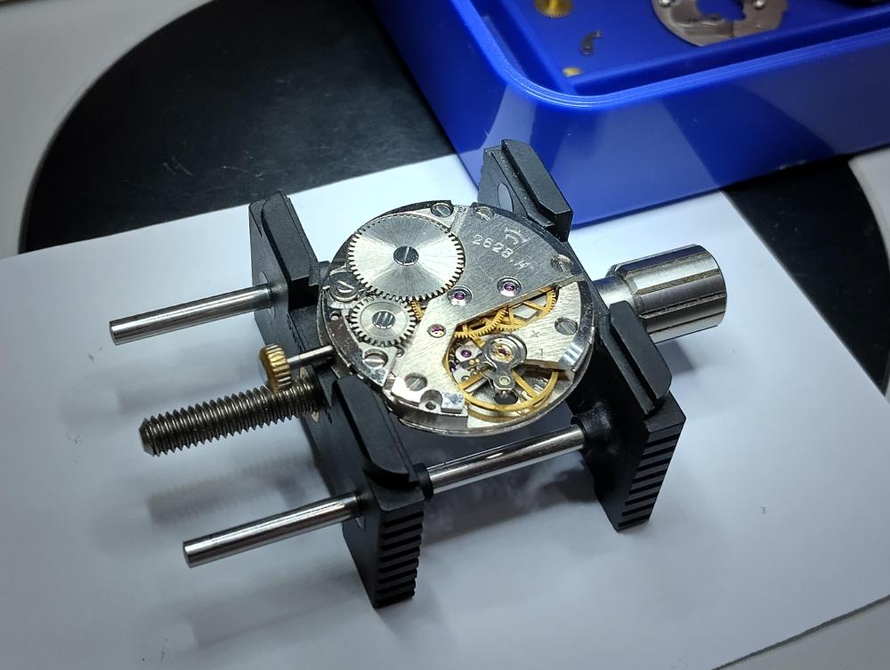

HWGIKE#12 Raketa 2628H 61009
Full service. Major mistake(s?) were made. What does the one do who does not release the power before taking off the pallet bridge? Well that's a good opportunity to practice how to glue the pallet stone back with shellac. I am actually happy about it because now I have a shellac syrup I can apply at any time anywhere where it is needed. I still need a pallet warmer though because I don't want to wait a week or so for the shellac to dry. I also managed to break the balance stuff? I had 6 weeks off when I could not touch my lovely watchmaker tools at all, but before I went the balance stuff was ok.. so do I think and when I returned one of the pivot was broken.... well we had visitors meanwhile, but it is highly unlikely that they played with it... anyway I bought a balance complete, but the new staff was too long so i had to borrow some Russian spacers from a poljot movement for the balance cock to adjust the end shake. Its performance is surprisingly good, almost a straight line on the time machine and the amplitude is great too.

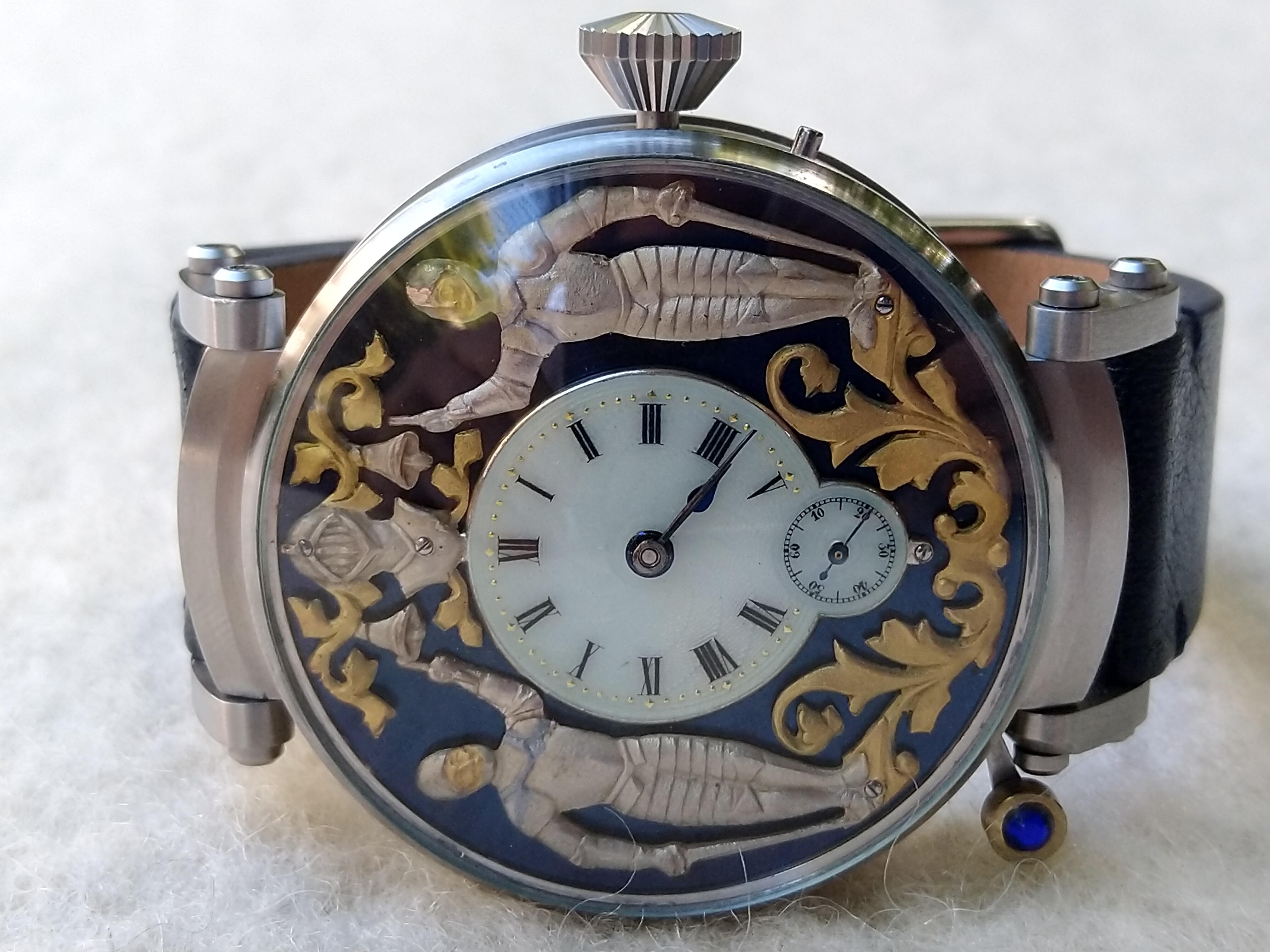

My Jaquemart automation pocket watch now converted to wrist watch. Original case was lost some while ago, but I managed to buy the movement which is cased now.
Sounds familiar. Err.. not that I would ever do such a foolish thing of course 🤫

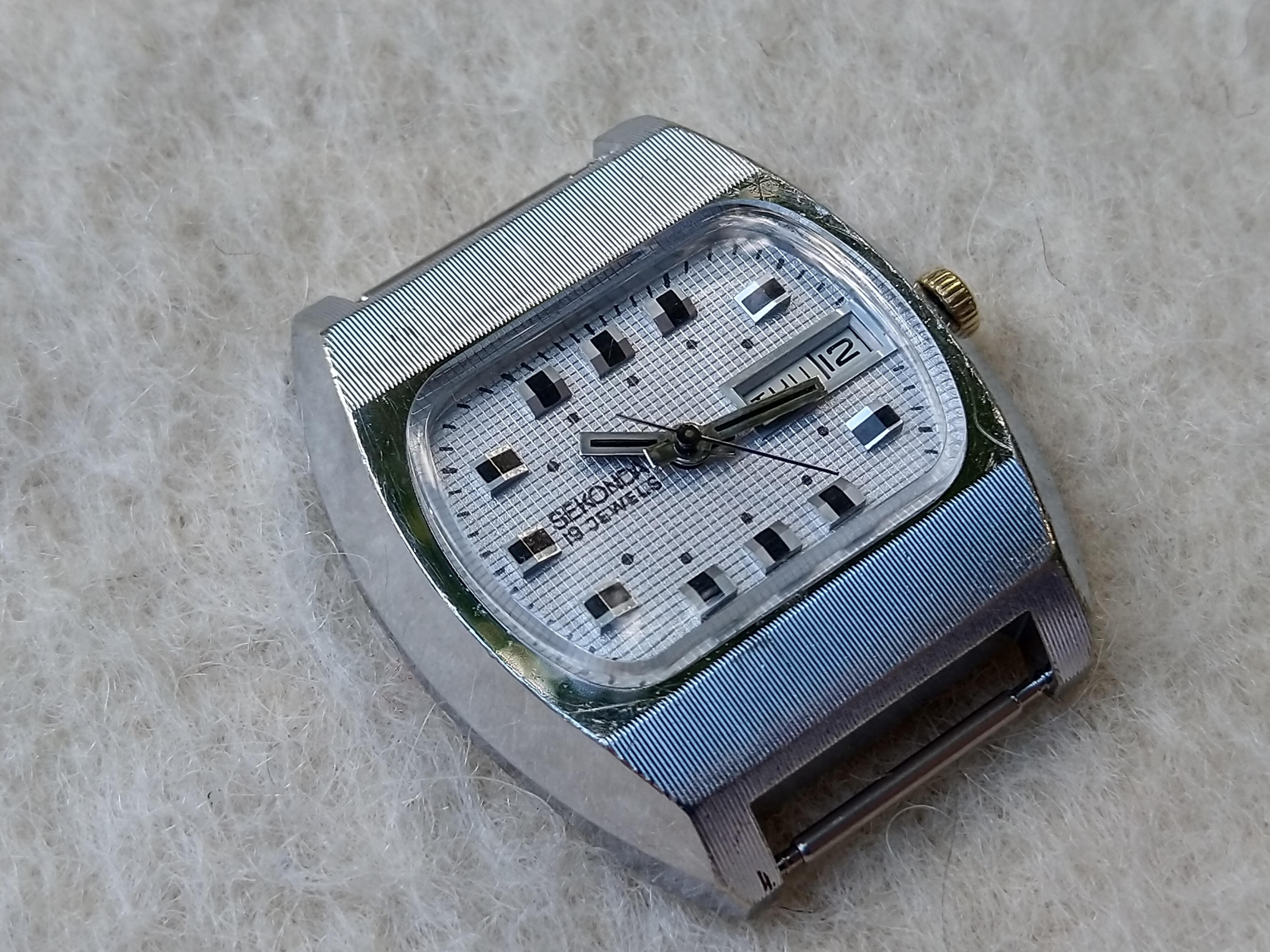

I have a similar TV faced Sekonda that I managed to get to run at pretty much COSC standards, despite my rudimentary servicing and cleaning setup. Nobody was more surprised than I was. They seem to be very robust and survive years of lack of servicing without too many complaints.
I love the Jaquemart automation pocket watch conversion. Excellent work.

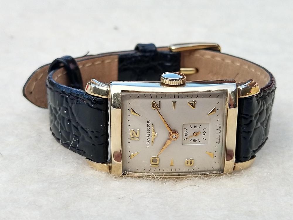

HWGIKE#13 Longines 25.17
Full service. I have a new number one enemy. Hairspring was replaced with hairspring with Breguet overcoil. Spent about 8 hours with just that. Nice performance at the end. A little bit awkward shape, my movement holders did not like it, otherwise a nice movement and was good to work on it. This is a watch I sold earlier, but came back as it was not a reliable runner. Had to work on the case too, it came apart easily now its a tight fit.

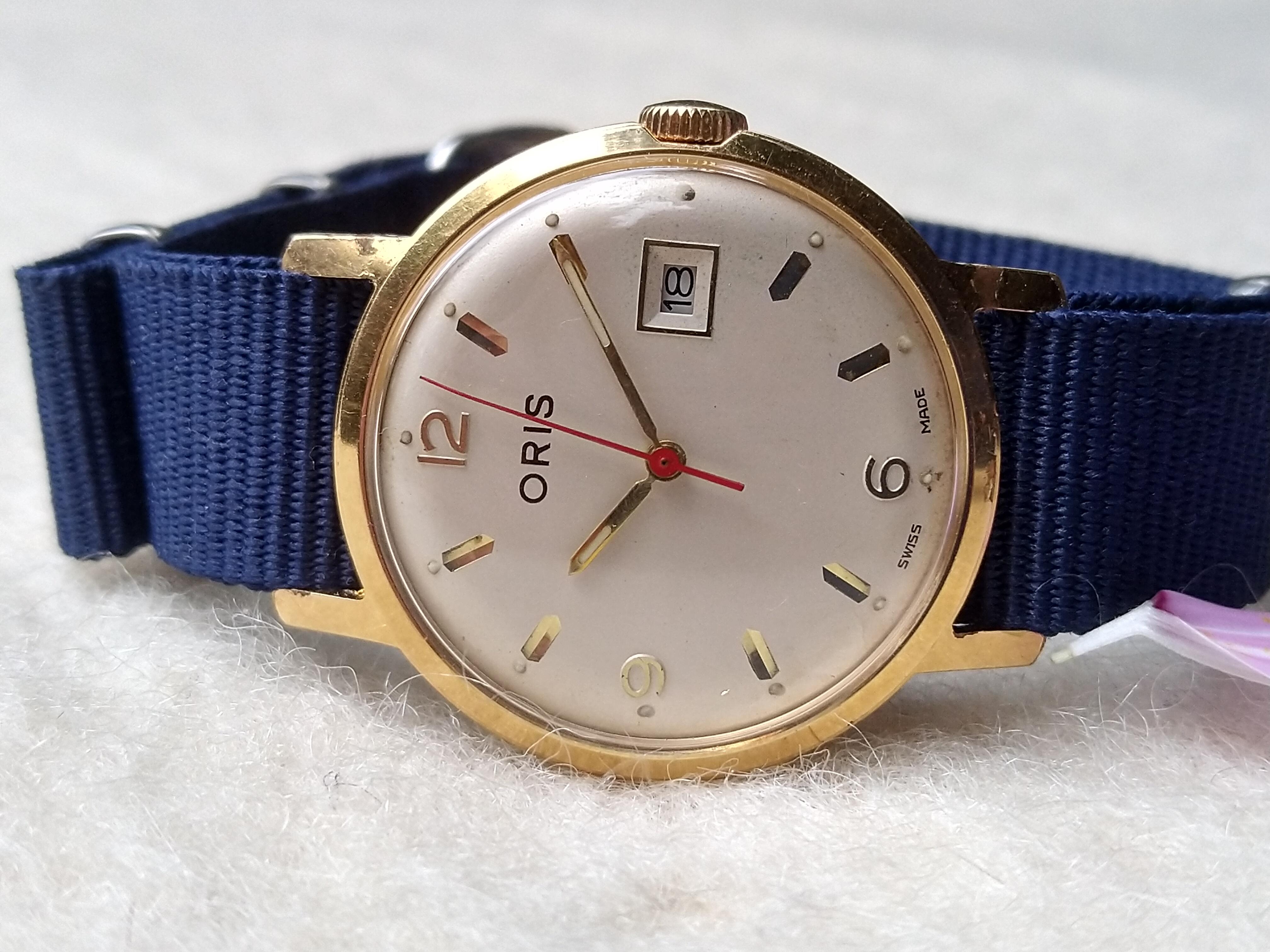

HWGIKE#15 Oris 715
Full service. Pin pallet with very nice performance after the cleanup. Re-lumed hands and dial, looks cool in the dark. About the same age as me. Don't clean the dial with IPA though, i damaged the lacquer a little bit.
