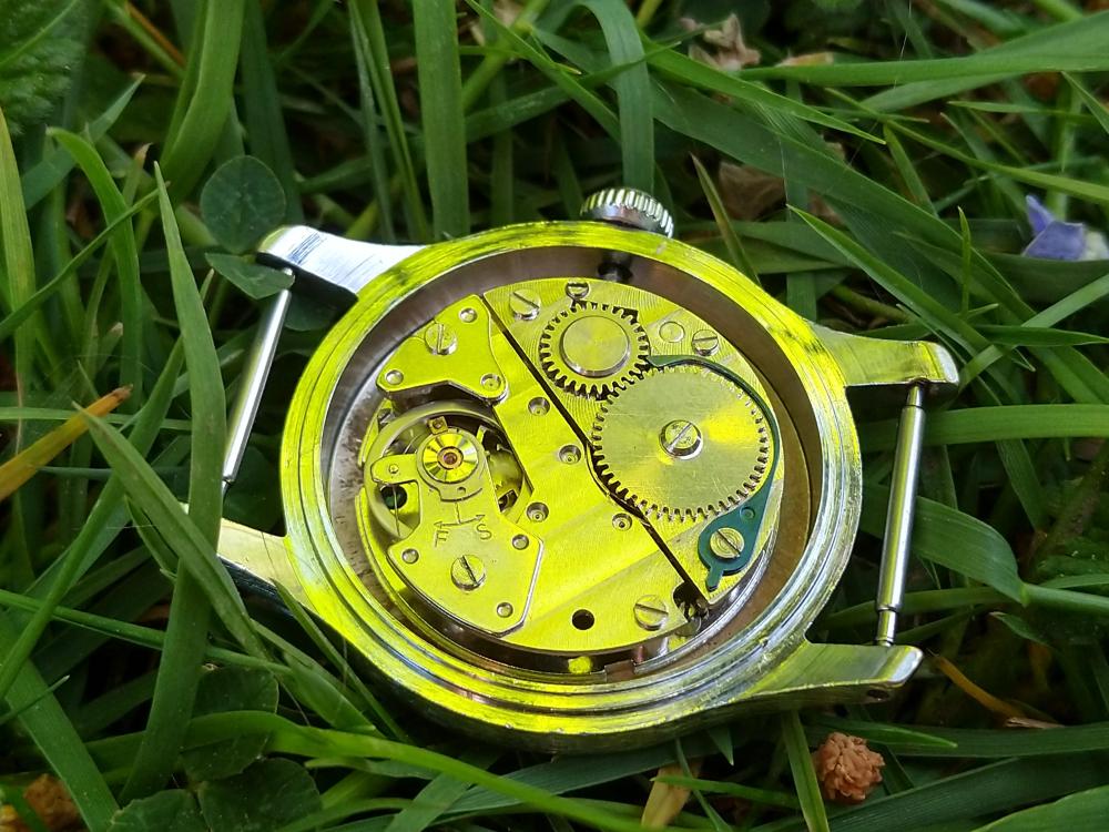

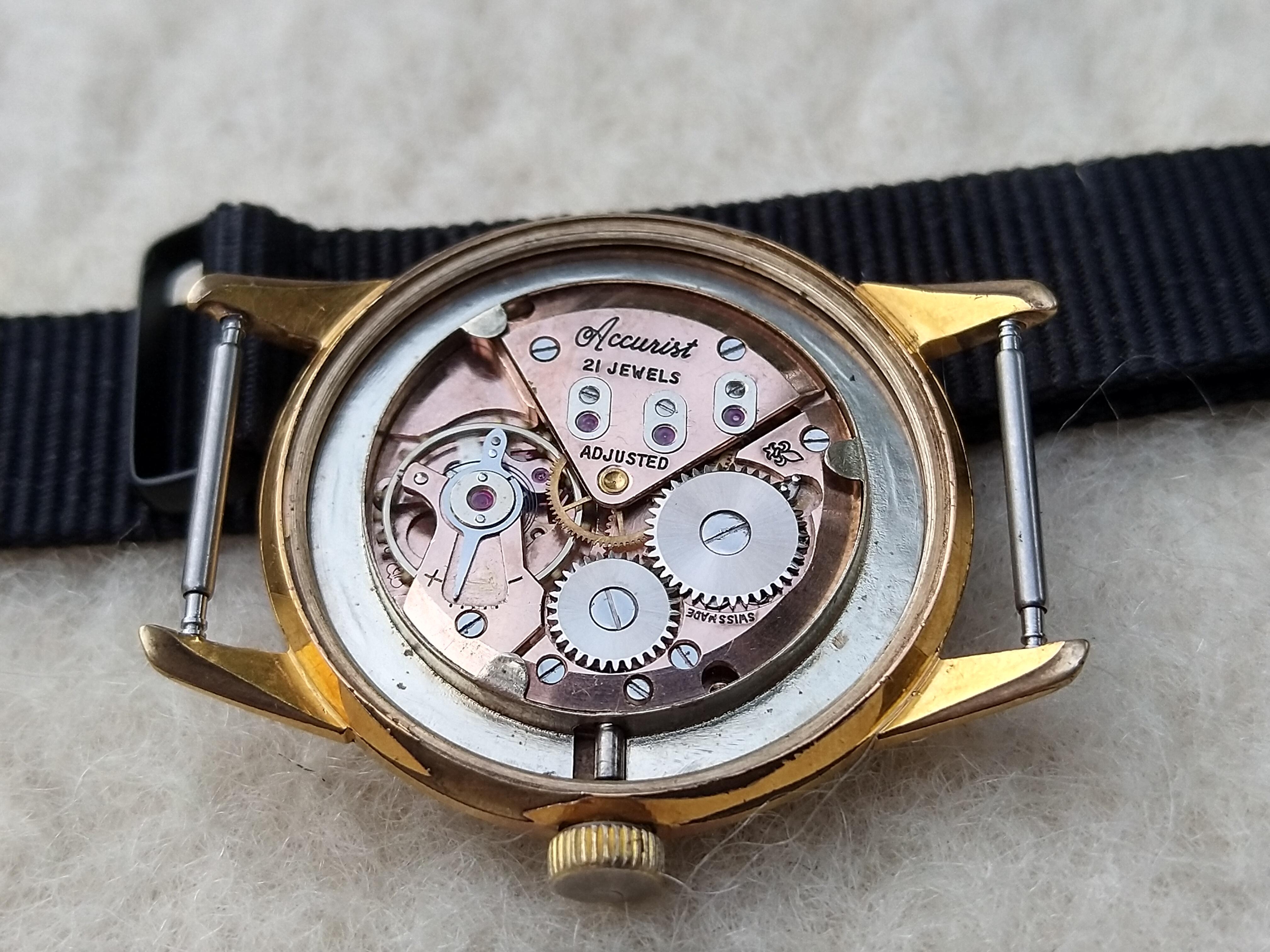

HWGIKE#34 Services Competitor, pin pallet.
Full service. MS was broken, was very dirty and very oily, but all three together saved it in a good condition more or less. Started to polish the case back, it was a mistake as I slightly removed the plating on the edge. It didn't say stainless steel.. i still thought it would be anyway... it wasnt, as you would expect. I kept the old strap as I found it fitting, it belongs to my only one returning customer, Stephen.

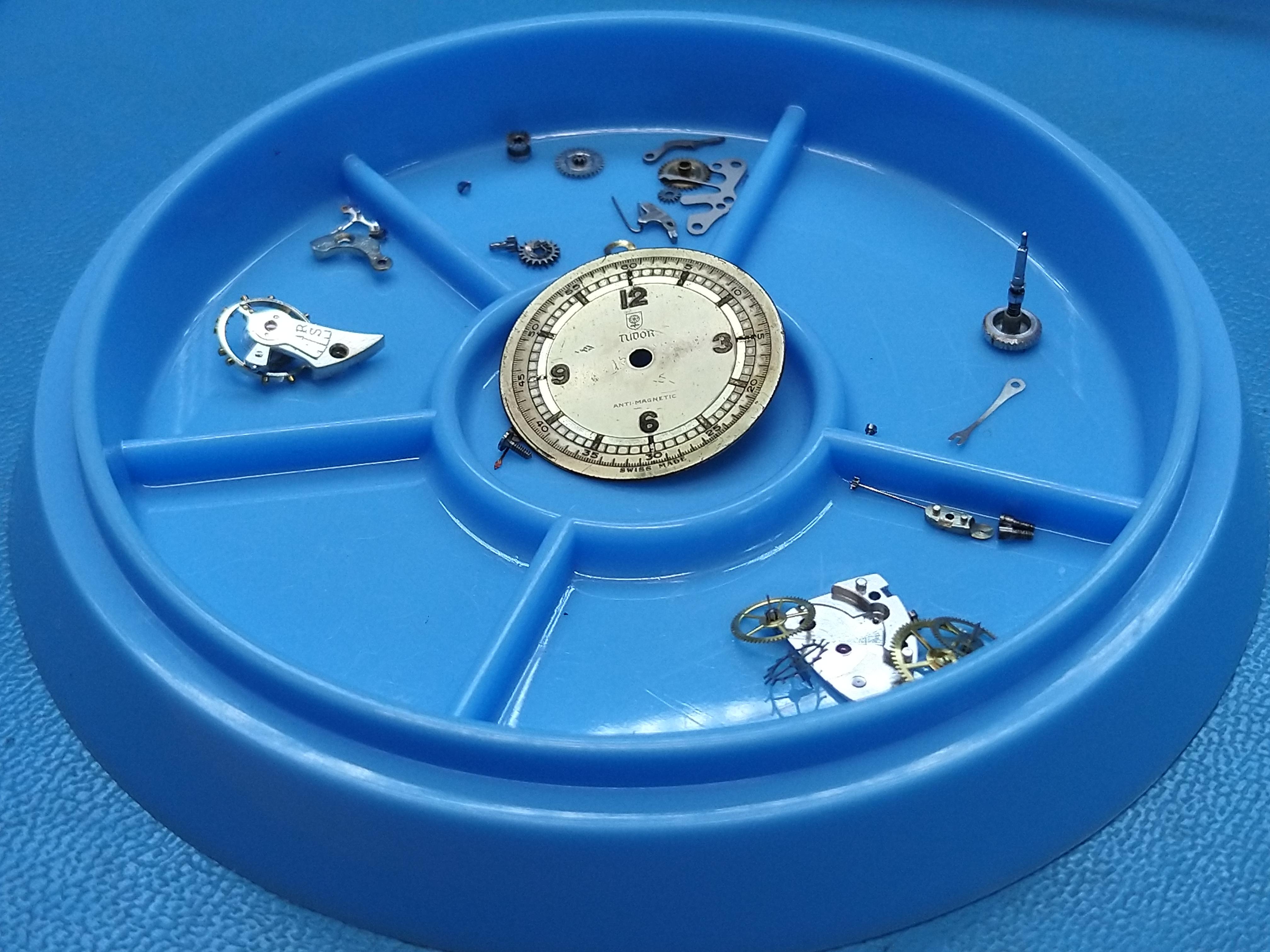

HWGIKE#35 Tudor, unknown caliber.
Full service, this one also had a broken MS, boys size. The hole for the MS arbor was tightened. No mistakes were made this time, finished with the Services together last night.

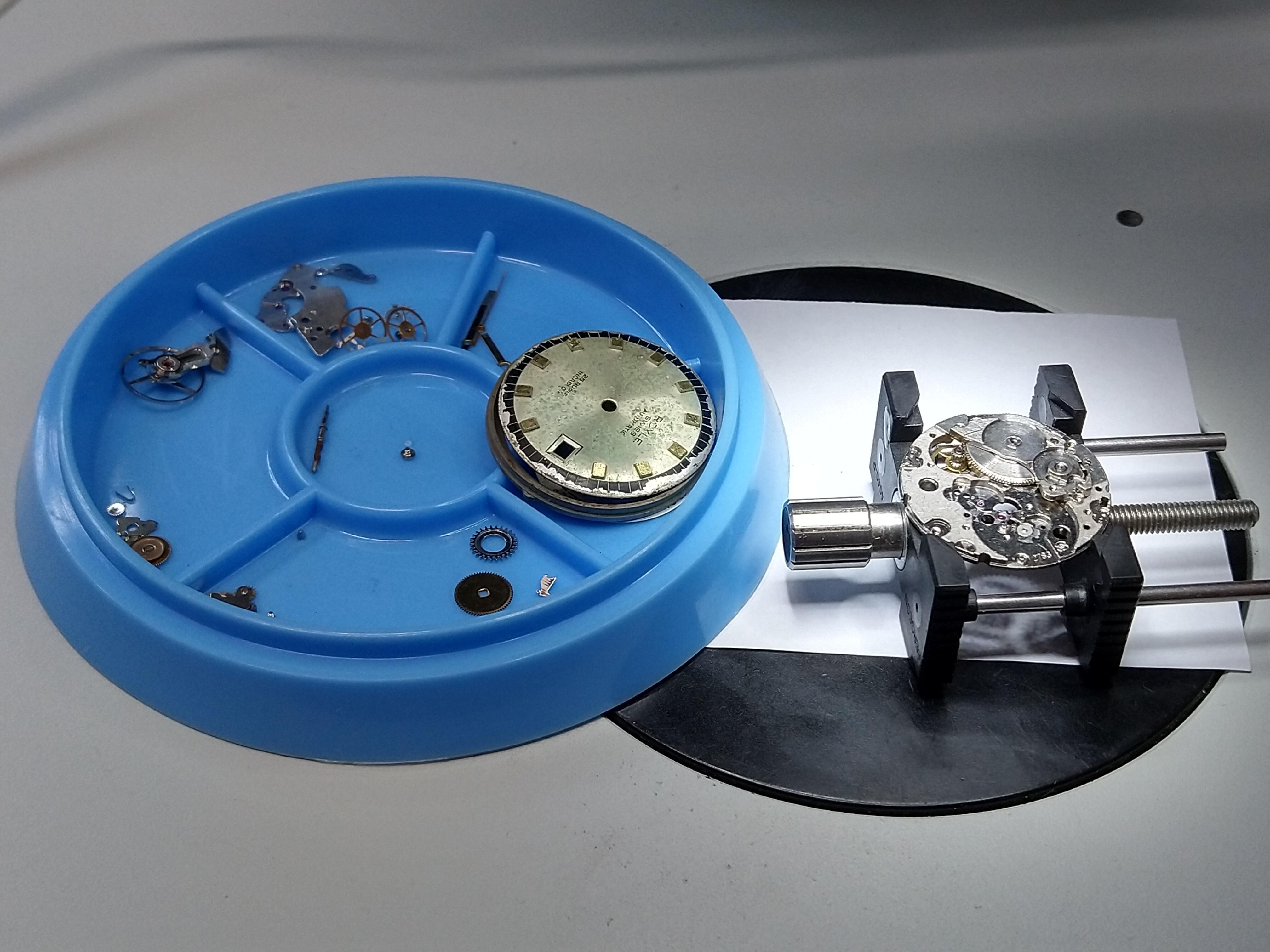

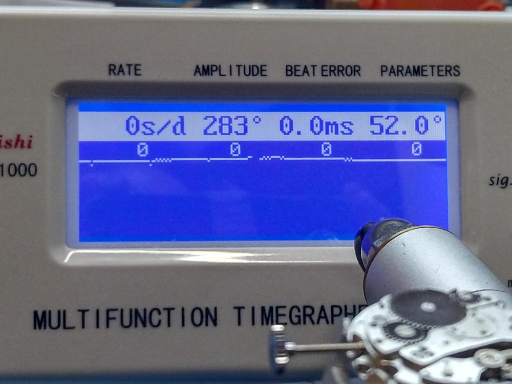

HWGIKE#35 ETA 2390
Full service, hands and dots on the dial are re-lumed. Hole for the MS tightened. HS was in a bad shape, but i managed to bring it back to flat and concentric and I got lucky too I put the collet back in such a way that the beat error came exactly zero the first time with around 280 amplitude, straight line. Woah! Very happy! The case is very very worn including the inside of the lugs, someone must enjoyed this beauty for a long time. Dial also have a dot on it something went through the paint cannot help it.

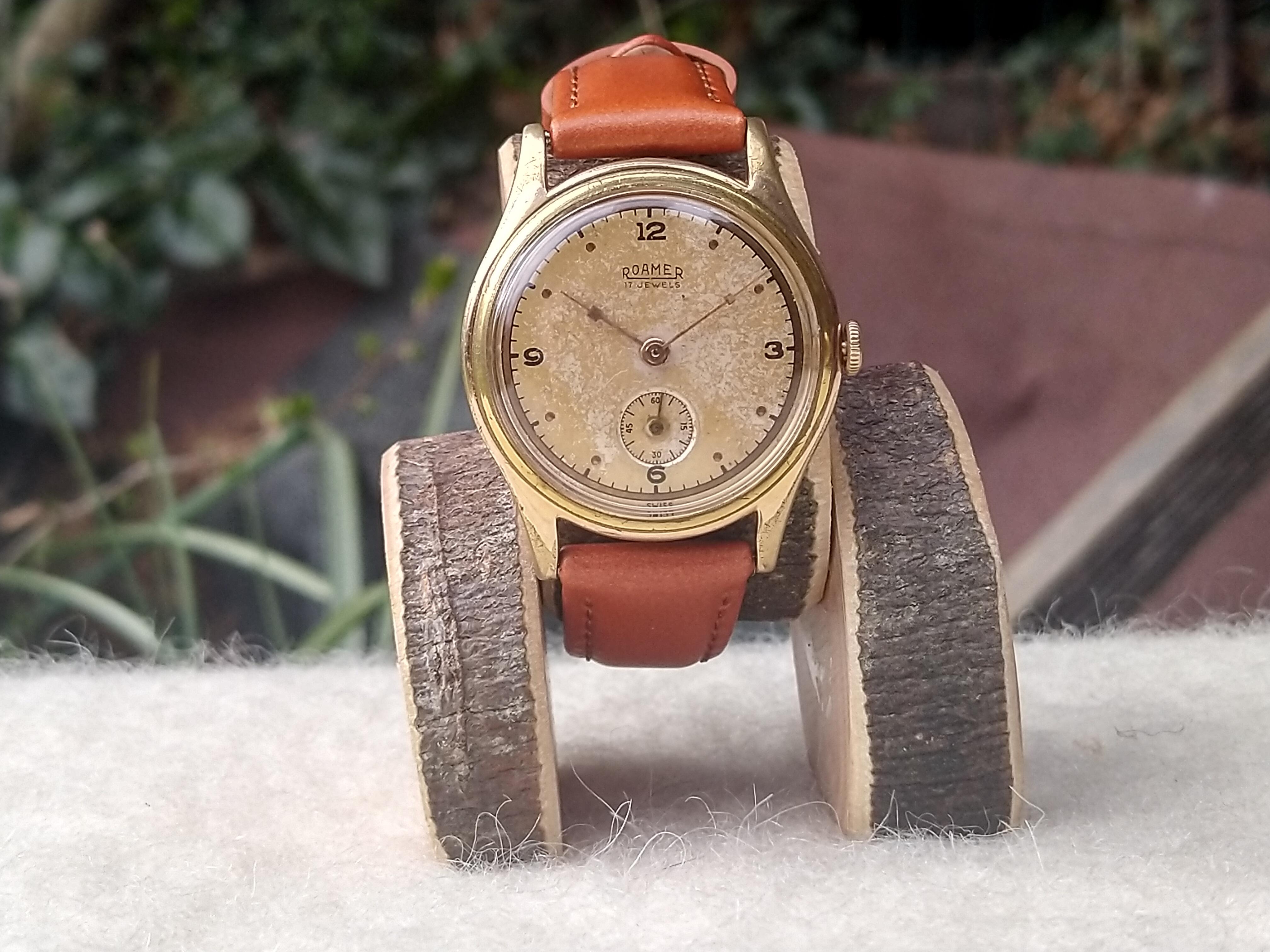

HWGIKE#36 Poljot 2614 2H
Very nice condition inside and out. Very nice performance. This is the style I like probably the most, simple & clean. 17 jewels, Swiss lever. Hole for the barrel arbor tightened (staking set is used for this purpose the most), new glass, new strap. Barrel arbor plays hide and seek with me winning, but i had many other substitutes.

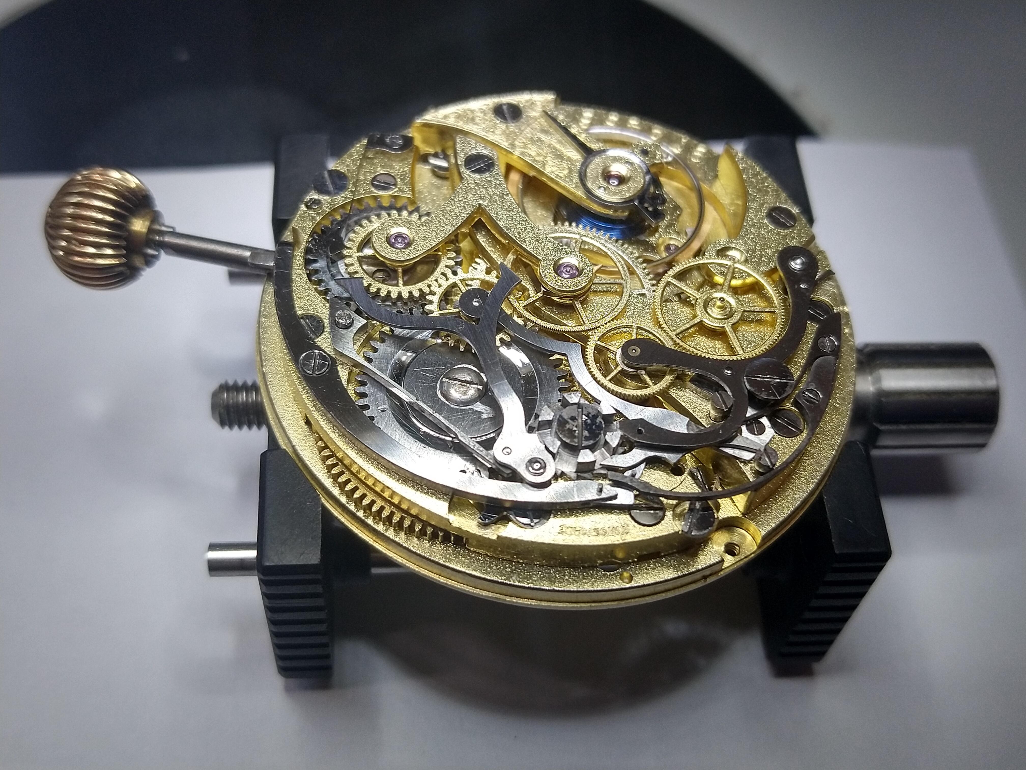

HWGIKE#41 Swiss chronograph pocket watch.
I have been slowed down for the last 2 weeks or so because i was finishing the flooring in the attic. This is where I store most of my watchmakers related cartoon boxes and it became so chaotic that I had no choice, but to finish the complete flooring and to build shelves not just for watch parts but for everything. I still managed to find some time... with very little sleep...to do watchmaking. Here I have my first chrono pocket watch which was a real watchmaker job. Had to replace one rub in jewel cap for the balance, i had to re apply shellac juice for the pallets (had to quickly build a pallet warmer, going to finish it later, but for the job it was ok, i was holding it with a pair of pliers), the yoke spring is not original and had to work on its shape a bit aaaand... it has a Breguet overcoil hairspring where someone before me shortened the HS by pushing it out a bit and not cutting it... i had to bring it back from there keeping the beat error low and the amplitude high. I am very very satisfied with the end result. My memory is pretty bad nowadays, i cased this a week ago, had no time to take pictures since ... not like we had any sunshine for natural light since last Friday... however I believe no major mistakes were made. At the end I pushed the minute counter hand too hard and it stopped the whole movement... it took me a while to realize that.

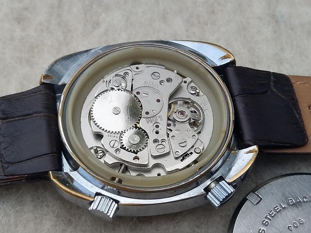

HWGIKE#44 Zaira 1509B swiss lever, full service.
So the last time I tried to service her sister I was brutal and destroyed her mainspring. This time I was gentle, but made two little mistakes, once I put the MS barrel together without the arbor and then slightly damaged the barrel when I removed the lid, and then I put the dial the other way around.... realized it when the hole for the stem was at 9 o'clock. 🙂 This is a lovely little Russian movement with excellent performance. Lovely design and it was great to work on it, it must be a reliable company for many decades.

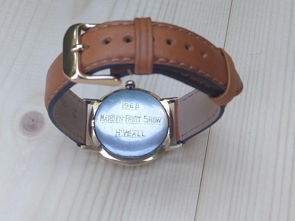

HWGIKE#45 Rotary Peseux 330 full service, acceptable performance.
When I took the caseback off the hairsping fell out, I immediately knew that this is the project I want. 8 hours later at 5 o'clock in the morning i was totally and utterly defeated... my mind kept me going, but at the end both my body and soul was squeezed and i slowly sunk into the swamp of tiredness making one mistake after another. When the HS fell out I checked if I have complete balances for Peseux 330 and I noted that i got two... that time I did not know that both of them were faulty... of course it was not an option to place one of them into the watch... i had to go on the hard way... I almost made it work and the HS was almost flat and sort of concentric but it was not good enough.... 🙂 When the HS was totally destroyed I tried my complete balances but both and then a third one I also found were faulty. Then I tried to marriage the HS from one of my faulty complete balances with the original balance wheel, but the wheel where I borrowed the HS from was not the same type as the original wheel so the HS was not compatible with it and I ended up like @Knebo with his Vostok:
... so I bought a donor from eBay and replaced the complete balance. The case and the crown are very very worn, when I took it apart I decided not to restore it so it would change its appearance, somebody got it in 1968 and it was a lifetime companion, I changed its glass though. Marden Fruit Show still exist, going to reach out to them to see if they want this watch, I am happy to hand it over, it has no real economical value anyway.
Edited by luiazazrambo
Great news! The watch has found its way home! 🙂 From National Fruit Show:
"It is so generous of you to offer the watch to us free of charge. We would be delighted to accept your kind offer and will keep it in our archives alongside other historical items. This year will be our 92nd show; when we celebrate our 95th we will be displaying old photographs etc, and perhaps the watch could be part of the display too. It would be interesting if we could find out more about H Veall and the circumstances of it being presented, but I'm not sure how well records were kept back in the '60s or if we still have them!"

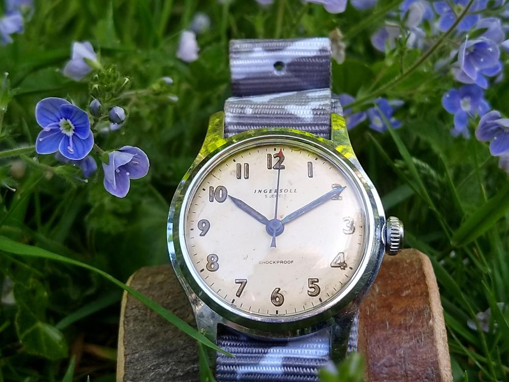

A bit of an experiment last night with a Seiko dial, the watch came without the bezel, glass and hands. The dial has received damage both from physical and chemical reactions. The experiment based on this: https://watchguy.co.uk/cleaning-and-preserving-original-finish-on-dials/ I repainted another dial earlier and used this method to re-apply varnish, but this was the first time when I tried to remove it while trying to maintain the integrity of the paint underneath. Unfortunately this dial was constructed in such a way that the text came off with the varnish together, or was it a varnish at all?
HWGIKE#46 Seiko 11A Pendant, Japanese Lever 🙂 full service.
Water damaged a bit, but only to an extent that I could still save it. Came without a glass but I had one in stock. Acceptable performance.

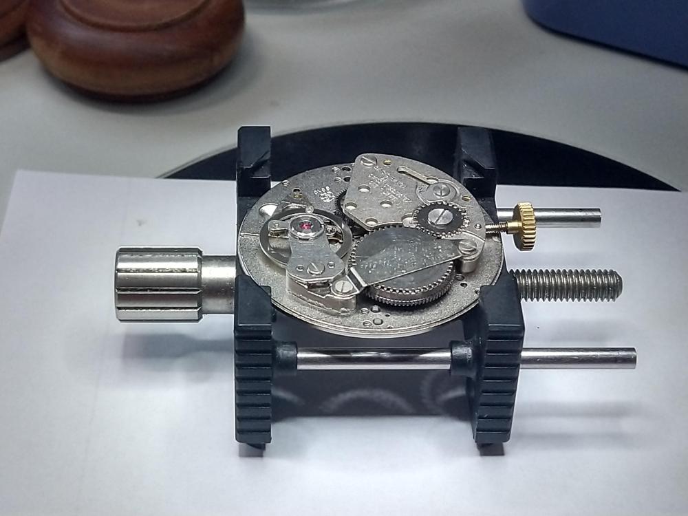

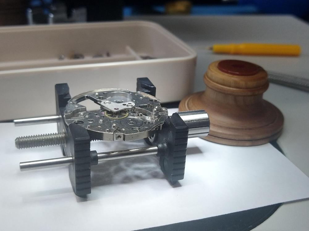

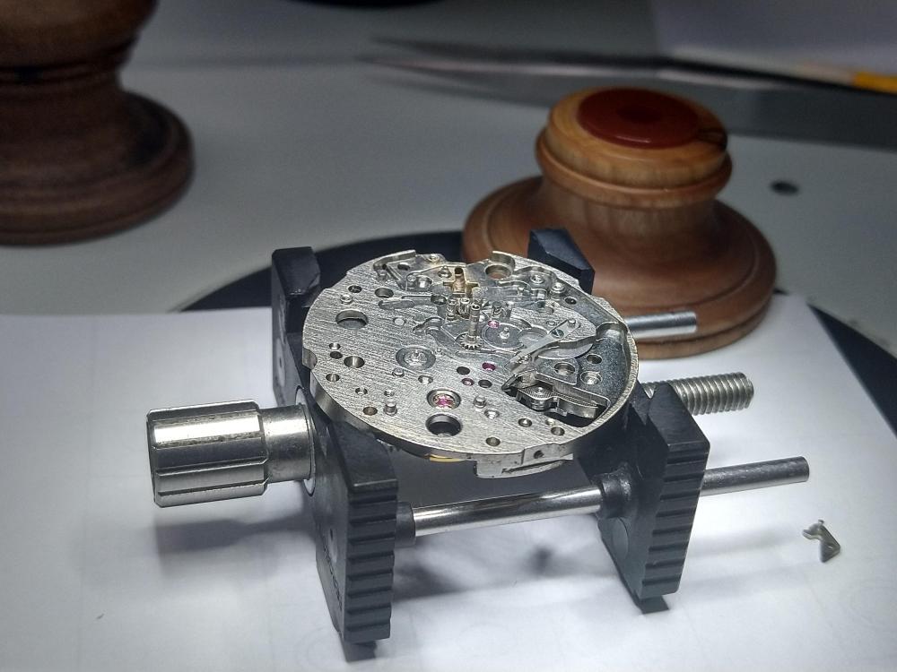

HWGIKE#47 Seiko 4006 Bell-Matic Half service and 17 -> 18 jewels conversion 🙂
Water damaged, too expensive to buy all of the parts damaged:
947805 Alarm setting lever spring
943805 Alarm setting lever
855805 Setting wheel rocker
383805 Setting lever
952805 Alarm setting wheel holder
8133006 Casing Spring
Mostly coming from dial side the other side is complete, I did not put the rotor on because it is not nice to handle the movement when it is on.
4th wheel pivot hole was worn out and the movement stopped.
Before:
After:

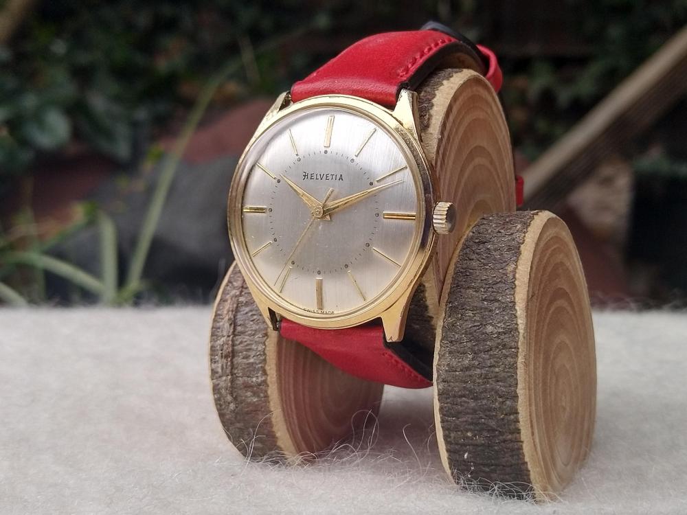

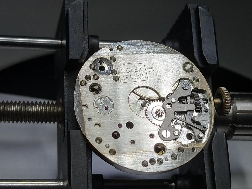

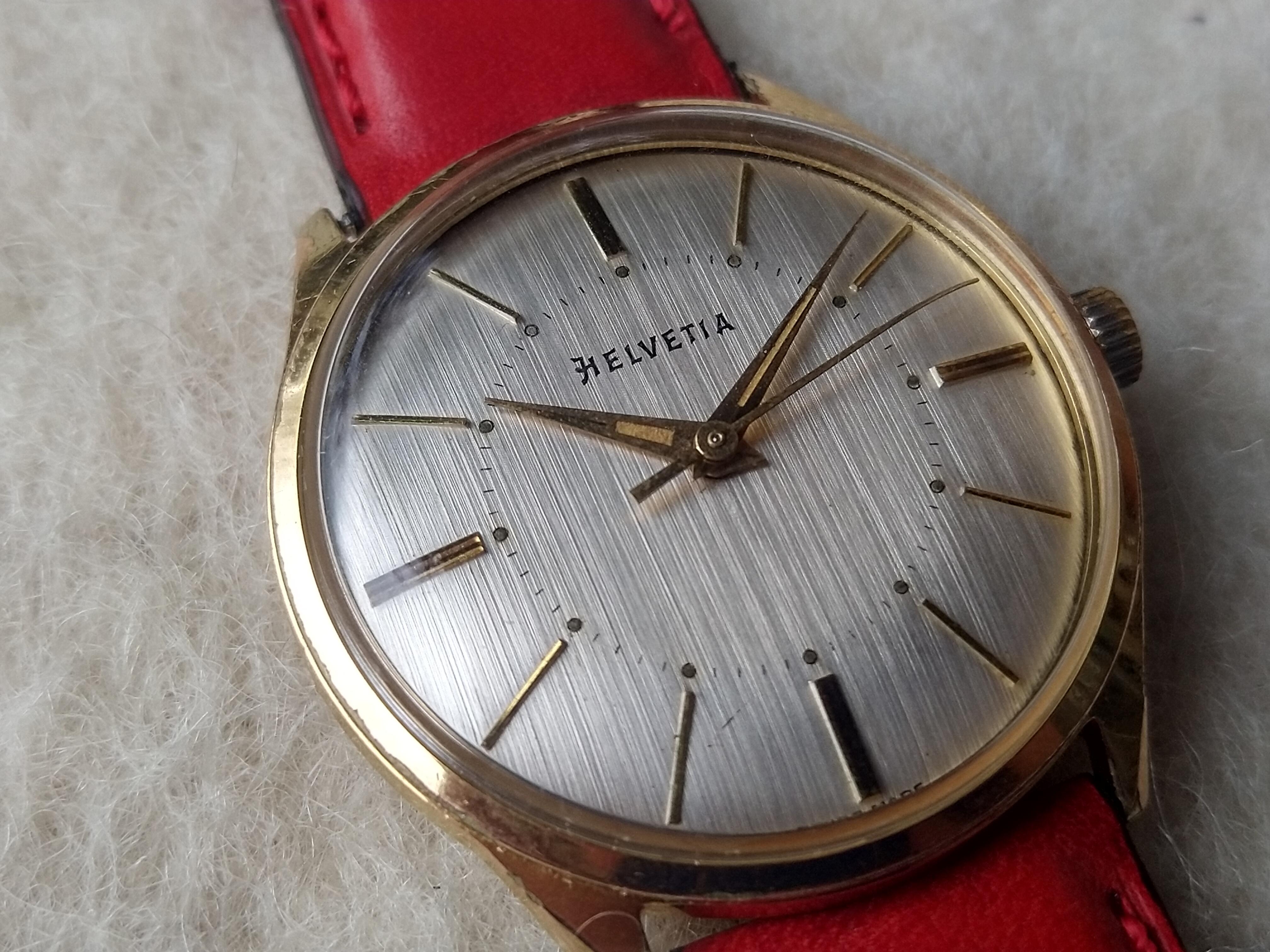

HWGIKE#50 Helvetia 831, Swiss lever, full service.
Both upper and lower arbor hole was worn had to be closed. Event less service, nice performance. Must be a rare caliber have not seen one before, very neat well designed movement. I love it.
Upper arbor hole before:
After:
