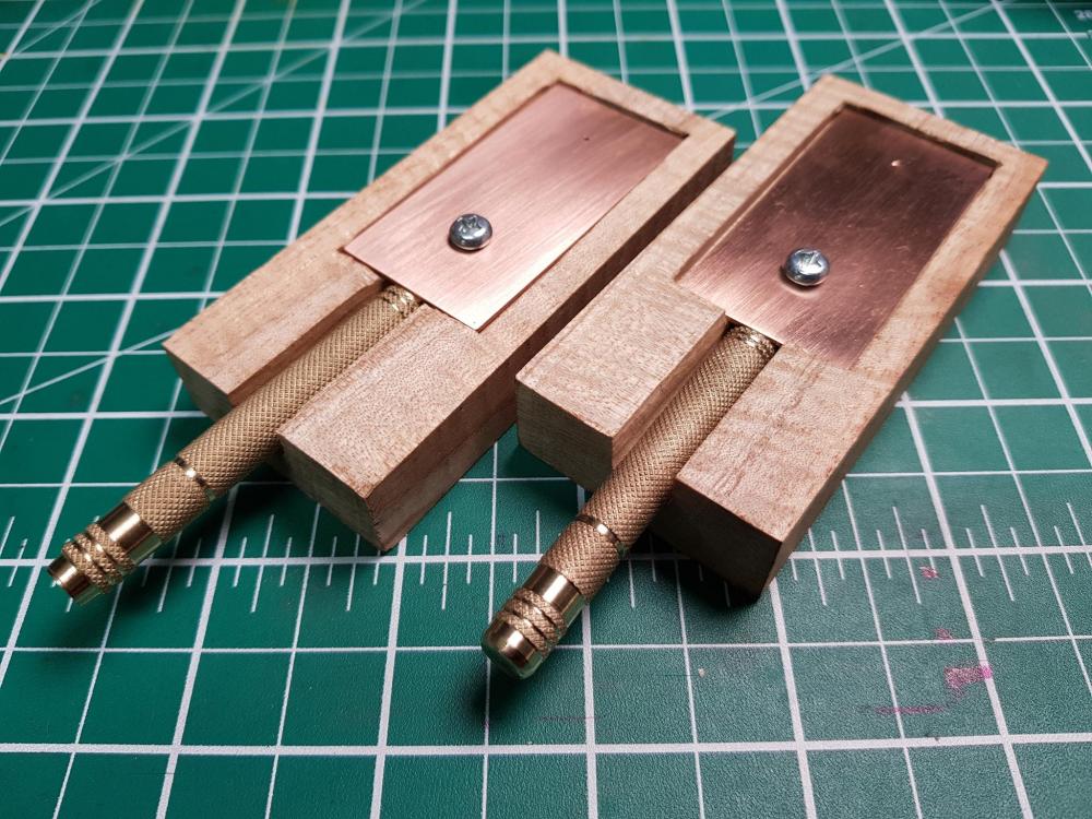

Editing a video on the construction at the moment.
Need to reset the pallet stones in a vostok which was loaded up with too much shellac. Unfortunately my pallet warmer is missing - searched high and low - I suspect it's in pallet warmer heaven. So I made a new one. Hopefully this will be an interesting video for some. In fact - I made two. Will do a giveaway to a winner for one of them. Details will be announced in my next video which will show how I made these and the video after that will the Vostok restoration where I will demonstrate how they are used.
In the meantime - if anybody wants to build one themselves, I have attached the plans to this post. If you do make one then post pics :)

I have the copper plate so just need some brass.
Any chance of a picture with the wooden holder without the tool itself?
You can see it clearly in the video Mark uploaded, he shows the machining out process but it could be easily done with a chisel or by tacking sides onto a flat piece.

Thank you Mark that is very helpful.
