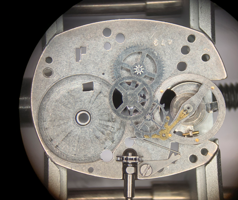

Here it comes.... I must confess: it was me. Me, who lost the battle. After so many hours, and I was so close at least twice. My advise first of all: RTFM. I got this beauty not long time ago, it is the brother of another one I almost received at the same time, but this one was a non runner. Quickly turned out that one of the pallet fork pin was bent, tried to get the fork out without completely stripping down the movement without reading the manual, but in a similar manner by unscrew some of the screws. I failed.. wheels were everywhere out of the pivot holes, had no choice but to do a full strip down. My first time ever for a TIMEX. Then it took me about 6 hours to clean it and to put the plate back... without the keyless work. I had no idea how could be this done with the keyless work... I have not read the manual.. started with the wrong plate... for various reasons i had to put that plate back again and again and at the end I managed to put all of the weels, fork, keyless work and the plate in 5 minutes compared to the initial ~ 4 hours. I was probably a bit lucky too. Anyway it was cleaned and lubricated and was ticking away nicely. BUT! One of the oil cup opposite of the balance screw had no oil in it, as I washed the movement again and again.
- So I tried to oil it. M23 HINT says:
Oiling. When oiling the dial plate balance cup, to facilitate the precise entry of the oil to the bottom of the cup, undertake this operation through the balance screw hole before the balance screw is assembled.
I ignored the "before the balance screw is assembled." - note that this point i was aware of the service manual content - and I tried to move the balance out of the way a little bit hoping that I can oil that cup with the balance still in place. I failed. What I managed to do is my nightmare: I BENT the HS! (i call it HS from now on, just like Voldemort could not be called Voldemort but "you know how" except Harry Potter).
So I unbent it, but it was not completely ok so the watch performance was also not ok.
I took the balance out (without taking the whole thing apart) and i worked on the HS again. I put it back again but it was out of beat. Decided to take the whole thing apart and play with the HS collet to bring it back to beat. When I removed the plate I dont know how, but I BENT the HS again!
So I worked on the HS again. I put it back and started to work on the beat by rotating the collet, did it a several times when my screwdriwer slipped and badly damaged the HS again. I could not bring it back into shape again... I gave up.
I was devastated.... I must have worked on it ~ 20 hours.
Additionally I lost the dust seal for the stem, no idea how and when I tried to push the crystal out to clean the crystal and the case separately it did not came out, but I managed to chip the crystal at 12 and 1 oclock position.
Later I asked @AndyHull how he does oil that oil cup for the balance, I hope he would not mind to share his method here:
"I use my smallest oiler, and clamp the movement firmly in a movement holder, then with lots of light and some good magnification, I aim the oiler in from whatever angle I can while trying to avoid getting oil on the hairspring.
It takes patience, and even then can be a little hit or miss. As to adding exactly 3/4 of the cup full of oil, who are we kidding? If I can get in what I feel is an adequate amount of oil, I'm happy. This is a Timex, after all, so near enough is usually good enough. "
How do you people do it?
What I wanted to say is that: I love this watch! ? ? And again, this love will stay here forever! ?
