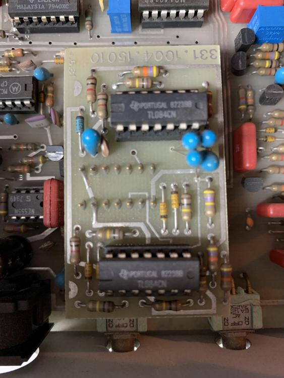

well, given my curisolity and the fact that I was once a "pinball wizard" I had to have a look inside this device.  Sure enough just as I thought there was a chance that something on the power supply was not quite right.  This volatge regulator was broken off the board. UA78M12HC F7911 - 12V bipolar 3 pin.   $14.00 on ebay :)  will do some voltage testing before I order it.  So about the "pnball wizard" - long story short is I was the lead technican for an amusment company for 10 years.  1980 - 1990.  It was an assistent directory at Columbia University that gave me the nickname of "JerseyMo".
Interesting. Do you have any better images of the boards that show the IC part numbers?
Is that device  heatsinked on the case next to the power board another regulator or a power transistor?
Any date codes on those chips?
Is it a mix of analog and digital or all analog?
What does that long steel roller at the front do?
no more pics, as I have put this back together and will listings it fr sale  "AS IS".
yes, that is another regulator and I'd say it was the 5v.
did not look for date codes.  all digital that roller is just part of the display assembly.
Was a fun porject and I was happy with the result and even more that I was able to remember the bascis of the electronics related to the power supply. :)

More pictures of inside.   I just now notice all of the ITT components. They had a huge facility on route 3 East, a few miles from where I now work.  The location has recenlty been converted to a shopping mall.
