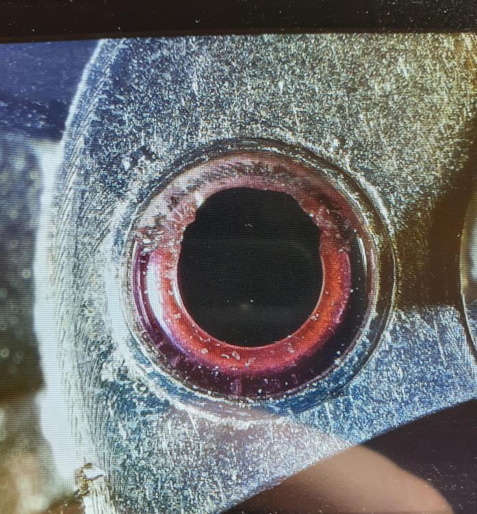

So i need to press in this jewel. I have pressed a few out of 2824 clone movements and it was super easy, i just took the measurements before and then placed them back on top.
Now i have to press this jewel into the Rolex clone movement i'm a little bit nervous, i can't get another one... So thought i'd ask a couple of questions here, if anyone would be kind enough to help me out?
1. As i can't take a measurement, is the only way to achieve the correct end shake placing the movement back together and keep taking it apart until the end shake feels right?
2. Does this jewel in the picture only go in one way (centre jewel)? I cant work out if one side is different to the other.

If you want to push a jewel 0.02mm you actually need to push it 0.01 extra.
does anybody know if the centre jewel has to be pressed in a certain way up?
thanks
The extra hundredth thing is a thing with pretty much every jeweling tool I've used, including Seitz, Favorite, Chatons SA, and Horia. I tend to use the lever types, but Horia screw types are similar. Think of the stack up of parts- the stump, the watch plate, the jewel, the pusher, the interface of pusher to spindle, then finally the micrometric screw. A micron or two of slop or mushiness here, another there, that it's typically only a hundredth is pretty fantastic.
As for orienting the jewel, if it's truly symmetric put it however you want. If there is an oil sink (however slight), that goes opposite the wheel.
