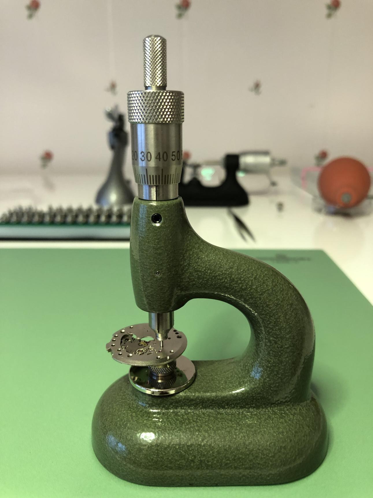

Anyway, the other day I needed to adjust the third wheel end-shake on a Unitas 6380 but I couldn't get any of my Seitz anvils to fit under the bridge or on the main plate. I felt extremely frustrated thinking about that I would likely have to order a Horia jeweling tool and then have to wait for a many days, weeks, or maybe even months.
Trying to come up with an alternative solution I placed the train wheel bridge on the large non-holed Seitz anvil but when I pressed the jewel the whole bridge gave way because it is quite thin. So, I decided to bite the bullet and order a Horia jeweling tool.
Getting the Horia press and the set with 24 pushers and 24 anvils from Cousins would be a quick option, but way too expensive, approx. £1910 with tax and UPS shipping. There was a pretty attractive offer on eBay for approx. £420 (Global shipping program) but it only had the set with 8 pushers and three anvils. Or, I could go AliExpress and get a Horia clone set having 24 pushers and 24 anvils for approx. £170 including shipping and VAT. None of these options felt particularly attractive.
In the process of trying to determine what to buy, it suddenly occurred to me that maybe the Seitz flat pushers could double as anvils!?!?! Note that I consider it a small miracle that the thought even occurred to me, Ha-ha!
It worked perfectly! I haven't fully examined all possible combinations of flat pushers and pump pushers, but at least the two largest flat pushers can double as anvils. Perhaps this is why the Seitz set has so few dedicated anvils!?
Anyway, I still decided to order the Chinese Horia clone having 24 pushers and 24 anvils. It will likely take a couple of months before it is delivered. It would seem most reviews are positive but I've also read I should expect a few of the pushers and anvils to be poorly done. Anyway, keeping my fingers crossed and until then I believe the Seitz flat pushers will cover most situations.

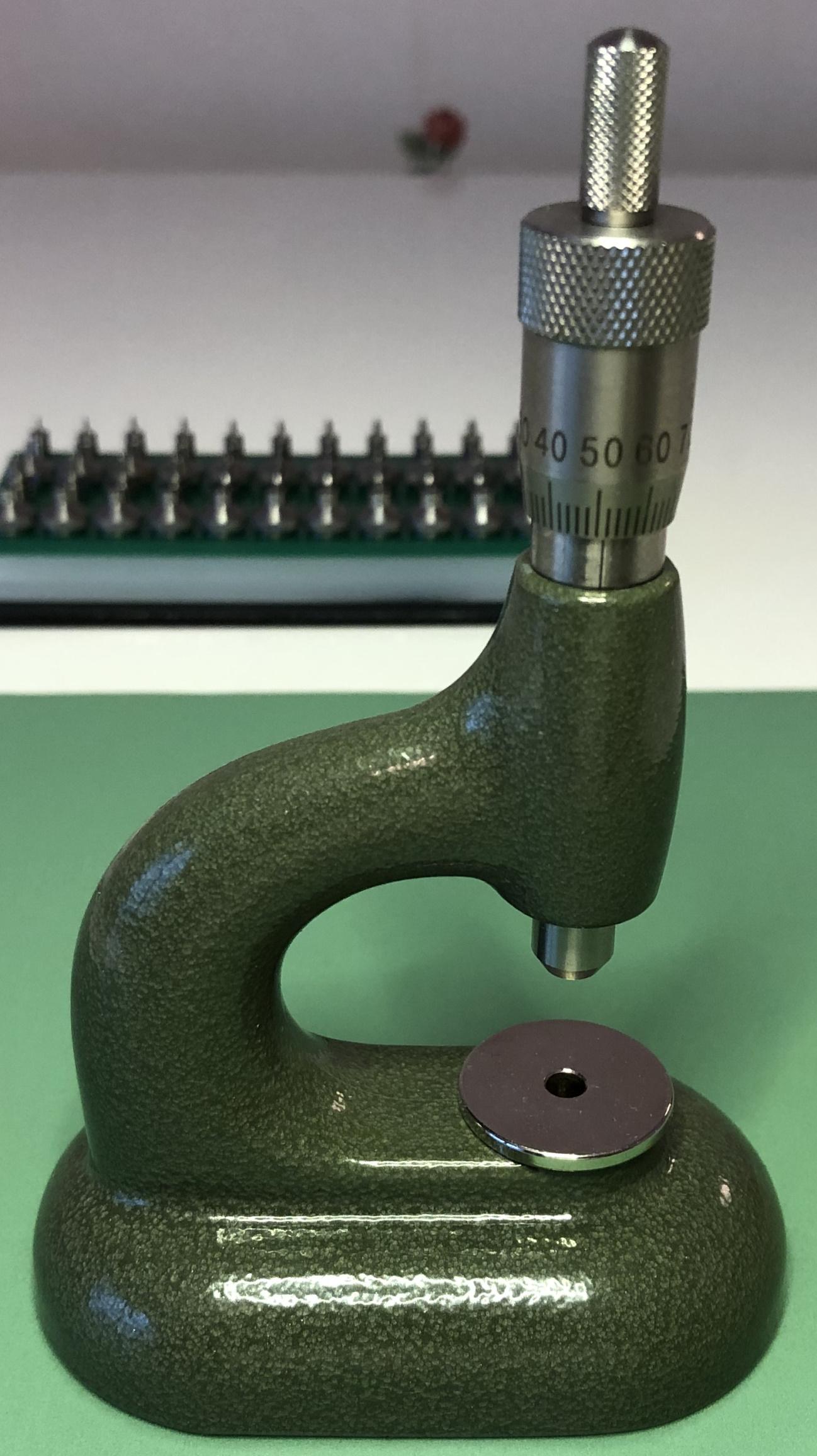

A couple of weeks ago, or so, I got my AliExpress Chinese Horia jeweling tool clone having 24 pushers and 24 anvils. So, it took approx. a month for the package to arrive. That's a lot less than I had expected. Another pleasant surprise was that it wasn't delivered from China but from the Netherlands (another EU state), so no additional fees had to be paid. Yippee! Anyway, it wasn't until today I had a chance to take a really close look and give it a try.
Here're some pictures... (Click to zoom in!)
Unlike the Seitz jeweling tool this tool does not have a "threaded cup" to catch the jewels pressed out all the way
Anvil bottom-side
Anvil top-side
Pump pusher
Pump pusher bottom-side (spring held in by screw having a slot)
Pump pusher bottom side (spring held in by a hexagonal screw)
Overall, I must say everything feels very well made and exceeded my expectations by a margin. Why some pump pushers uses a normal screw and some a hexagonal screw I have no idea, and I didn't try to remove any of them. The screws look like they could be made of plastic and they don't look all that nice. I don't know what the original Horia pump pushers look like, but the Seitz pump pushers are, is this respect, of a much better design.
I measured the diameter of five randomly selected pump pushers and they all had the given diameter minus approx. 5/100 mm, which of course is necessary to make them pass through the holes for the jewels in the plates and bridges.
I also measure the foot of a few randomly selected anvils and they all came in at 3.99 mm.
So, as an added bonus the anvils and the pump pushers fit perfectly (near zero shake) in my Seitz jeweling tool (and in the clone tool) as well.
Nevertheless, after having adjusted just a few jewels I already prefer this type of jeweling tool. With the Seitz tool you must always assert pressure on the handle, but since the Horia type uses a screw it frees up one hand and makes the operation feel both more precise and safe. The only drawback, of course, is that the Horia jeweling tool can't be used for reaming, so for that reason I'll be keeping my Seitz.
Using my caliper I also measured the distance between the anvil and the pump pusher, then rotated the screw 360 degrees (1.00 mm) and measured again. The difference between the first and second measurement was just a few hundreds of a millimetre (minus the added millimetre of course) and my caliper is naturally not as exact as my Bergeon micrometre. So, it would seem the Chinese got the threading on the screw just right as well!
Conclusively I must say that my very first AliExpress buy of a watch tool was a (somewhat unexpected) success and I wouldn't hesitate one bit to recommend this tool. The finish is not up there with the Swiss (Seitz and I would expect Horia), but it does what it's supposed to and it does it well. And, considering the price difference between the original tool and this clone, I'd say this is a no brainer, especially if you're a hobbyist.
Edited by VWatchie
