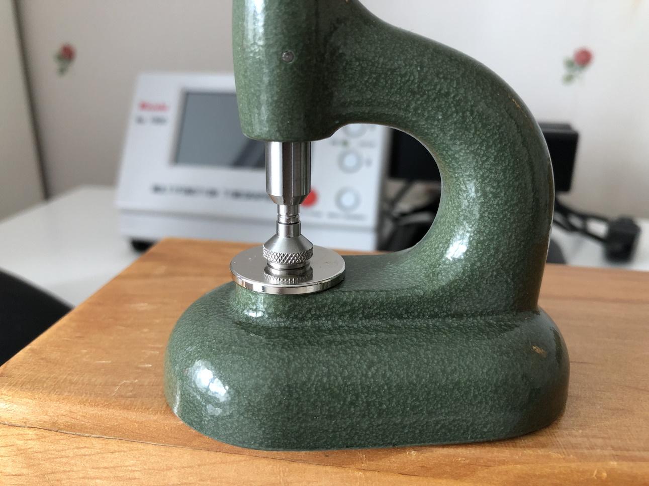

A shortcoming that I recently discovered with my AliExpress Chinese Horia jeweling tool clone is that three of the 24 pump pushers have a diameter that is about 0.01mm too wide. This is the kind of flaw I believe you can expect when you choose to buy Chinese pirated copies. In no way does it render the tool useless with these three pump pushers, but it is somewhat inconvenient.
21 of my pump pusher shafts have a diameter of about 3.98mm
Three of the pump pusher shafts have a diameter of about 3.99mm
The pump pushers that are 0.01mm too wide can not be easily pushed into the receiving hole in the upper part of the tool but get stuck a little before they reach the bottom of the tool hole. It feels as if the shaft of the pump pusher is completely inserted into the tool hole, but when you press the jewel, it does not move. Instead, it is the pump pusher that is pressed deeper into the tool hole.
Since I did not understand what was going on, it was driving me crazy the other day (having tried to adjust a jewel for the sixth time) and that's why I decided to find out what was going on. In my case, I found out that it is the pump pushers that have the diameters 130, 190, and 260 that have a too wide shaft.
Since it is only a minor shortcoming, it is still possible to push the pump pushers all the way into the tool hole, but it is not possible to do with just the fingers, you must push the pump pusher all the way towards one of the anvils. For this purpose, I choose the widest (300) anvil as can be seen in the above picture.
A disadvantage of this procedure is that it is also not possible to detach the pump pusher with only the fingers. Instead, you can use a pair of pliers with a piece of plastic in between and then swing the pump pusher back and forth sideways as you pull the pump pusher out of the tool hole. A piece of Rodico can be good to use to prevent the pump pusher from hitting the lower part of the tool.
Apart from this, I am still very happy with this tool and think that it’s totally worth the money.
I hope that the pictures together with my description were understandable. It felt important to share this information if you intend to buy the AliExpress version of this tool. Anyway, if you have the money, the original Horia tool surely have more precision.

Hiya vw I missed a horia on ebay a few months ago for £175 I was tempted but there where no pumps or pushers. Is hand pressure enough on the anvil to extract and install jewels without having a lever?
100 % yes! The Horia type without a lever is very easy and precise to use. The only potential problem is you might overshoot and press out the jewel, so you need to go easy on the screw. Little by little and a bit back and forth does it.

I also had a similar issue with the clone tool that some of the pushers were a little oversize. I should actually check and compare if it’s the same ones you had an issue with. That being said, I’ve already used it twice to replace jewels and it worked a charm. Someone should do a video on using this type (hint, hint @VWatchie), it took me a while to figure out exactly how to use it.

What are the chances of you reducing the diameters of these Watchie ?
if you have a watchmaker's lathe reducing shouldn't be a problem. I suppose if you're really careful with some sandpaper
Just ordered from AliExpress.  Been waiting for a good Swiss one to crop up on epay but they often have pushers, anvils missing and if not then really expensive. Sorted now though. Thanks Watchie and Gert for your info on this. 👍
Thanks john, i just wondered why Watchie hadn't tweeked them to fit better.
I checked al of the pushers on my Chinese set after reading the issue VWatchie had and there was no fit issues with any of them, so they do get it right so fingers crossed yours will be fine as well Neverenoughwatches
