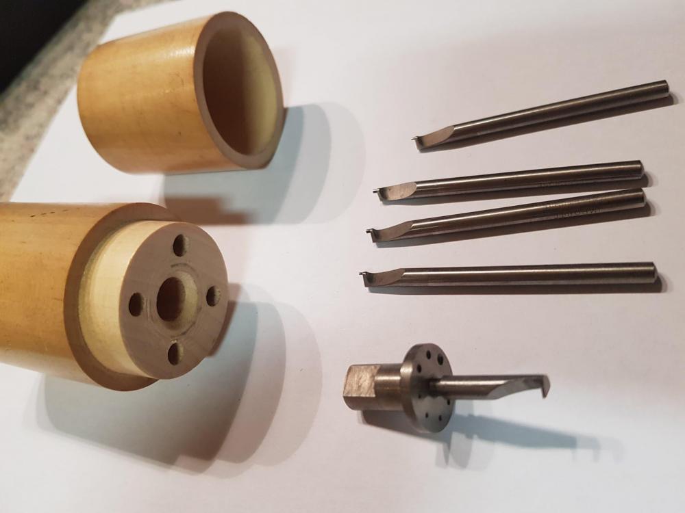

English is my second language, but i think  i understand that Tmuir:D  But i still have no idea how this is used in watchmaking. Plugs in/out of wich cylinder? Whats the curves in the stakes for?
I suppose a picture would help. Before the lever escapement there were other escapement's one of them that was very popular was the cylinder escapement. It is an interesting feature where if you break a pivot off it can be replaced.
Then a note regarding proper horological terminology? A lot of this will depend upon when and where you are. There are quite a few parts that will have multiple of names for the exact same part. This leads to irritation and confusion by the material house people when people insist on using names different than what they're used to. So for instance grabbing a copy of Britain's watch and clock makers handbook dictionary and guide refers to the things that go in the cylinder as plugs.
Continuing with my amusement on terminology I would agree with Tmuir that his terminology is correct because I've seen references to that. But grabbing a another reference that I would consider more reliable or at least better or perhaps is the book The Illustrated Professional Dictionary of Horology by G A Berner a rather interesting book because It has lots of horological terms and it's in three languages. So in its definition or talking about the cylinder it refers to the things on the end as plugs made of steel.

I'll go through my books and find a picture showing those tools in use
Hopefully these 3 pictures will explain the use to you on how they are used to remove and insatll the cylinder plugs show in John's post
This is from Archie B Perkins book Antique Watch Restoration Volume 1 which is just 1 of 4 great books from Archie if you have the money spare as they are not cheap.

Thank you for solving the mistery tool. That was splended. I wonder if i ever gonna use it, and it looks unused.  I presum the plugs must be maked in a lathe, if the tools are used?
in the past you to purchase the cylinders all assembled or the plugs and cylinder separate. As at one time this was a relatively common escapement. Occasionally though come up on eBay
Or if you type in the right search term you can find pictures I was looking for pictures of the components but I think you'll find these pictures useful
