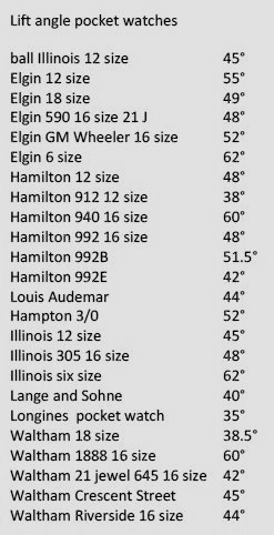

Then the amusing pocket watch listing?  Why is it amusing because  I've actually seen it quoted on the Internet wherever I last placed at somebody found it quoted it someplace else.. Then the other day at work they were apparently looking for lift angles for pocket watches and found the list and noticed it came from me my list.. But I find quite interesting that no one else is bothered to make a listing of their pocket watches..  So the early days where I worked my boss was much more obsessed with amplitude now I typically just don't worry about it if the numbers are the way to hire way too low I might just adjust the lift angles the numbers look more realistic but I don't worry about it typically unless they're extremely low then I may be more concerned than actually bothered to set the lift angle otherwise I typically just don't worry about it..
Lift Angle big list .pdf Lift Angles Watch gamma lift angle.pdf Lift Angles Watch Witschi Electronic AG.pdf Lift-Angles Wostep.pdf
