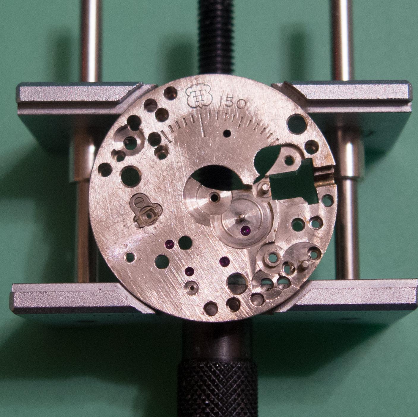

And - after stripping, I am happy to say that there was clean (fluid) oil where there was supposed to be - and almost no oil where there wasn't supposed be.
Having said that - it didn't look very good on the timegrapher before I started. So, will have to see what all I find as I clean and inspect things.
The cap jewel on the dial side has a divot in it. So, should be replaced. Not sure how easy it will be to ID and acquire, but rogart63 indicated that it's a very common movement and not a problem to get parts.
I haven't looked at the other hole and cap jewels (on the balance cock) - as I haven't gotten to cleaning that yet.
Here is the base plate cleaned up. It looks pretty good and all of the jewels on it look great.
Many thanks to all for their comments and contributions.
