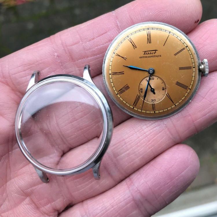

How to get to the movement on this Tissot?
By nickelsilver · Posted
